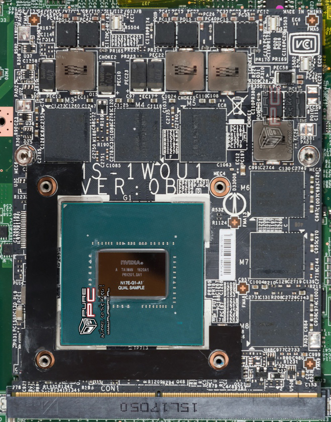

MSI 1060:
  Hide contents
No SLI connector? Well, isn't that special. If we've got to settle for single GPU, they need a 1080 on the same PCB for it to be an attractive option. 1060 is fine for a little gamer-boy laptop with a compromised cooling system, but that's not good enough for something substantial like an upgrader looking to take his almost new Batman or Phoenix system to the next level. Seems like they are trying extra hard to block upgrades and force new system sales. That really blows.
MSI in recent days only uses SLI connector on systems also designed for SLI. The card above is used in the non-SLI systems.
I don't know if they offer 1060 in any of their SLI systems...some of our MSI brothers here should know better than me.
imageproxy.php?img=http%3A%2F%2Fuploads.tapatalk-cdn.com%2F20160817%2F2ca38d3155ec27ee824d26c92135842b.jpg&key=ebd895ee40c860c6ddda40e565b7300b9cee11252e555c7e10effa351bbb72c9
I don't know it is a vapor chamber, just praying it is. But they went to a spring bar and straight screws with more heat poor coverage, it seems...

It's funny how clevo ships the 1080 (with GDDR5x) with the stronger memory controller phase layout (160 amps lol) over the 1070 which has (the more power hungry) GDDR5.
That's not memory. Those are 2 core phases. The core on the 1080 Clevo cards is 4+2. I don't get why the 2 phases have a cut down FET count on the 1070 while the 4 are unchanged. Seems like the thing to do would be to cut both, or cut neither.
The memory is the two phases with the 2 smaller .24mH inductors.
I need to get my hands on one and have a good look.
