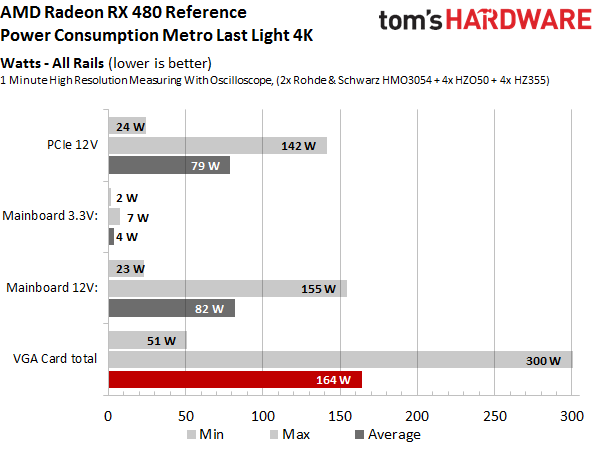

AMD's new RX 480 $200 graphics card is out and delivers GTX 970/R390 performance as promised. However, there are some conflicting reports of the new Polaris GPU drawing more power from the PCI-e slot than it is rated. According to Tom's Hardware, the RX 480 draws 86 watts peak from the motherboard's PCI-e slot although the official ceiling is 75 watts.
Quote
AMD’s Radeon RX 480 draws an average of 164W, which exceeds the company's target TDP. And it gets worse. The load distribution works out in a way that has the card draw 86W through the motherboard’s PCIe slot. Not only does this exceed the 75W ceiling we typically associate with a 16-lane slot, but that 75W limit covers several rails combined and not just this one interface.

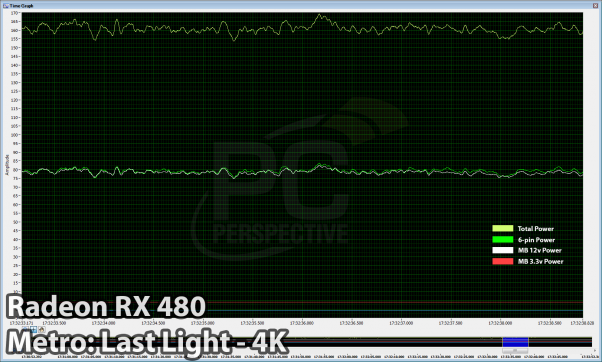

After Tom's Hardware published their report, other websites such as PCPer followed up with their own testing and reported similar findings:
Quote
The results are compelling: at stock settings the RX 480 is 160+ watts on average and spikes to 170 watts several times.
View Full Size
Metro: Last Light (4K) power draw, RX 480, Click to Enlarge
Taking a closer look reveals that the motherboard PCI Express connection is supplying 80-84 watts of power over the +12V rail continuously, while the +3.3V rail hovers just below 5 watts. This is definitely a concern for the RX 480 design, but to what degree?
