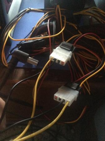

[GUIDE] Making a molex-to-barrel adapter
Enano replied to jacobsson's topic in Enclosures and Adapters
Not really. Will work perfectly, but having 2 grounds and 2 12v is a better idea to avoid low power output from the PSU. -
@andhie133128 The card might consume 60, but you need 25 for the PCIe, Also, using 2 power supplies tend to cause interference. You should try moding a cable. There is a really useful thread on how to do an adapter to use the PSU you mentioned. Btw, don't get desperate, there are a lot of drivers that you can actually try. I had to try at least 8 or so, if I recall correctly, before one fixed the issue. Try monitoring with the after burner all the parameters and you might know exactly what the issue is. Just run the kombustor until it crashes. (Voltage load, CPU usage, CPU temp, GPU usage, GPU temp, etc...) Finally, if you have a friend with a desktop, try it there or do a small testing partition to test drive the little fellow as a last resource without wiping your system (which I did after the first 3 drivers attempts ). If the GPU is faulty, don't worry, Zotac has a good customer support service. Sorry for late response, but just got out of work. Hope that any of this helped.

@p3nzancef1ier Sorry for taking ages for me to answer, been really occupied lately. Yeah, that will work, a lop of laptop power supplies are over 200w and most gpus + pcie expansions use just about that. All you need to do is cut it and solder the adapters correctly for it to properly work. I used my desktop PSU since i simply made my eGPU project as a hobby luxury, but the one you mentioned is the most used one in the forum as far as I can tell. The moding is pretty simple to be honest, and if I'm not mistaken, the plug it comes with, perfectly fits the akitio box. @davidexD where you able to find a proper solution? If the issue continues, can you specify your rig? It might be a bottle neck issue (really doubt it since the issue started a while ago for you). Also, did you tested more drivers? for GTX 960 353.06 drivers proved to be the more eGPU stable ones. for your 750, I think it should be the ones released a few days after those. If you need help when it arrives, I will gladly assist you with any doubt you have. Although, I'd prefer for this thread to be as clean as possible. So if try mentioning me in a more adequate thread or create a new one if you find an issue that haven't been mentioned yet. The community is full of raw gems
