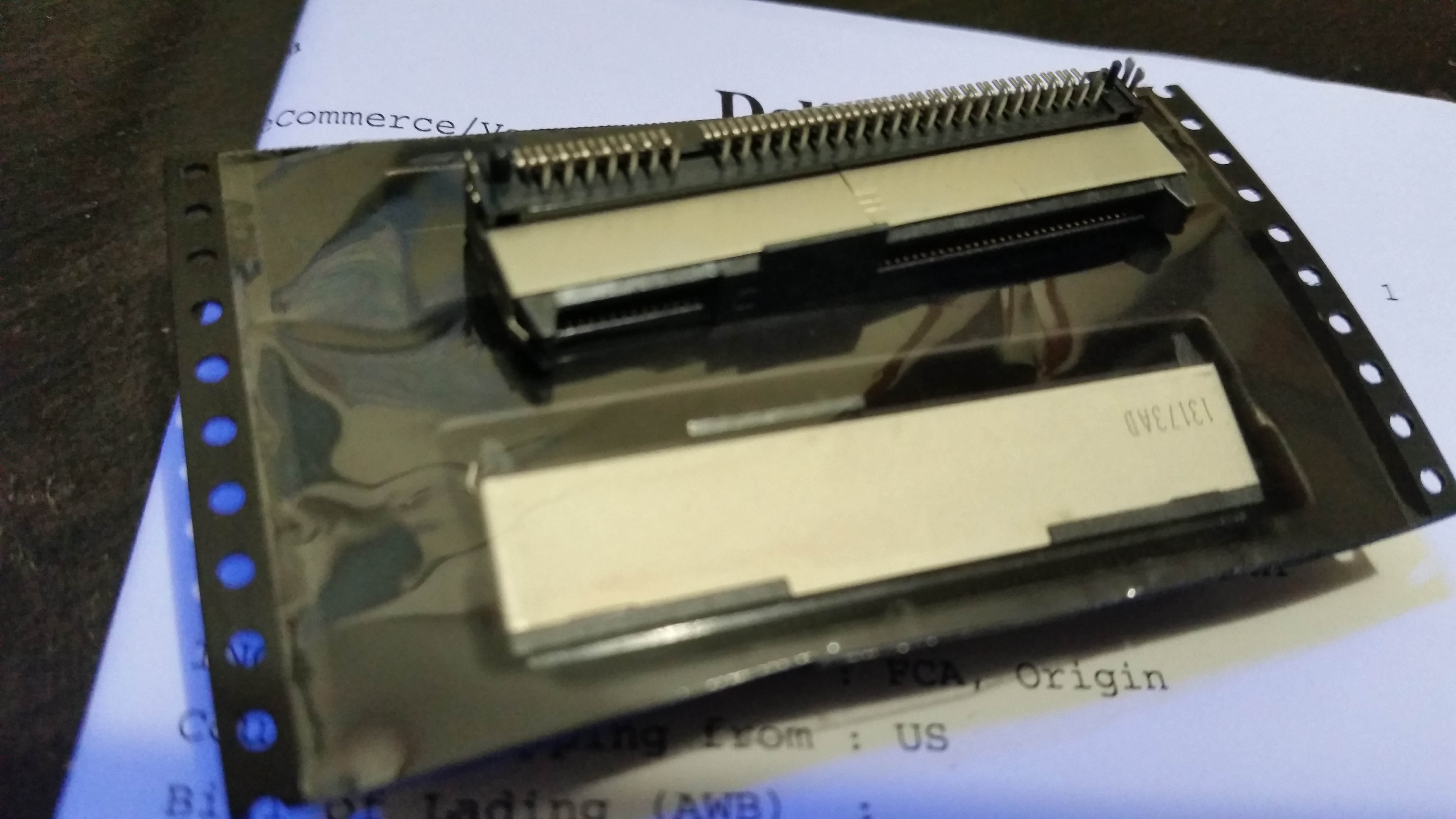

I have two of this connectors. All New and unsoldered.
Easily got them here: https://www.arrow.com/en/products/2199015-1/te-connectivity Nice and fast shipping.
Bought them with the idea of making one of this adapters for my y510p. Asked Gerald for some advice via pm but he never answered back.
Was wondering if there's a way to solder it to a cable like this : https://www.ebay.com/itm/EZDIY-FAB-PCI-Express-PCIe3-0-16x-Flexible-Cable-Card-Extension-Port-Adapter/223213791263?epid=4012486079&hash=item33f894281f:g:8AIAAOSwhZ5b24k9:rk:30:pf:0&LH_ItemCondition=3&LH_BIN=1
Edited by feisar
incorrect link/device
Please correct me if I'm wrong, but I think these connectors are for the wrong side (this would be the same as the one on the motherboard, not the one on the ultrabay device).
Oh sorry, I meant the 2199015-1. Link fixed :)

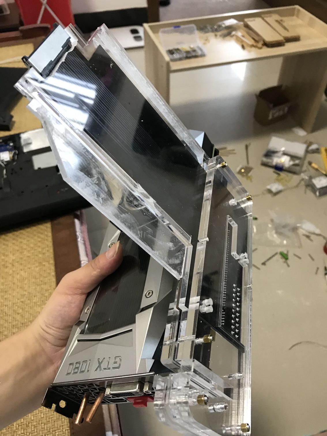

Haha I’m actually using ADT cables for my wire-daughterboard solution.(using 2 PCIe x4 cables) ADT guys are friendly and supports me doing this.

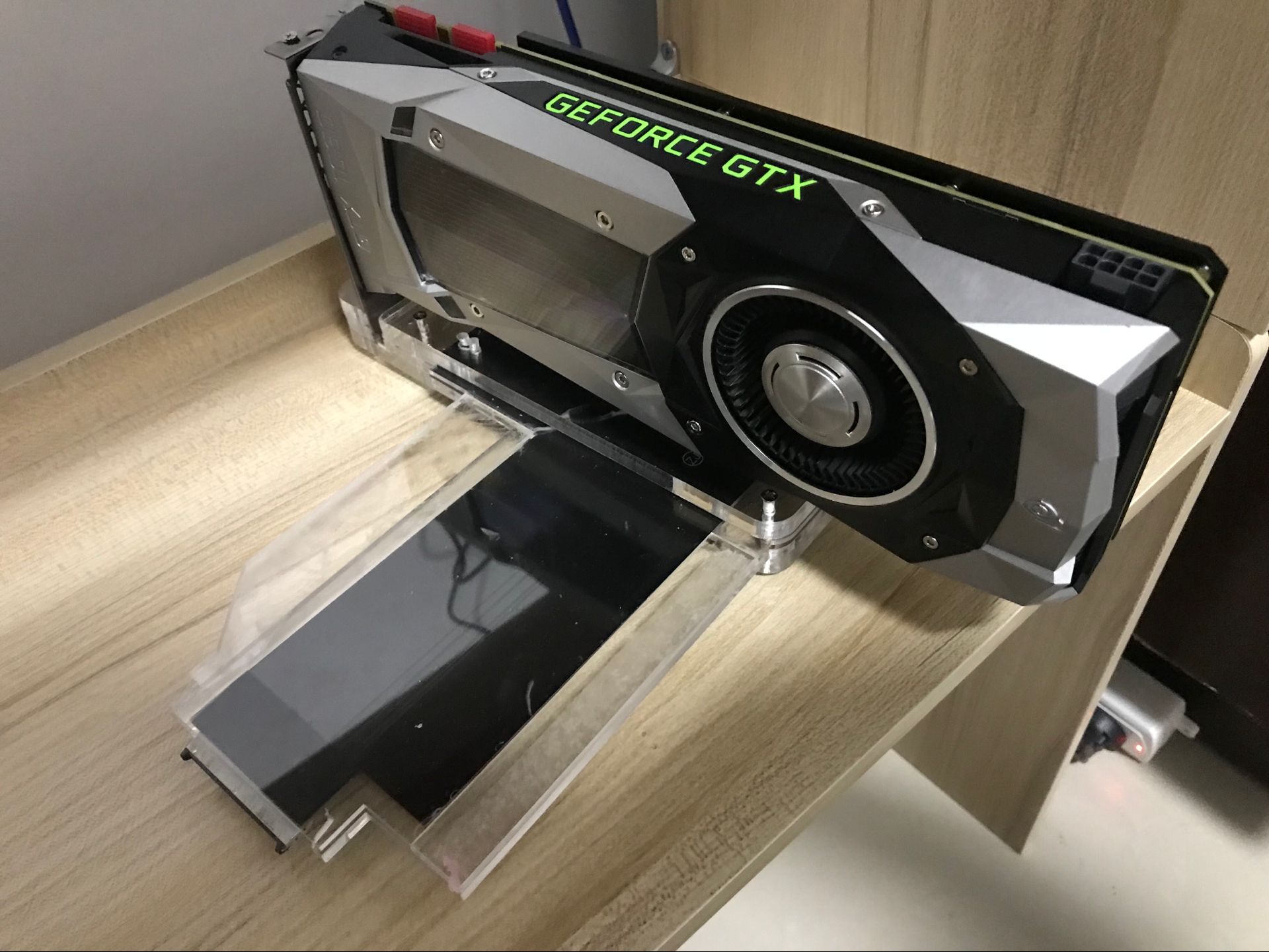

On 10/26/2018 at 4:41 PM, Swung Huang said:
Some recent updates.
That is absolutely beautiful sir. Would you mind sharing the dimensions of the acrylic?
Edited by Tesla
Yes, that does look beautiful! I certainly do not have the tools to make such a thing myself, but perhaps I could find someone who could make one for me.
