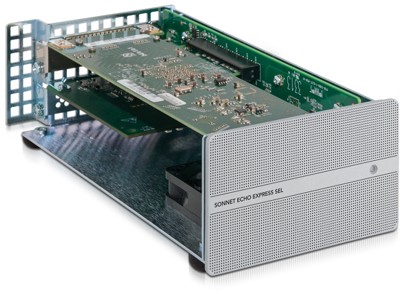

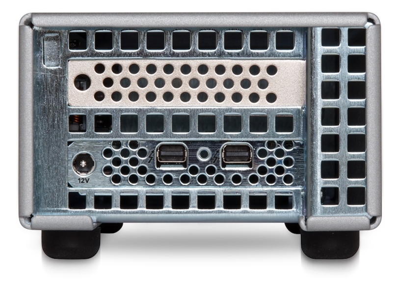

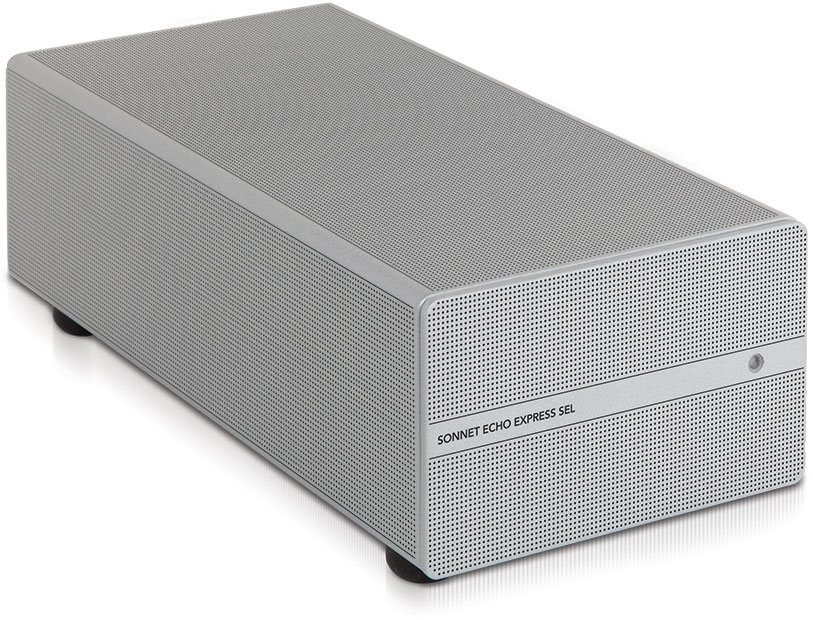

Tech Inferno Fan Posted April 28, 2014 Share Posted April 28, 2014 Click >>> Summary of Thunderbolt eGPU implementations including Sonnet Echo Express SEL ones <<< NOTE: this product has two limitations preventing direct eGPU use. (1) it has a x8 pcie slot (2) there is 60W, rather than 75W per PCIe 1.1's 75W slot power limitation in this product. Both those limits can be be overcome by using it without enclosure via a powered x8-to-x16 PCIe riser.http://forum.techinferno.com/enclosu...6gbps-tb2.html doesn't have the first limitation AND costs less so is recommended over the Sonnet SEL for eGPU use. Sonnet Echo Express SEL Price? (inc Thunderbolt cable): US$314 bhphotovideo-US Quote Form Factor: Desktop External Connectors: 2 x Thunderbolt, Power Expansion Slot: One x8 mechanical (x4 electrical) PCIe 2.0 Supported PCIe Cards: 1 x low-profile PCIe card (sold separately) Power Supply: Universal 60W, 100 to 240 VAC, 50 to 60 Hz Operating Temperature: 32 to 95°F (0 to 35°C) Compatibility: - Mac with a Thunderbolt 2 or Thunderbolt port, OS X 10.8.5+ - Any PC with a Thunderbolt 2 or Thunderbolt port Windows 8, 7 (Windows requires a Thunderbolt 2 interface in the computer and in the expansion chassis to support more than 2 PCIe controllers.) Dimensions: (W x H x D) 4.00 x 2.82 x 8.42" (10.16 x 7.16 x 21.39 cm) Weight: 1.7 lb (3.4 kg) In the box: 60W power Adapter, Power Cord, Thunderbolt Cable, Limited 1-Year Warranty 1 Quote Link to comment Share on other sites More sharing options...
