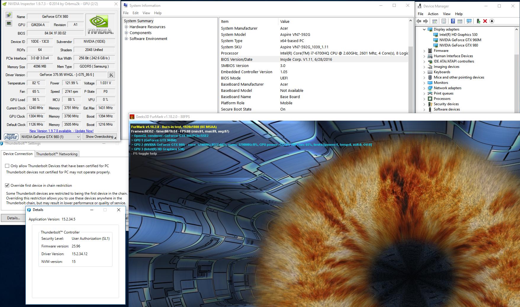

Acer Nitro V17 Nitro Black HQ + AKiTiO Node TB3
Slovedon replied to Andromedus's topic in DIY e-GPU Projects
Success! My Akitio Thunder2 + 980 setup is working fine (so far) with the 592G's Thunderbolt 3 connection and Akitio T3T adapter. Now I'm just waiting on Akitio to release the Node for full Thunderbolt 3 speeds Windows 10 will get confused with the 960M/980 combo and install the notebook and desktop Nvidia drivers repeatedly, so you have to disable device driver updates. The 980 showed in device manager after installing all the Acer driver & firmware updates from their website (most importantly the TB3 firmware) which let me install the desktop Nvidia drivers. After reboot, device manager gave a "OS could not find enough resources" error for the 980 (not uncommon when setting up eGPUs) but disabling, reenabling, and another reboot fixed it. Now the 960M and 980 are working perfectly for 10+ reboots, with and without eGPU connected. The eGPU compatibility section isn't showing for me, but like @bloodhawk said, that "no" is meaningless anyways -
