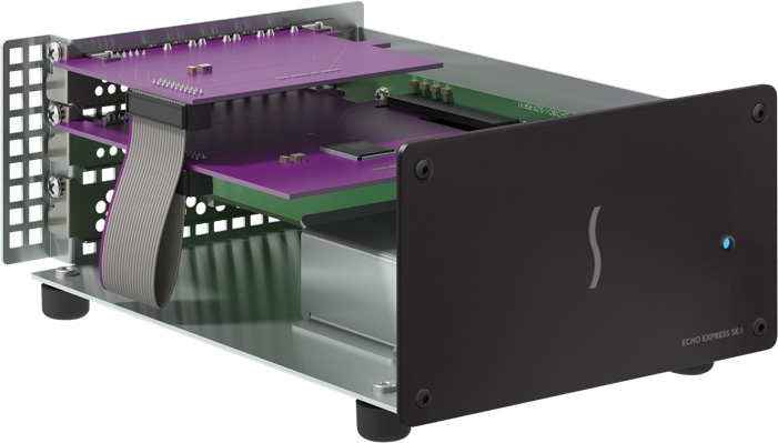

  2. For those following Sonnet's offerings, they recently refreshed their range of TB2 products as well as their prices. The new Sonnet Echo Express SEL has a new MSRP of $329 (previous $399) and a new black color scheme. They've also introduced a new model that sits in between the SEL and the SE II: the Echo Express SE I for MSRP $349. This has also lead to a great decrease in the price of the older SEL to $269 at BH. The new and old SEL seem to have identical specs other than color, so this is a great deal. I'm personally interested in the SE I because it can accept full height, double-width cards. Unfortunately, the mechanical PCIe connector is still stuck at 8x, requiring a riser or some filing away of the plastic end. AC adapter is rated at 80W, which is too low for any card other than the GTX 750Ti (or its successor) without an external PSU. Still, I think that this enclosure is ideal for a compact solution, ignoring the Akitio Thunder2.

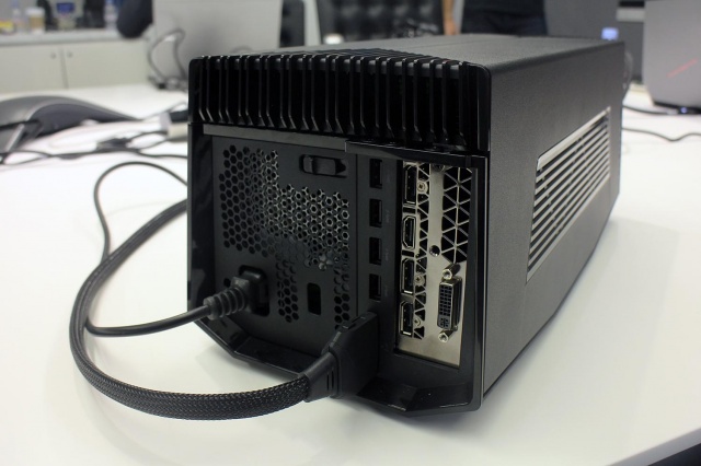

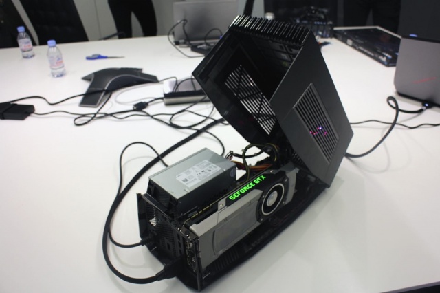

  10. Hi all, This guy has started popping up around tech sites, and I thought it's interesting that another mainstream manufacturer has released an eGPU solution! This box is a compact solution that includes the PSU and enough space for any graphics card. Build quality seems average, but good enough compared to the frankenbuilds we've been making. Now I know that it uses a proprietary connector like the Vaio Z, but it appears to be some kind of PCIe connection. I'm curious as to whether this is Thunderbolt with a different connector, like they did with the Z. If so, could it be modified to fit a standard Thunderbolt cable? Another possibility is that it's on the market because Dell did not go have to seek Intel's approval because this is not Thunderbolt at all. Who knows, one may hope. Here's some pics and a link to one of many articles out there for those interested. http://www.anandtech.com/show/8653/alienware-graphics-amplifier (added AnandTech link) Hands on: Alienware graphics amplifier | Digital Trends
