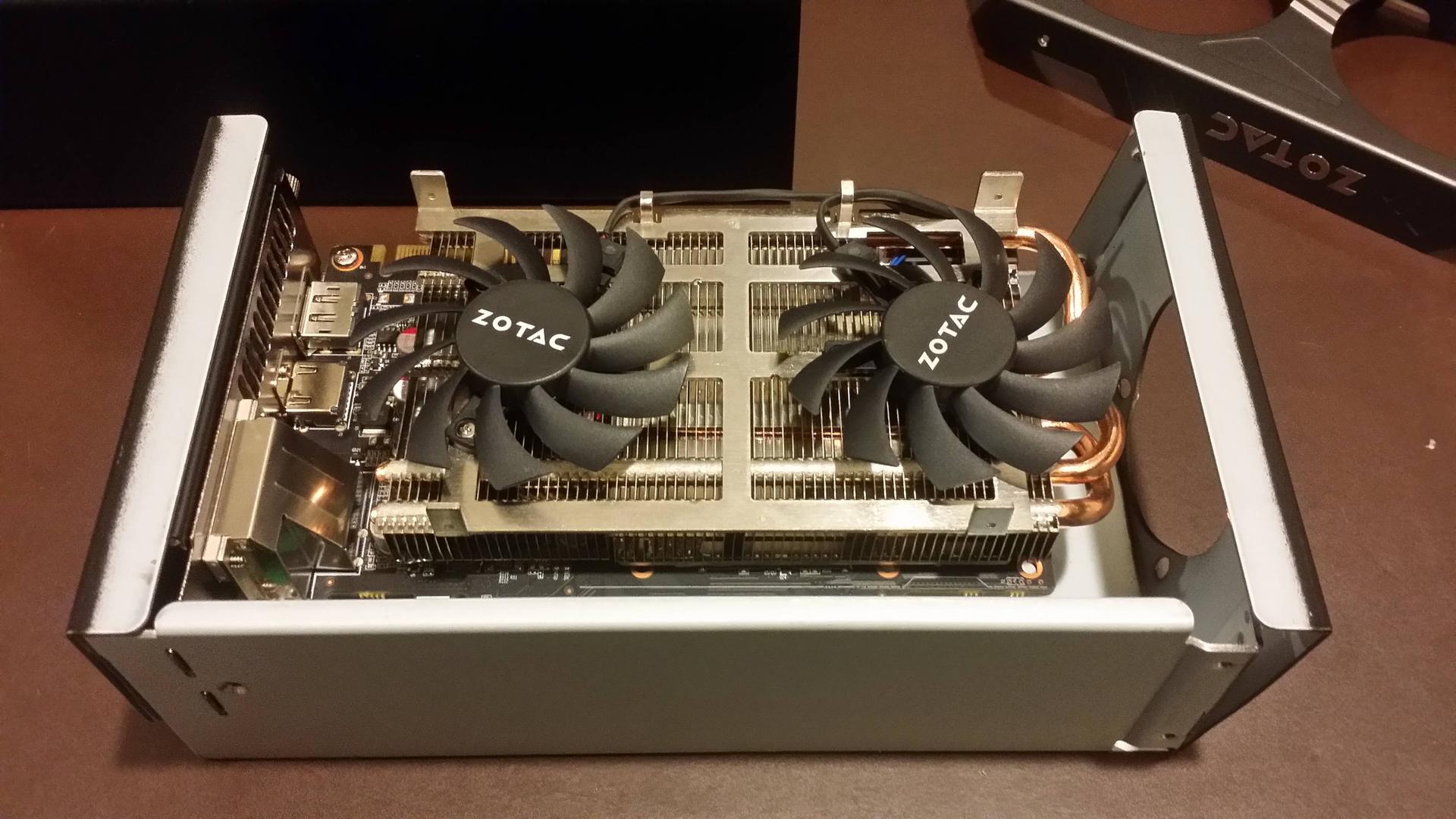

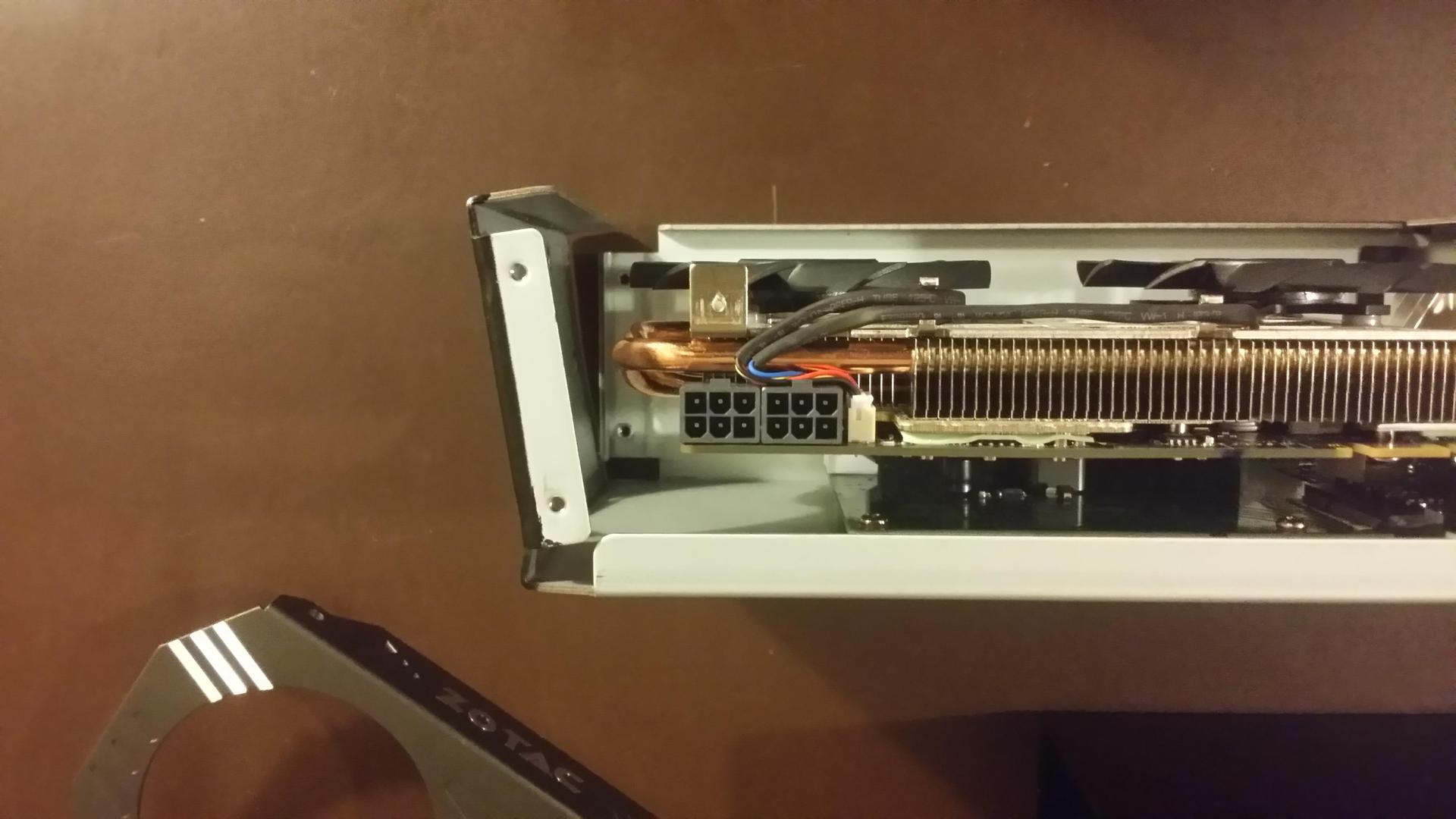

@Tech Inferno Fan @jacobsson Indeed it does! The shroud slides off easily after removing those 4 screws. You can see how the Akitio had to be bent slightly outward to accomodate the card with the shroud on, but it would have clearly fit comfortably without any alterations. -

They can also be fixed by not using the outer enclosure altogether That's my plan at least. I'll just use the outer enclosure for protecting the GPU while transporting it, since it slides in very easily, even with the slightly bent back plate to accommodate GPU length. - - - Updated - - - @jacobsson That's disappointing to hear. I'll be able to test and compare on my setup soon though. The TB mobo should be here in a week -
