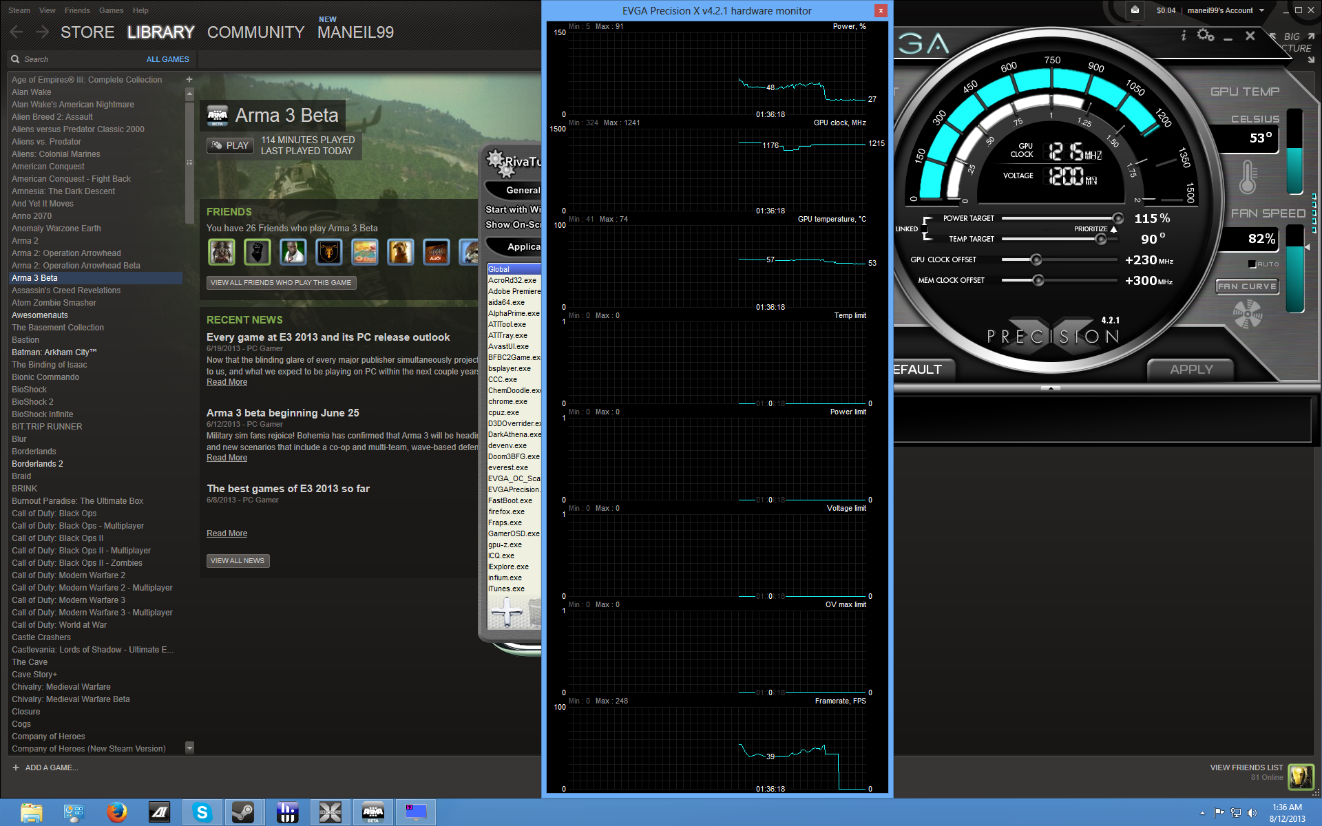

maneil99 10 Posted August 12, 2013 Multiple times while playing Arma 3 I saw my GPU clock go up and down, now the server does have a ingame graphics changer but I am not sure if that accounts for this Why does it do this? I thought GPU boost 2.0 is disabled. Should be noted it uses alot less power and most likely usage from the GPU as its CPU reliant. Edit shit wrong thread. This is a 780 ACX SC using the proper 3A bios. Will leave here because i am on my phone Quote Share this post Link to post Share on other sites
maneil99 10 Posted August 12, 2013 My card for some reason occasionally scales back its gpu clock in arma 3. Also at these times the power draw is pretty low. Game is very cpu intesive. Any reason why this is happening? Quote Share this post Link to post Share on other sites

svl7 5640 Posted August 12, 2013 Any chance for a classy bios with a higher power limit?I think Svl7 mentioned the classy vbios mod has 440w? at default settings. If you go back a few pages he talks about why he left it at 130%.Yes, the default value of the mod is already high enough (440W), meaning you most likely won't need to adjust it manually unless you really crank up the volts.- - - Updated - - -Multiple times while playing Arma 3 I saw my GPU clock go up and down, now the server does have a ingame graphics changer but I am not sure if that accounts for this [ATTACH=CONFIG]8673[/ATTACH] Why does it do this? I thought GPU boost 2.0 is disabled. Should be noted it uses alot less power and most likely usage from the GPU as its CPU reliant. I've seen that before in some log files, can't really explain it. From what I have seen it only happens when the GPU usage is relatively low, so it's not really a performance decrease. Never seen it in benchmarks... I think that's really purely driver related. Quote Share this post Link to post Share on other sites
