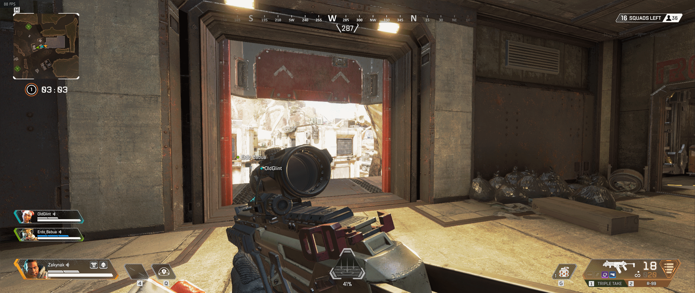

Great news, my version 3 is working stable :) Now I want to do same case for it.
I finished yesterday in the night so I only tested Apex legends for 1 hour. See screenshot. (80-90 FPS stable) Ultra settings (2560x1080).
GPU: RX 580 8GB NITRO+
