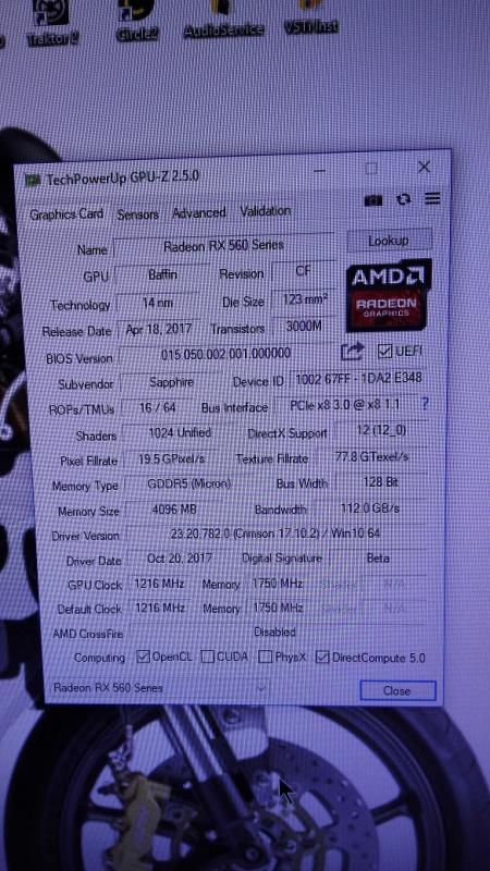

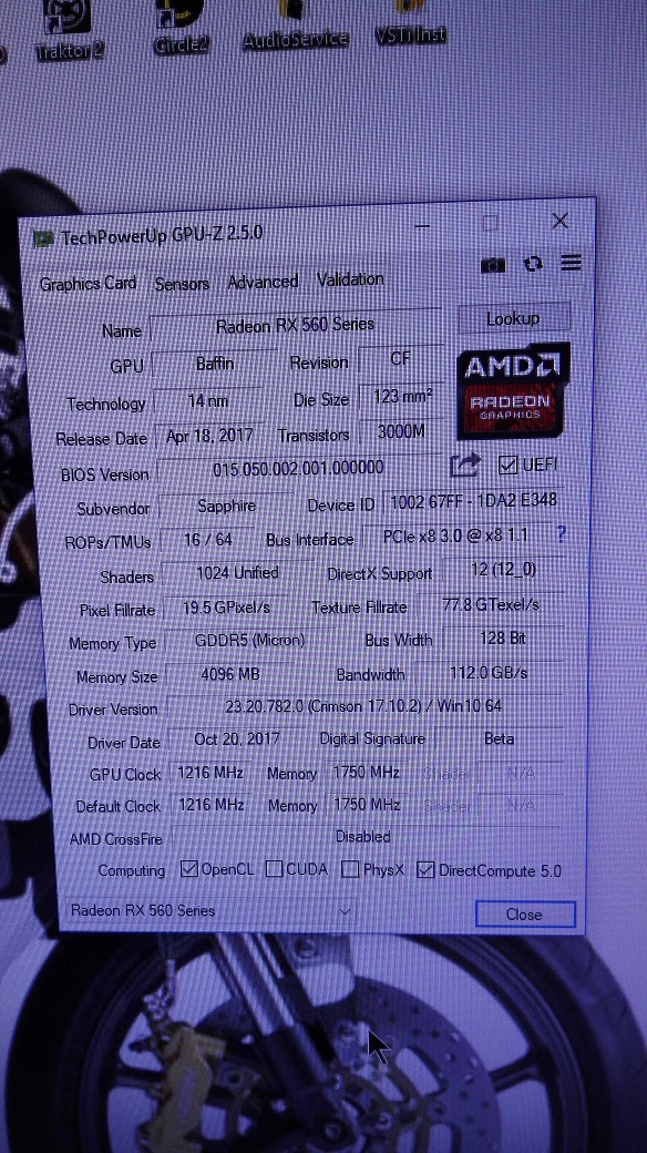

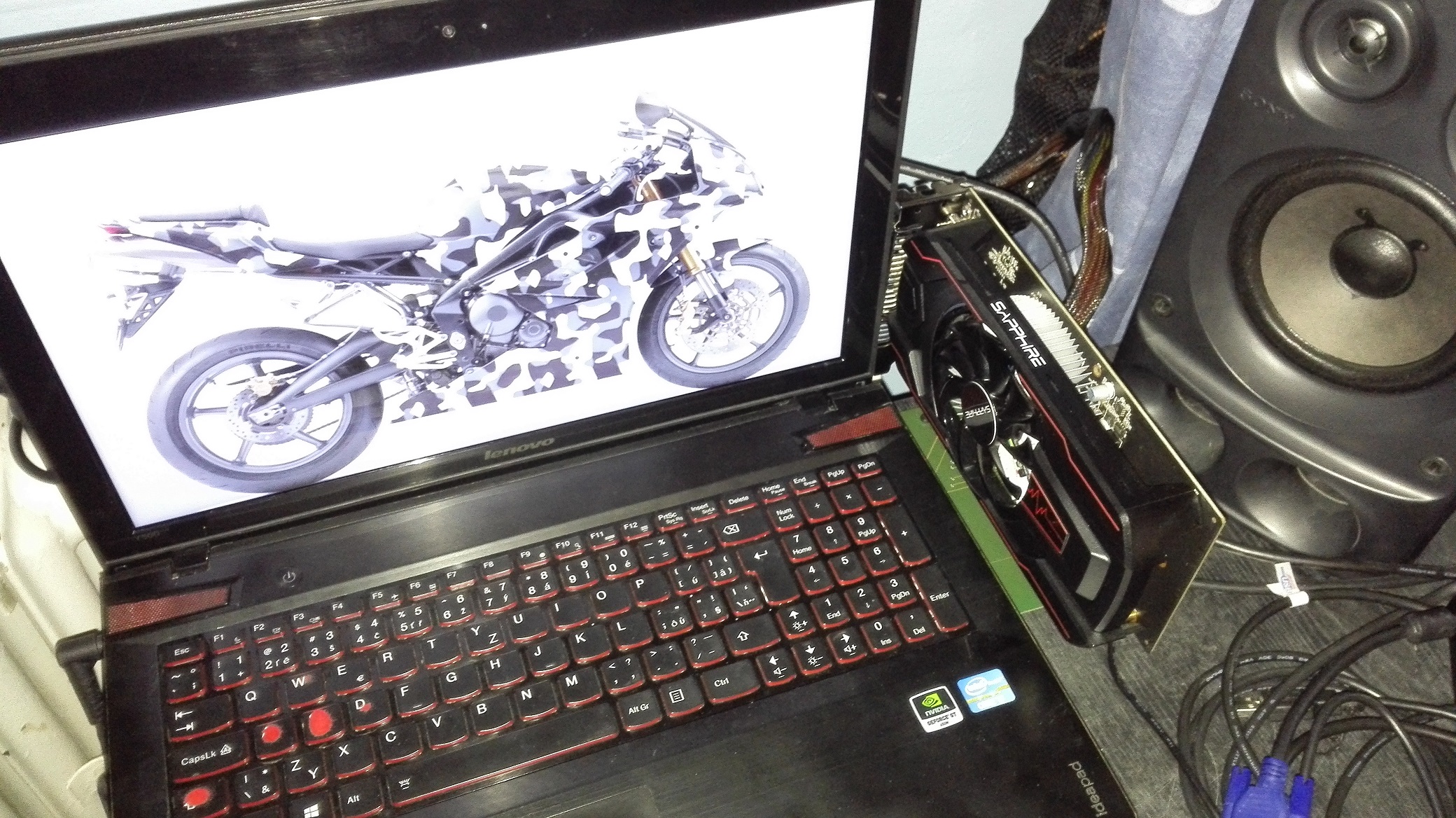

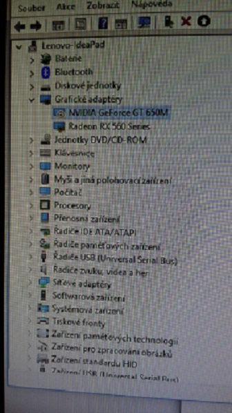

Kuneroll Posted April 18, 2018 Share Posted April 18, 2018 (edited) So, I flashed bios from this topic and try gpu for the first time. Y500, Rx 560 4GB(without self power. Pasive) I did setup nothing. I use 2 ext monitor and int monitor on latop. Later I´ll try some games. I´m going to try nvidia gpu. I´ll post result. If I disconnect or connect GT650M, it´s look like same. Only in notification are i see Nvidia icon. Edited April 18, 2018 by Kuneroll 1 Quote Link to comment Share on other sites More sharing options...

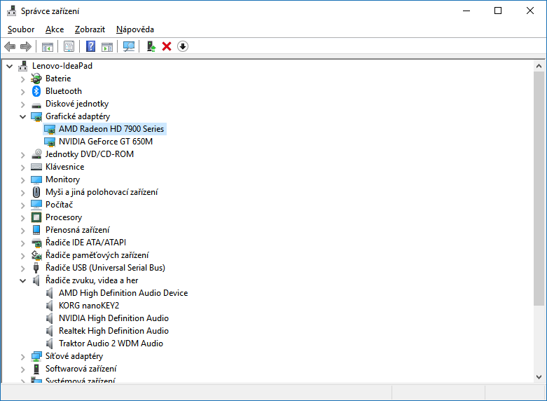

Kuneroll Posted April 18, 2018 Share Posted April 18, 2018 (edited) With Nvidia HD 7950 is functioless. In device manager i don´t see any other GPU then GT650M Edited April 18, 2018 by Kuneroll Quote Link to comment Share on other sites More sharing options...
Kuneroll Posted April 18, 2018 Share Posted April 18, 2018 With Nvidisa HD 7950 is funcionless Quote Link to comment Share on other sites More sharing options...
Bos Maior Posted April 18, 2018 Share Posted April 18, 2018 1 hour ago, Kuneroll said: With Nvidisa HD 7950 is funcionless Hey Kuneroll, Do you mean the AMD card does work, and the NVIDIA cards don't? Quote Link to comment Share on other sites More sharing options...
Kuneroll Posted April 18, 2018 Share Posted April 18, 2018 2 hours ago, Bos Maior said: Hey Kuneroll, Do you mean the AMD card does work, and the NVIDIA cards don't? Right. Device manager doesn't see nvidia Quote Link to comment Share on other sites More sharing options...
High_Voltage Posted April 18, 2018 Share Posted April 18, 2018 Very cool! Another successful result with the y500 version of the mod! Regarding the non-working Nvidia, can you check the model of the card? The HD7950 is an AMD GPU, not Nvidia. Also, did you make sure that separate power (6pin/8pin connectors) is supplied to the card before testing? I personally don't see any reason for Nvidia not to work, as @Swung Huang has previously reported GTX 1070 working on Y400. Therefore whatever model your card is, the problem is most likely the card itself, not the BIOS mod or the adapter. Quote Link to comment Share on other sites More sharing options...
Swung Huang Posted April 18, 2018 Share Posted April 18, 2018 9 hours ago, Kuneroll said: With Nvidia HD 7950 is functioless. In device manager i don´t see any other GPU then GT650M Do you mean your eGPU doesn't show up in the device manager? It seems like a incorrect connection. not bios problems. Quote Link to comment Share on other sites More sharing options...
Kuneroll Posted April 18, 2018 Share Posted April 18, 2018 (edited) 1 hour ago, High_Voltage said: Regarding the non-working Nvidia, can you check the model of the card? The HD7950 is an AMD GPU, not Nvidia. Also, did you make sure that separate power (6pin/8pin connectors) is supplied to the card before testing? Sorry HD7950 is AMD. Yes I used separate power, it has 2x 6pin. Fans are spin. Edited April 18, 2018 by Kuneroll Quote Link to comment Share on other sites More sharing options...

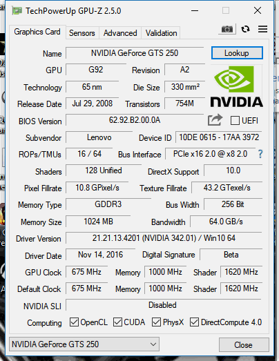

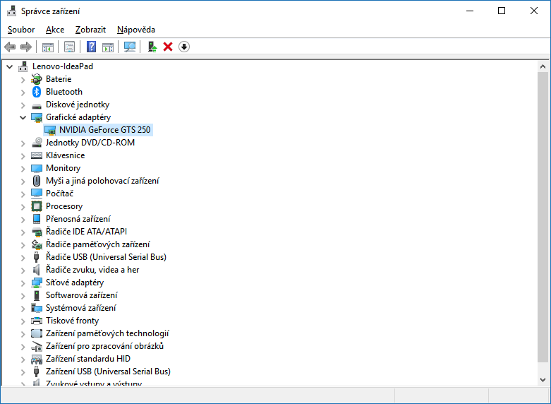

Kuneroll Posted April 18, 2018 Share Posted April 18, 2018 (edited) Y500 It works with other Nvidia. GTS250 1GB. 2x ext display also int laptop display Edited April 18, 2018 by Kuneroll Quote Link to comment Share on other sites More sharing options...

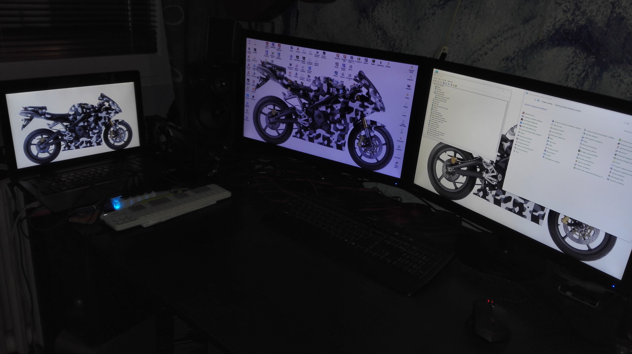

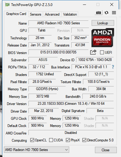

Kuneroll Posted April 18, 2018 Share Posted April 18, 2018 (edited) So, Hd7950 also works fine on all three displays, 2x ext and int laptop. Edited April 18, 2018 by Kuneroll Quote Link to comment Share on other sites More sharing options...

High_Voltage Posted April 18, 2018 Share Posted April 18, 2018 What was the problem with HD7950 then? Quote Link to comment Share on other sites More sharing options...
Kuneroll Posted April 18, 2018 Share Posted April 18, 2018 30 minutes ago, High_Voltage said: What was the problem with HD7950 then? I don't know. It is giant gpu,maybe was bad connect. Quote Link to comment Share on other sites More sharing options...
Swung Huang Posted April 18, 2018 Share Posted April 18, 2018 14 minutes ago, Kuneroll said: I don't know. It is giant gpu,maybe was bad connect. It could be. Sometimes I experienced the fan spinning while the graphics card is not actually showing up. It's probably caused by a poor contact and can be easily fixed by reconnecting or sth like that. Quote Link to comment Share on other sites More sharing options...
