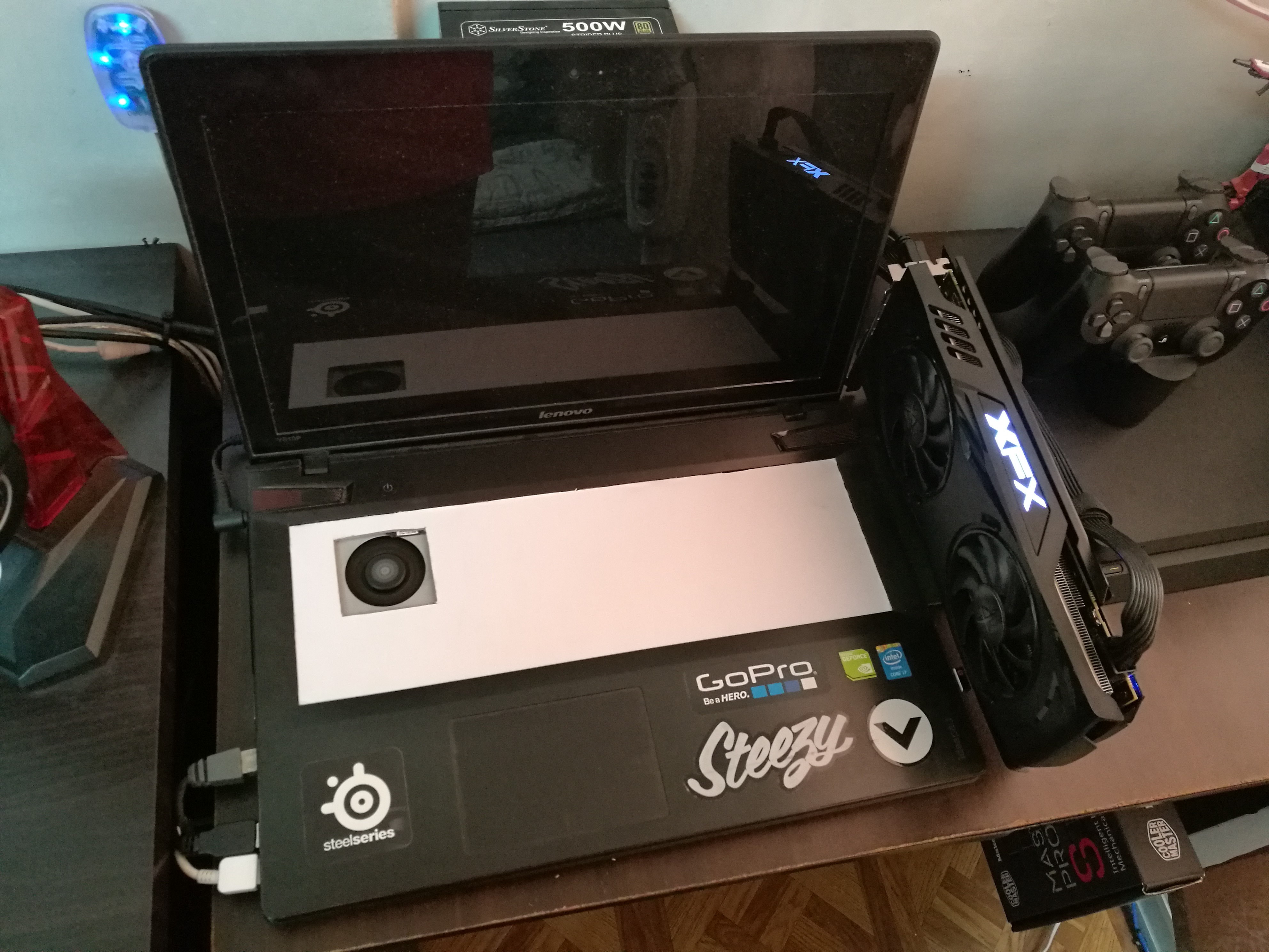

@Tesla I got an idea to cover up the rest of the area where the keyboard was before but leave the fan slot open for the laptop to breathe. I took an illustration board and traced the keyboard on it and cut out a small box on where the fan is at. At least now it won't get super dusty but the fan can still breathe properly. :D Here is a shot of what it looks like now.
That is quite genius. funny thing I have many of these boards but the idea never crossed my mind.
It looks much cleaner, and you know what, I might just go crazy and CNC a custom cover in that case lol. :D
I mean, technically you could just 3D print an entirely new cover and all. CNC would be expensive and the ease of just shorting the board would be kind of a waste. I just got a Y510P off eBay for 250 USD.

I know a guy who has a big CNC so its cheaper for me and sometimes almost free D: and btw I usually use plastic acrylic sheets which does not only look good but also act as an insulator.
