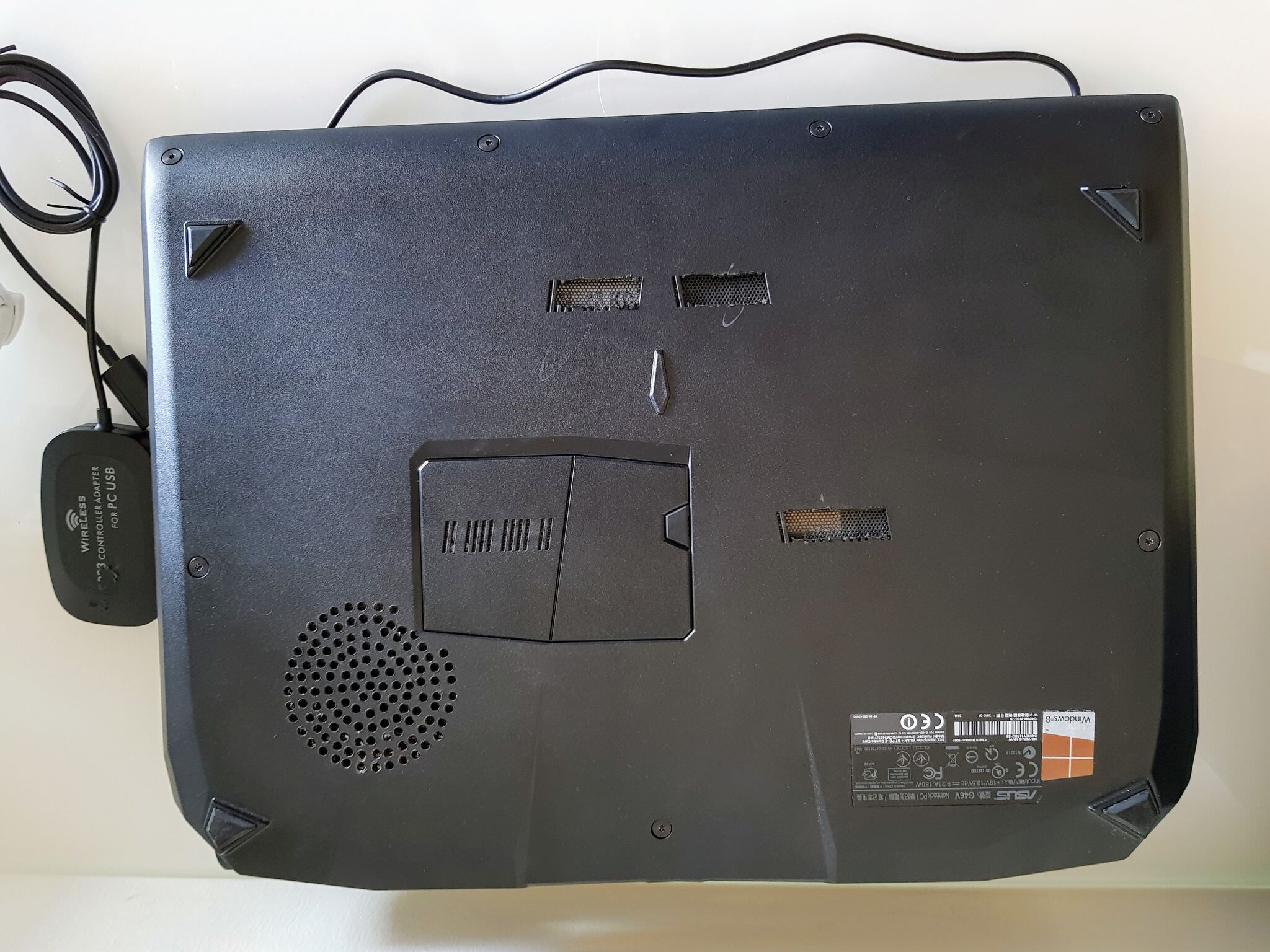

jacobsson Posted July 4, 2018 Share Posted July 4, 2018 (edited) @ModJPB Hi dude, It seems like I'm checking in once a year or so =) I actually flashed your BIOS mods, disassembled my G46VW, lubricated the fan rods, made an CPU air-intake + dust filter and put some liquid ultra between GPU and CPU. I never thought I'd actually bust this out from the closet for daily use again! The sounds levels are audible but more of a nice *swooshy* sound now. Here is a pic (I might do this for the GPU as well): Spoiler @Klem Now to my questions: 1.Do you guys have any good tutorial for flashing the BIOS + Unlocked ME BIOS with a hardware flasher? I have no problem soldering on wires for access points or even remove the bios chip. @ModJPB 2. I never figured out how to enable memory overclocking in BIOS, how did you go about doing that? Edited July 5, 2018 by jacobsson Quote Link to comment Share on other sites More sharing options...

ModJPB Posted July 15, 2018 Author Share Posted July 15, 2018 On 7/4/2018 at 7:52 AM, jacobsson said: @ModJPB Hi dude, It seems like I'm checking in once a year or so =) I actually flashed your BIOS mods, disassembled my G46VW, lubricated the fan rods, made an CPU air-intake + dust filter and put some liquid ultra between GPU and CPU. I never thought I'd actually bust this out from the closet for daily use again! The sounds levels are audible but more of a nice *swooshy* sound now. Here is a pic (I might do this for the GPU as well): @ModJPB 2. I never figured out how to enable memory overclocking in BIOS, how did you go about doing that? Glad to hear its turning out well. I love this machine but unfortunately My G46VW screen has all sorts of vertical lines after being dropped (sniffle) so I ordered a GS46VW. RIP! As nice as the MSI laptop is, the ASUS was a work of engineering art. I wish it continued. I really despise these current thin "gaming" laptops. They just don't have the cooling power. The MSI is good but I'm afraid to overclock it with the amount of heat it generates. Memory Overclocking is change by... in the "Chipset" menu under "Memory configuration". You have to choose "Dimm Profile [Custom Profile]" then change the "memory frequency limiter" to whatever you think will work. I was able to get 1866mhz running using Corsair vengeance RAM. 1 Quote Link to comment Share on other sites More sharing options...
