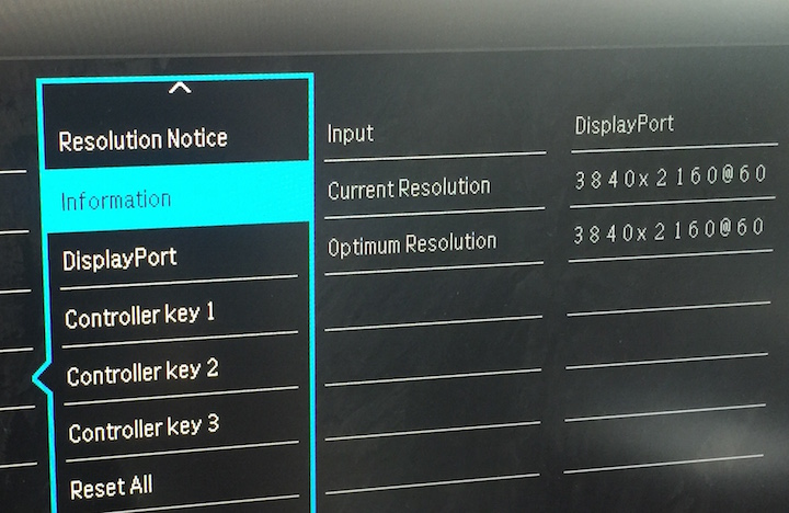

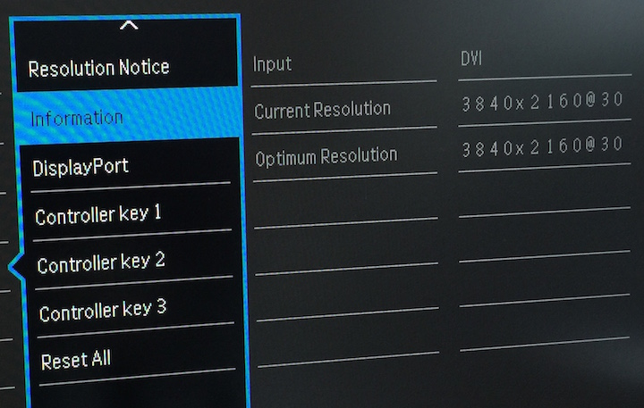

Mark Posted August 31, 2015 Share Posted August 31, 2015 Thanks @goalque! I only got around to trying out your new version!- I installed it with a clean install of 10.10.5 with success, using the HDMI monitor of my monitor for the first time (as what I've learned). I shut it down and it booted with the DisplayPort 4k60 works as usual.- I still had the same issue with it not being able to detect the eGPU after each boot after, but I was able to fix this issue by resetting the PRAM and reinstalling the script as I used to. The only thing now is that if I do this the -a mode doesn't work when I restart my computer.I've also noticed something about this subsequent boot issue. Every time I reinstall the script, I will get an eGPU output to my monitor every time if I haven't used anything that would require the computer switching to the dGPU if there wasn't an eGPU (i.e. graphically intensive programs like games). So if I only used Safari to visit TechInferno and restarted the computer I would get eGPU output again but I play a game or use Photoshop when I boot up the computer again the bar under the Apple logo during bootup will pause way before it should and I will neither get an eGPU output nor be able to go on "About My Mac" (and I won't be able to shut down if I do that either).For everyone else's reference, I am using a Late 2013 15" MBP with the 750M dGPU, an EVGA Titan X and a Sonnet III-D. 1 Quote Link to comment Share on other sites More sharing options...

Misha Posted September 5, 2015 Share Posted September 5, 2015 You should have original kexts before running the script as mentioned at GitHub.Seems that your monitor is not the best choice, problems with the DP: Benq BL3201 PT 4K Mac performance | MacRumors Forums. Indeed, the frequency display flicker changed after using this script. This can be seen in the settings of my secondary monitor. (I added two photos of before and after). If I use a script with original kext files, the situation will change? I have no problem with DP when I connect the monitor directly to MacBook (Thunderbolt - DP). Everything works fine. And in my opinion most of reviews about this monitor does not correspond to reality. It is wonderful and I am ready to recommend it to anyone! The only question is its suitability for use with eGPU Quote Link to comment Share on other sites More sharing options...
euqlaog Posted September 5, 2015 Author Share Posted September 5, 2015 Indeed, the frequency display flicker changed after using this script. This can be seen in the settings of my secondary monitor. (I added two photos of before and after). If I use a script with original kext files, the situation will change? I have no problem with DP when I connect the monitor directly to MacBook (Thunderbolt - DP). Everything works fine. And in my opinion most of reviews about this monitor does not correspond to reality. It is wonderful and I am ready to recommend it to anyone! The only question is its suitability for use with eGPU [ATTACH]15876[/ATTACH][ATTACH]15875[/ATTACH]If you edited kext files initially by hand, [-uninstall] option rsyncs back those edited files. Originals are recommended. The second pic shows 3840x2160@60Hz so you got it working via eGPU DP? The script doesn’t take part in display preferences, but future development may include nice new features for controlling eGPU displays. Quote Link to comment Share on other sites More sharing options...

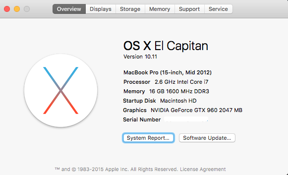

errin Posted September 11, 2015 Share Posted September 11, 2015 *** automate-eGPU.sh v0.9.6 - © 2015 by Goalque ***-------------------------------------------------------Detected eGPU GM206 [GeForce GTX 960]Current OS X 10.11 15A282aPrevious OS X [not found]Latest installed Nvidia web driver [not found]No Nvidia web driver detected.Checking IOPCITunnelCompatible keys...Missing IOPCITunnelCompatible keys.Mac board-id found.Searching for matching driver...No web driver yet available for build [15A282a]. @goalque Could you please help me with this? I'm on 10.11 GM with 15" MBP 2012 650m and eGPU GTX 960.Don't know why it can't find web driver. Quote Link to comment Share on other sites More sharing options...
Dschijn Posted September 11, 2015 Share Posted September 11, 2015 Is that the final Beta for 10.11? Guess Apple disabled the kext mod 1 Quote Link to comment Share on other sites More sharing options...
errin Posted September 11, 2015 Share Posted September 11, 2015 Is that the final Beta for 10.11? Guess Apple disabled the kext mod I tried it with previous public betas (about beta 3-5) and results are the same. It couldn't find the driver T_T Quote Link to comment Share on other sites More sharing options...
euqlaog Posted September 11, 2015 Author Share Posted September 11, 2015 @errin, beta drivers are not available automatically. Use -url option as pizzacat did 1 Quote Link to comment Share on other sites More sharing options...
errin Posted September 11, 2015 Share Posted September 11, 2015 @errin, beta drivers are not available automatically. Use -url option as pizzacat did Stupid me. Took time almost a month to ask. Now working fine in 10.11 GM with 15" MBP 2012 2 Quote Link to comment Share on other sites More sharing options...

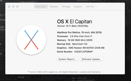

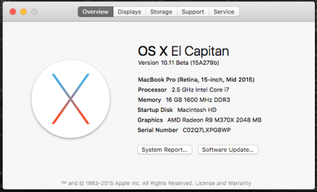

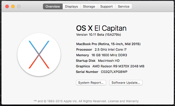

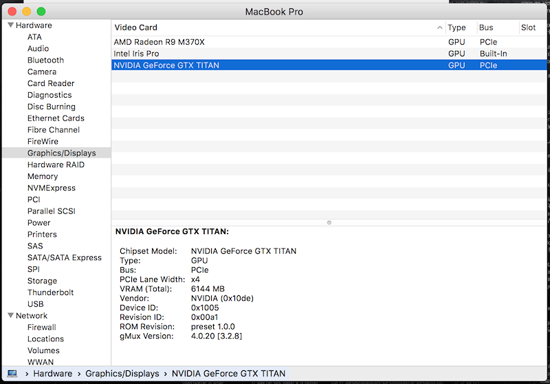

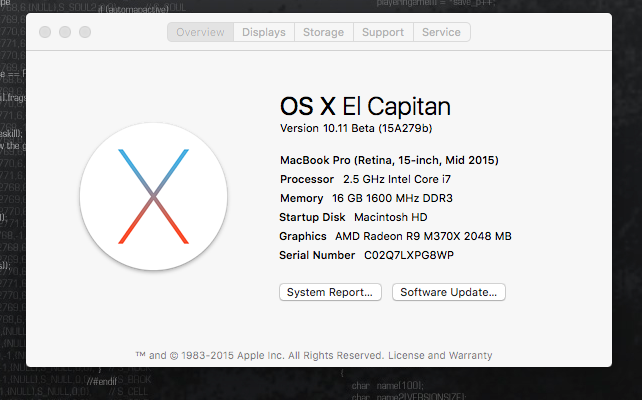

portwolf Posted September 17, 2015 Share Posted September 17, 2015 Goalque, firstly you're a bad ass. I actually found your GitHub for Automate eGPU after doing hours of research and getting a lot figured out manually. My setup Mid 2015 MBP with R9 M370X I'm running El Captain Beta, a little later build than your script currently supports. AKiTiO Build with EVGA Titan I used CSRUTIL to disable System Integrity Protection, and was able to update the Kext files. The Titan is showing up in System Report However I'm unable to get displays to be recognized through the card. Note there's no hardware issues, because it works great on Windows 10 via Bootcamp, and have already tested gaming with it. However in order to make it work on Windows I had to disable the R9 M370X, a task OSX does not make so simple. This is where I got stuck, and found your script. I ran it, after already updating CSRUTIL to disable, and Kext files. It recognizes my GPU, but says there's no driver yet for my build. Is it worth reverting to Yosemite or trying to revert to a previous build? Or should my displays be working anyhow? My goal is to be able to power all 3 of my external displays, via the Titan, and not have to use the internal graphics at all, on Windows and Mac, when the Mbp is docked. Thanks for your help, I'm making a comprehensive instructional video on how to build an eGPU, and I will be promoting and linking your GitHub, (if you don't mind). ! Quote Link to comment Share on other sites More sharing options...

portwolf Posted September 17, 2015 Share Posted September 17, 2015 Firstly, Goalque you rock. Definitely including a link to your GitHub in my build demonstration / tutorial video. So my build is AkiTio Thunder 2 / EVGA TITAN / MBPr Mid 2015 /w R9 M370x Working fine in Windows 10 on bootcamp, only interested in powering external displays. (I had to disable the R9 to get things smoothly in windows, but not so simple in OSX) Did some research before coming across this thread and Automate script. Disabled System Integrity Protection with CSRUTIL Updated my KEXT files as noted in other tutorials,. and this thread. Titan is being recognized by OSX, but will not recognize or output to displays Tried the Automate script, notedly after updating my KEXT files and disabling SIP Script recognizes card, but does not find drivers for my OSX build. Is there something I can do, or should I try to roll back to an older build, or Yosemite? Has anyone else successfully done a build on a Mid 2015 with the R9 Discreet card? Thanks Quote Link to comment Share on other sites More sharing options...
