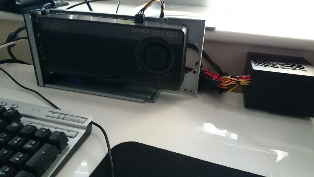

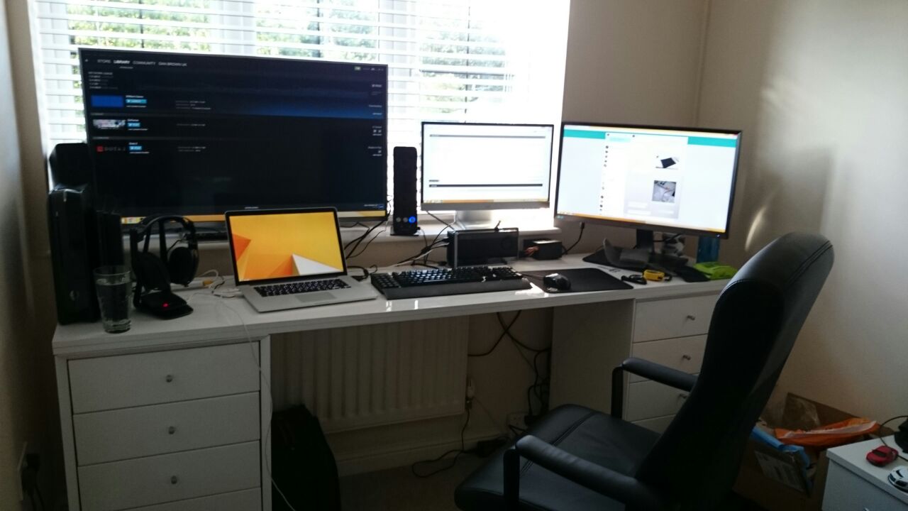

  8. Hi all, You may have seen my other thread where I got an eGPU working on my 2011 Macbook pro. Based on this success, I decided to take the plunge and do a full desktop replacement, replacing my own-build Alienware x51 desktop for a 2015 15" Macbook Pro with AMD discrete GPU. Spec of desktop & new MBP Item/Machine Alienware x51 2015 Macbook Pro 15" CPU i5 3570k i7 4780HQ RAM 16GB 16GB Storage 128 SSD/750GB HDD 512GB m.2 SSD GPU GTX 660 AMD R9 M370X + GTX 660 My previous build had me using my eGPU from a (poorly) made aluminium case for portability so that I could take the build on a flight to Sweden for the Dreamhack Summer 2015 festival. For this build, I knew I was unlikely to get nVidia Optimus running, so this eGPU would be primarily desk-bound. As a result, I opened my AKiTiO case to enhance cooling and provide a more secure implementation. Benchmarks to follow (I will update my previous thread also!) Ran benchmarks using free version of 3DMark, settings may be incorrect as I have not paid to change the default res, I wonder if anybody could confirm if I need to buy it or not? Win 8.1 eGPU 660 External Monitor 3DMark13 Fire Strike 1.1 - 4211 Sky Diver 1.0 - 12855 Cloud Gate 1.1 - 25386 Ice Storm 1.2 - 173245 Win 10 eGPU 660 External Monitor 3DMark13 Fire Strike 1.1 - 4215 AMD Radeon R9 M370X video card benchmark result - Intel Core i7-4870HQ Processor,Apple Inc. Mac-06F11F11946D27C5 I'll be upgrading the machine to Windows 10 tomorrow evening and will re-run benchmarks for comparison. I also plan to purchase either a 970,980 or 980ti in the near future and benchmarks for the card I choose to purchase will be added. Re-worked desk & purchased a laptop-cooler:

  12. Yes I used the components just with the lid open on the case Added some details shot for you, let me know if you want any other angles etc

  14. Sure, I'll take a bunch of shots of the componenets, with and without the foam and take some accurate dimensions of all the components used. Will have to wait till tonight though as am at work now Would you like me to run any benchmarks at all?
