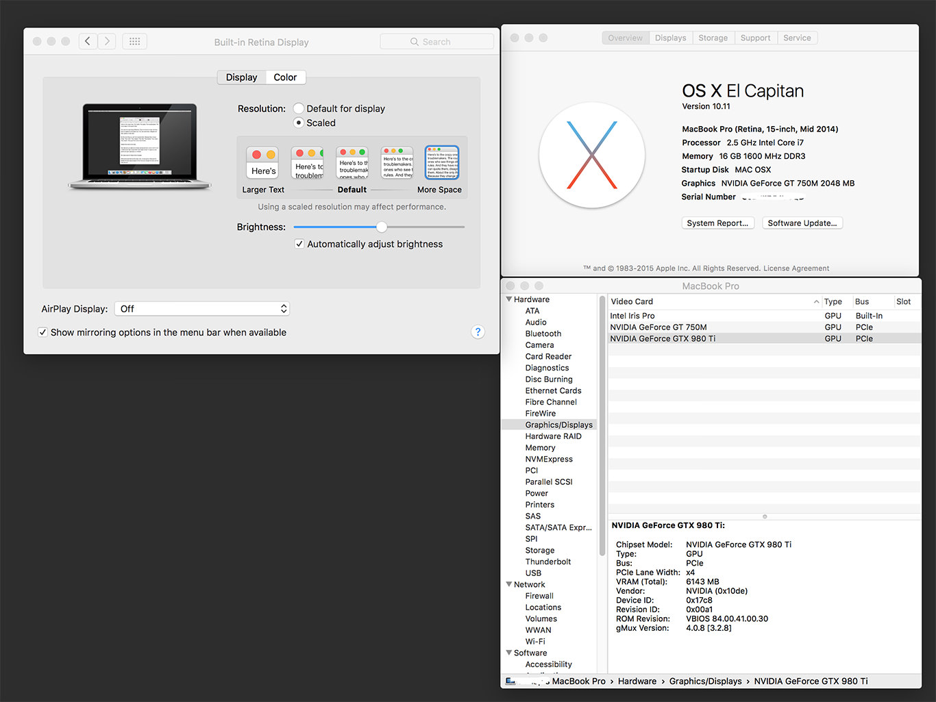

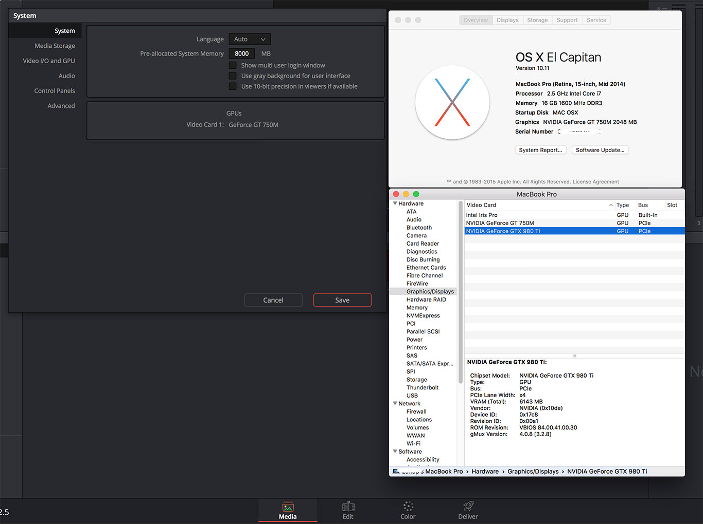

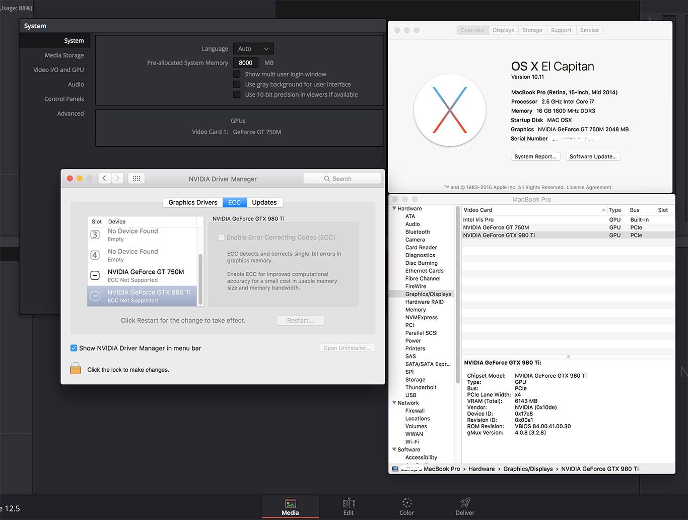

MultiU Posted August 29, 2016 Share Posted August 29, 2016 (edited) Hi Goalque, Thanks very much for the script. I had it successfully installed and it detected my GTX 980ti using Akitio Thunder 2 and running 10.11 on my MBP 15" Mid 2014 GT 750m After the issue with the eGPU crashing and going through uninstalling it a few times, I finally got it going again. I used the -uninstall option of the script and reseated all the components and then retried then used automate-eGPU.sh -a the first few times i had the " Nvidia Chip " issue and now it recognised as gtx 980ti I am now trying to get the programs to recognise the card in Resolve and CUDA core programs which is my primary concern but it seems I am missing something, I connected the card to an external monitor also and it is not recognised in the systems preference and just stays dark. Any suggestions on what I need to look out for? I read that if i was only using CUDA programs I can comment out "A quick fix, 1) sudo ./automate-eGPU.sh -uninstall and restart the Mac 2) Change the line 62 of the script to: config_board_ids=() 3) sudo ./automate-eGPU.sh and restart the Mac " but i only found the line 52 of the v 0.9.9 TIA Edited August 31, 2016 by MultiU update Quote Link to comment Share on other sites More sharing options...
