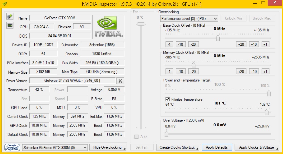

i approved that new 347.88 driver is overclockable as before ..! MSI GT72 GTX980M

Good news is 347.88 is also the first, and as of now only driver, to ignore the new core OCB (over-clock-block) bit in the vBIOS:
Just to make sure they can't just block everyone with this bit again with a new driver in 6 months I will also keep removing the OCB in all my vBIOS Mods! ;)

OK, here we go again:
- 347.88 & 347.90 have the clock block removed and ignores the vBIOS "OC-lock-bit" only partially:
(If you only unlock the core slider on a clock-block-vBIOS, then this driver will still limit you to only 135Mhz)
- 350.12 now no longer ignores the vBIOS "OC-lock-bit". So if you have a locked vBIOS, OC is gone entirely once again.
BUT, it doesn't end there...new lock bits have now also turned up on system BIOS level...more later after I am done testing.
So it boils down to this:
If you have a vBIOS dated before early December then OC works with 350.12.
If you have a vBIOS dated later than early December then OC is blocked once again.
If you have one of the new system BIOS with additional "OC-lock-bit" then, well...more later.
