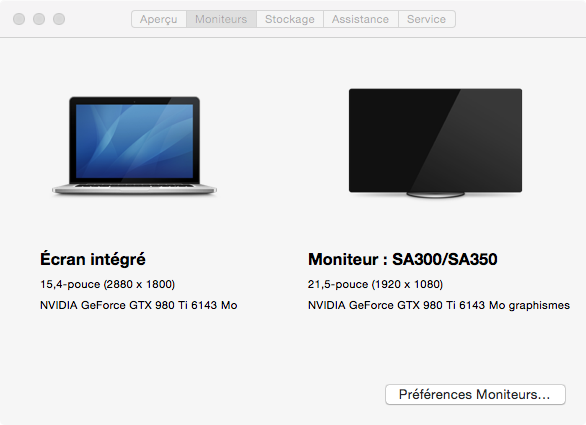

soularchive Posted September 24, 2015 Share Posted September 24, 2015 Many thanks for the help. Unfortunately the problem is not solved with 10.10.5 and the new driver 346.02.03f01. I have removed the PCI riser and put the GPU directly on the Akitio card which is now powered with the original barrel cable. I have exactly the same issue described in my last post. Avoid hot-plugging eGPU displays and run benchmarks on the eGPU screen. What works : - shut down the computer, plug the thunderbolt with egpu without external monitor, boot the computer -> the egpu is recognized by the graphic driver 100% of the time. - reboot the computer with egpu without external monitor -> the egpu is recognized by the graphic driver ~20/30% of the time. - after a kernel panic i have to leave the computer reboot, shut it down, boot it again and shut it down to be able to recognize my egpu again. - if i try to hot plug a monitor to the egpu when it is not recognized by the graphic driver i will have to shut down the computer, boot it again and shut it down to be able to recognize my egpu again. With external monitor when my egpu is recognized : - hot plug external monitor in DVI after shut down & boot -> external screen as a second Desktop, very unstable, it will shut down the computer and make a black screen a few seconds after. - activate before in gfxCardStatus integrated graphics only and hot plug external monitor in DVI after shut down & boot -> external screen as a second Desktop, remain stable but it is driven with the iris pro as i can notice in the section « about this mac », i am able to switch to dedicated only without crash but it is now driven by my dgpu (gt 750m) and it crash as soon as i put a google chrome page in it. - hot plug external monitor in hdmi after shut down & boot -> the screen of my desktop flash in the external monitor for ~1sec and it cause a kernel panic. - activate before in gfxCardStatus integrated graphics only and hot plug external monitor in hdmi after shut down & boot -> always cause a kernel panic. - activate before in gfxCardStatus integrated graphics only and hot plug external monitor in hdmi after shut down & boot -> it recognized my internal and external monitor as driven by the gtx 980 ti but it shut down after ~10 sec and i tried 4 more times and never succeeded to make it work. - Deactivate the automatic permutation of the graphic cards in system preference, boot the computer with the egpu and the external monitor in hdmi -> once again both internal and external monitor are recognized as driven by the GTX 980 TI but it shut down shortly after but never succeeded to make it work again. I noticed that the option to automate graphic switching reactivate randomly after several restarts but i really can’t see any pattern outside of the fact that my computer can recognize the egpu. Here is the output of the eGPU + hdmi monitor after hot-plug -> OSX 10.10.5 GTX 980 TI hdmi output.txt The output of the eGPU + hdmi monitor after hot-plug when it the eGPU is recognized as the main GC for both monitor -> OSX 10.10.5 GTX 980 TI as dedicated graphic card.txt Quote Link to comment Share on other sites More sharing options...
euqlaog Posted September 24, 2015 Share Posted September 24, 2015 Unfortunately the problem is not solved with 10.10.5 and the new driver 346.02.03f01. I have removed the PCI riser and put the GPU directly on the Akitio card which is now powered with the original barrel cable.I hope you are not using two PSUs. Maybe you could be in touch with the 750M users who don't have these problems. I would try setting the external monitor as primary. When successful booting procedure is found, it can be automated by the script. Quote Link to comment Share on other sites More sharing options...
tuckerchapin Posted September 24, 2015 Share Posted September 24, 2015 This is a ridiculously n00bish question, but I cannot for the life of me figure out how to get the Nvidia drivers installed to use my eGPU. When I try and boot into Windows 10 with the eGPU plugged in it gets to the Windows logo, but fails before it gets the little loading icon. And when I try to install the Nvidia drivers without booting with it plugged in (plugging it in after the fact) I get the error that the installer could not find compatible hardware. People seem to be having success using an external monitor but I have no luck...? Mind you, on OSX the set up works flawlessly 100% of the time. Quote Link to comment Share on other sites More sharing options...
soularchive Posted September 24, 2015 Share Posted September 24, 2015 I have read this thread -> http://forum.techinferno.com/provisional-guides/10516-2013-15-mbp-gt750m-gtx980ti%4016gbps-tb2-akitio-thunder2-win8-1-osx10-10-%5Bcascas-3.html.Still no luck with my setup, it doesn't help nether if i select my external monitor as primary. It seem that no matter what i do to effectively use the graphic card (Unigine etc), it will crash immediately. @Simurgh5, @Mark, @josho, @soularchive and other 15” Nvidia dGPU equipped MBP owners. I got an idea to modify the web driver package purely for your external GPU, so that dGPU (such as 750M) will never utilize the web driver. This will not take long.It would be great to have a new script that allow that (if it could help in my case) ! ps : I'm using the original power supplier that was in the box to drive the Akitio as i don't have any adaptor from 6/8 pin to barrel plug currently. It could be the issue ? Quote Link to comment Share on other sites More sharing options...

euqlaog Posted September 25, 2015 Share Posted September 25, 2015 It seem that no matter what i do to effectively use the graphic card (Unigine etc), it will crash immediately. ps : I'm using the original power supplier that was in the box to drive the Akitio as i don't have any adaptor from 6/8 pin to barrel plug currently. It could be the issue ?Yes. Always use a single power source, and if you have to use a powered riser, you have to know whether it is back powered or not. Otherwise, you can damage the system. Quote Link to comment Share on other sites More sharing options...
