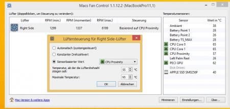

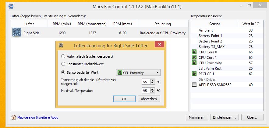

80°C isn't much for a Laptop CPU.
I am using this Tool to set a different (more aggressive) fan profil in Windows Macs Fan Control - control fans of any Mac & Boot Camp! | CRYSTALIDEA Software
With this settings:
[ATTACH=CONFIG]12932[/ATTACH]

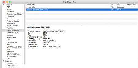

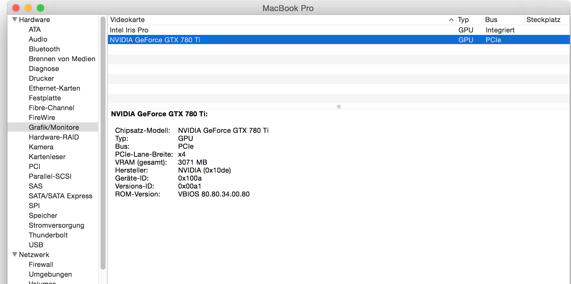

Any ideas why im not getting a display output?
NVidia drivers are installed and working (loading)
System Info looks good
Monitor on DVI port but i can't get any display...
[ATTACH=CONFIG]12977[/ATTACH]
[ATTACH=CONFIG]12978[/ATTACH]
Macbook Pro Retina Iris only
It's the same problem with Mid 2014 15" MBPr Iris Pro, external monitor is not detected. Would you clarify what year model, late 2013 or mid 2014? According to the picture, you actually have Iris Pro.
Haha, what I did was plugged out TB2 without shutting down the OS X 10.9.5, then the OS X crashed. When the display showed 'Kernel panic', pulled in the plug then press return button. After the OS X restarted, the external display worked.
Doesn't work with Iris Pro only model, I guess you have the 750M.
Mid 2014, so no chance with Iris only model and OS X?
Yep, I have tried various methods without success. Thanks for confirming. I haven't seen any report of the 15" Iris Pro late 2013 model, but it does work with 13" Iris (late 2013). I really hope that Apple hasn't disabled this feature with their new firmwares.

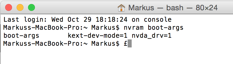

Is there a thread anywhere on kext? I keep seeing it mentioned but haven't seen a thread or post dedicated to it. I'll be assembling my setup this week and want to be prepared. I have a 2013 MacBook Air.
http://forum.techinferno.com/implementation-guides/8059-%5Bguide%5D-2013-15-macbook-pro-gt750m-gtx780ti%4016gbps-tb2-sonnet-ee-iii-d-osx10-10-a.html
Has all you need to know about it really. I can't stress enough though about the nvram thing, make sure that is set, and also sudo cache at the end too like explained in the guide.
