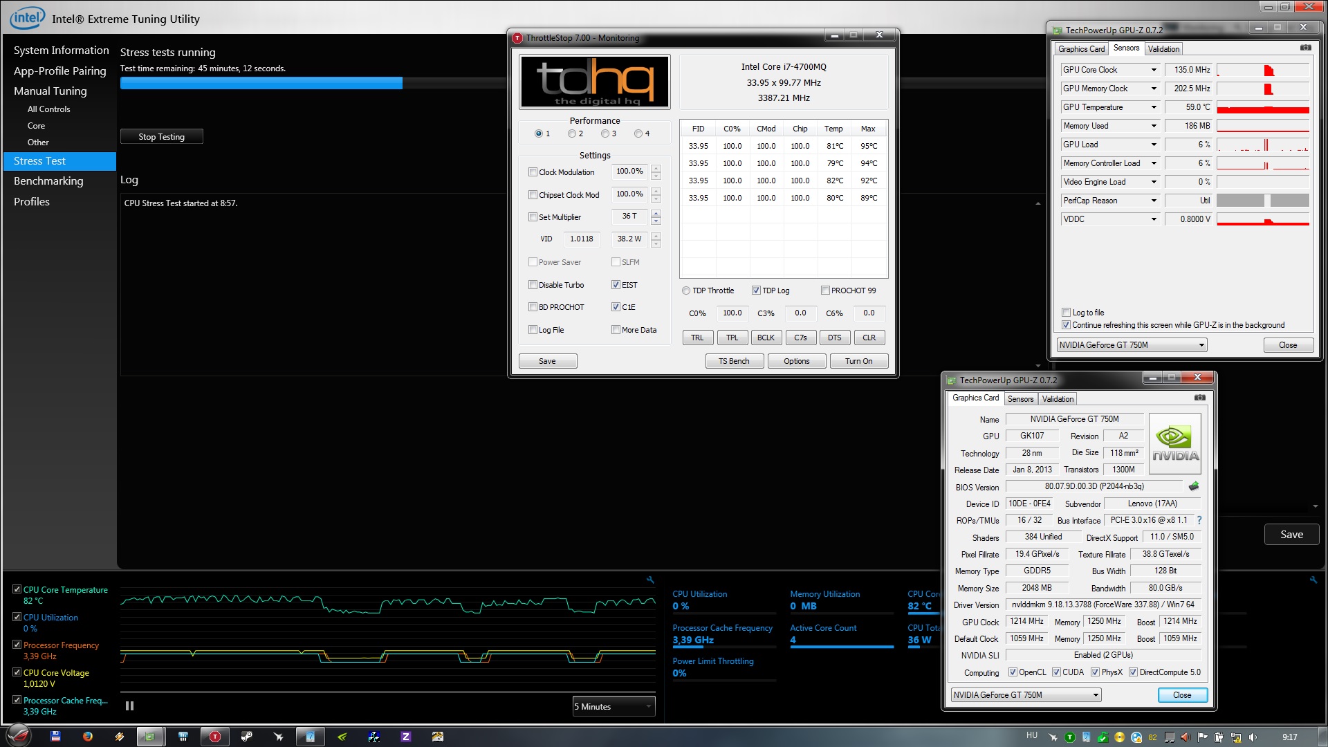

See CPU Throttling percent in XTU and TDP Throttle in ThrottleStop. If either of them is on - CPU is throttling (either on TDP aka watts or in XTU aka because of temperature). BD PROCHOT option sends signal to throttle because of temperature. Interesting enough would be to see whats happening on your end.
P.S. Do not mix ThrottleStop and XTU running at the same time - it can produce different results as each one overrides another.

Checking Set Multiplier in TS is what fixes the throttling per the first reply to your thread (mine) and overrides the >65C GPU throttling of CPU set in the EC. BD PROCHOT, whether in TS or BIOS, does nothing. Test it for yourself if you don't believe me: Keep Set Multiplier checked at 31T and compare BD PROCHOT on vs. off. Additionally, you can ask @unclewebb @ghoul if you still don't believe me.

BD PROCHOT is the default method of throttling, implemented by intel. But since Lenovo used a more direct approach, we cannot go around it, with deafult methods, like prochot disabling. Luckily we have TS. :)
So far, by my experience, the methodology of EC is the following:
- You start to stress CPU.
- Because it is on a common heatsink with GPU, GPU starts to heat up too.
- When GPU is reaching 65C, EC sends a command, setting CPU speed to 2.4.
- When GPU is cooling down below 58 ( or some duration under 60, cant test it for sure) EC is setting max multi again.
When you are using TS, you are setting a direct multi, which overrides EC setting of multi 24.
Tested it, during EC throttling, using TS, setting max multi, and turning it off doesn't going back to 2.4 so EC is only setting command once/heatup. When it is cooled down below 58 and then heating up again, EC throttling occures again @65C.
Second GPUZ is used to run render test, beacuse by default GPU is only heated up to 62C, (staying flat on desk ;) ) so I had to push gpu to heat up a little to start EC throttling.
Secondly, even using unlocked bios, configuring thermal trip points and so on, fan speed cannot be tweaked, since all is controlled by EC firmware.
Hope that clears up things a bit.
