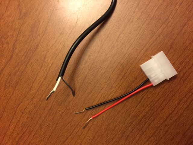

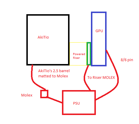

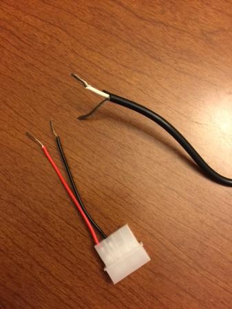

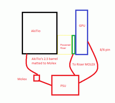

JimJ740 Posted September 23, 2014 Share Posted September 23, 2014 Some comments regarding my implementation....I am running the Akitio with an external PC power supply, PCIe riser with power tap, and an AMD R9 290X under OS X 10.10 DP 7. I use this system for OpenCL applications and am quite happy so far with results and stability.With a 2012 mac-mini (ThunderBolt 1) I get a LuxMark sala score of 2450.I do have an EE degree, and in reading through the thread there are a lot of troublesome assumptions that I see...First the disclaimer: I do not have access to schematics for the Akitio, nor do I have the time/desire to reverse engineer it, so I took the simplest/safest route.1) I use a single 600watt PC power supply. I cut the supplied Akitio power cable and mated it to a Molex 4 pin connector. The PC power supply powers the board, the PC riser, and the aux PCIe connectors on the video card. Using multiple power supplies carries the risk of ground loops that I wanted to avoid.2) Anyone who knows what a diode is and how it works would be aghast at the suggestions to backpower the Akitio logic board from the PCIe riser. I have no idea if there are any diodes used in the power circuitry or not - but why risk this?3) Power is not "shared" from the multiple sources on the video card. Specific parts are wired to specific power connectors. Often the engineer does not do this assignment at all; rather the design tools used to lay out the board can make these decisions. Make NO assumptions on where power is drawn from. Any card is free to draw up to 75 watts from the PCIe slot, up to 75 watts from a 6 pin PCIe aux connector, and up to 150 watts from a 8 pin PCIe connector. Do not think that just because you have a huge power supply on the PCIe aux connectors that you can get by with the puny 25 watts that the Akitio circuitry will deliver to the PCIe slot. For safety and stability additional power should be supplied to the PCIe slot.Note also that the modifications needed to the drivers to tunnel over ThunderBolt to PCIe will not work when kext signing is enabled in 10.10 DP 4 and above. There is a nvram option to disable kext signature checks.Good luck,-JimJ 1 Quote Link to comment Share on other sites More sharing options...
entzoe Posted September 23, 2014 Share Posted September 23, 2014 Jim can you please post an photo of your setup and connections please? Is this how you implemented your AkiTio? Quote Link to comment Share on other sites More sharing options...
JimJ740 Posted September 23, 2014 Share Posted September 23, 2014 Jim can you please post an photo of your setup and connections please?Is this how you implemented your AkiTio?[ATTACH=CONFIG]12602[/ATTACH]Yes, that is basically it. There are some case fans and other items hooked to the power supply too. I will take some photos this afternoon and post them. The main reason I wanted to post was to publish a successful/stable R9 290X setup, since most of what I read was about Nvidia and people having problems with AMD.-JimJ Quote Link to comment Share on other sites More sharing options...
JimJ740 Posted September 23, 2014 Share Posted September 23, 2014 Jim can you please post an photo of your setup and connections please? If you look closely, you can see I kept the Akitio inner chassis largly intact - I cut a bit of a notch for the PCIe riser cables so that I could use the shortest possible riser. I mounted the Akitio inner chassis to the case with a couple small machine screws. You can also see the "loop back" of the original power cable. This is actually a solderless implementation since the molex connector crimps on to the power cable wires... Akitio - $225 Power supply - $55 Case - $49 Molex connector and screws < $4 PCIe powered riser (20cm) - $12 Used R9 290X from ebay - $275 Performance benefits for rendering on a mac mini - priceless. The R9 290X is a bit noisy when the fans ramp... but I do not power it on unless I am doing jobs. -JimJ 4 Quote Link to comment Share on other sites More sharing options...
entzoe Posted September 23, 2014 Share Posted September 23, 2014 Awesome! I'm going to try this the mini itx you have (Cooler Master) ? --> Amazon.com: Cooler Master Elite 130 - Mini-ITX Computer Case with Mesh Front Panel and Water Cooling Support: Computers & AccessoriesCan you also share the KEXT files changes you made for AMD Cards? Quote Link to comment Share on other sites More sharing options...
JimJ740 Posted September 23, 2014 Share Posted September 23, 2014 Awesome! I'm going to try this the mini itx you have (Cooler Master) ? --> Amazon.com: Cooler Master Elite 130 - Mini-ITX Computer Case with Mesh Front Panel and Water Cooling Support: Computers & AccessoriesCan you also share the KEXT files changes you made for AMD Cards?Yes, that is the exact case.As for the kexts, I will do a bit more experimenting - I currently modify the plist.info sections of 4 kexts, I want to test to see if I really need to modify all 4 or not. When I am done I will post the minimal set of modifications necessary. Note that I probably will not post the actual kexts, since I have no way of testing compatibility with other versions of the operating system... best to edit part of a complete set. The modifications are simple for anyone who can use a text editor.-JimJ Quote Link to comment Share on other sites More sharing options...
entzoe Posted September 23, 2014 Share Posted September 23, 2014 sure you can just post what are the files you modified and which section you made on them... just similar to the previous post I made on the other thread; /System/Library/Extensions/NVDAStartup.kext /System/Library/Extensions/IONDRVSupport.kext /System/Library/Extensions/AppleHDA.kext/Contents/PlugIns/AppleHDAController.kext and issue the following sudo kextcache -system-caches [ATTACH=CONFIG]12618[/ATTACH] Quote Link to comment Share on other sites More sharing options...
entzoe Posted September 23, 2014 Share Posted September 23, 2014 Yes, that is basically it. There are some case fans and other items hooked to the power supply too. I will take some photos this afternoon and post them. The main reason I wanted to post was to publish a successful/stable R9 290X setup, since most of what I read was about Nvidia and people having problems with AMD.-JimJWhy do you have to power both the board and the riser at the same time? Isn't powering the riser is enough to supply the 16x slot?Thanks! Quote Link to comment Share on other sites More sharing options...
entzoe Posted September 23, 2014 Share Posted September 23, 2014 Yes, that is basically it. There are some case fans and other items hooked to the power supply too. I will take some photos this afternoon and post them. The main reason I wanted to post was to publish a successful/stable R9 290X setup, since most of what I read was about Nvidia and people having problems with AMD.-JimJ Hi @JimJ740 Can you please help me which wires to connect together? I found an extra wire exactly the same with AkiTio My molex has a red (12v) and black wire (ground) which one to connect from the ac cable? It has a white cover and the bare one.,, thanks! Sorry not an electrician here Quote Link to comment Share on other sites More sharing options...

JimJ740 Posted September 24, 2014 Share Posted September 24, 2014 Why do you have to power both the board and the riser at the same time? Isn't powering the riser is enough to supply the 16x slot?Thanks! The board power is for the ThunderBolt chip as well as the support circuitry (clocks, etc) for the PCIe bus. As mentioned previously, any diodes in this power circuitry will prevent current back-flow and some components may not receive proper power. Or put another way: yes, the PCIe riser power is sufficient for the slot, just not a guarantee that the other circuits get proper power. -JimJ - - - Updated - - - Hi @JimJ740 Can you please help me which wires to connect together? I found an extra wire exactly the same with AkiTioMy molex has a red (12v) and black wire (ground) which one to connect from the ac cable? It has a white cover and the bare one.,, [ATTACH=CONFIG]12619[/ATTACH] thanks! Sorry not an electrician here WARNING: the color coding convention for the Molex connector is that 12 volts is yellow and 5 volts is red. Are you sure that is wired correctly??? If in fact it is wired correctly, the bare wire is ground and connects to the black wire. The white center wire is 12 volts. To check the wiring of your molex, plug it into your power supply (with the power supply turned off) The connector is keyed and will only go in one way. Your connector should plug into a yellow wire from the power supply - they are color coded to the standard. -JimJ - - - Updated - - - @JimJ740: Which riser did you use? I have read that some are not "good" or stable… This is the exact one I used: http://www.ebay.com/itm/PCI-E-Express-X16-Riser-Extension-Single-Slot-High-Speed-Cable-with-Power-/261459534757?pt=LH_DefaultDomain_0&hash=item3ce033e3a5 -JimJ 1 Quote Link to comment Share on other sites More sharing options...
