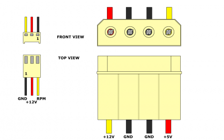

The board power is for the ThunderBolt chip as well as the support circuitry (clocks, etc) for the PCIe bus. As mentioned previously, any diodes in this power circuitry will prevent current back-flow and some components may not receive proper power. Or put another way: yes, the PCIe riser power is sufficient for the slot, just not a guarantee that the other circuits get proper power. -JimJ - - - Updated - - - WARNING: the color coding convention for the Molex connector is that 12 volts is yellow and 5 volts is red. Are you sure that is wired correctly??? If in fact it is wired correctly, the bare wire is ground and connects to the black wire. The white center wire is 12 volts. To check the wiring of your molex, plug it into your power supply (with the power supply turned off) The connector is keyed and will only go in one way. Your connector should plug into a yellow wire from the power supply - they are color coded to the standard. -JimJ - - - Updated - - - This is the exact one I used: http://www.ebay.com/itm/PCI-E-Express-X16-Riser-Extension-Single-Slot-High-Speed-Cable-with-Power-/261459534757?pt=LH_DefaultDomain_0&hash=item3ce033e3a5 -JimJ -

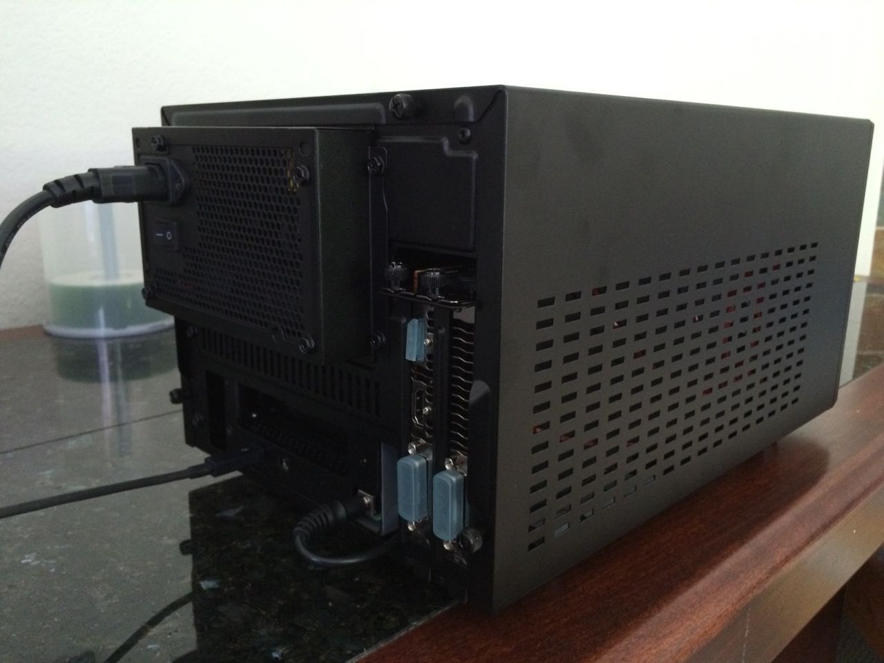

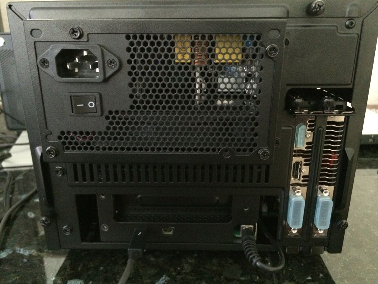

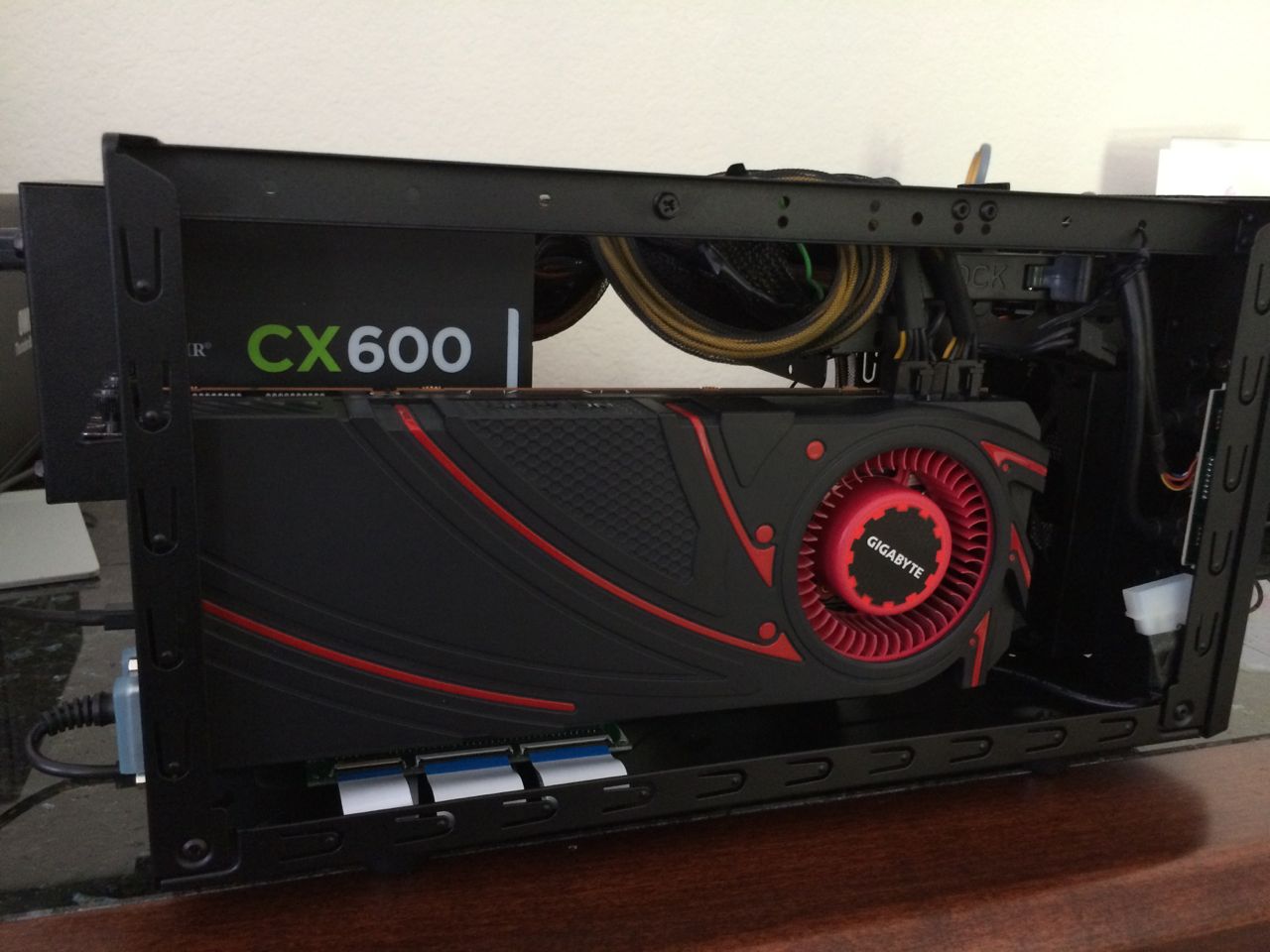

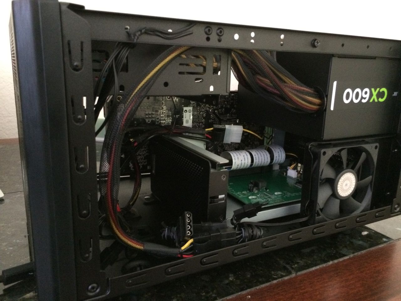

If you look closely, you can see I kept the Akitio inner chassis largly intact - I cut a bit of a notch for the PCIe riser cables so that I could use the shortest possible riser. I mounted the Akitio inner chassis to the case with a couple small machine screws. You can also see the "loop back" of the original power cable. This is actually a solderless implementation since the molex connector crimps on to the power cable wires... Akitio - $225 Power supply - $55 Case - $49 Molex connector and screws < $4 PCIe powered riser (20cm) - $12 Used R9 290X from ebay - $275 Performance benefits for rendering on a mac mini - priceless. The R9 290X is a bit noisy when the fans ramp... but I do not power it on unless I am doing jobs. -JimJ -

Yes, that is basically it. There are some case fans and other items hooked to the power supply too. I will take some photos this afternoon and post them. The main reason I wanted to post was to publish a successful/stable R9 290X setup, since most of what I read was about Nvidia and people having problems with AMD. -JimJ -

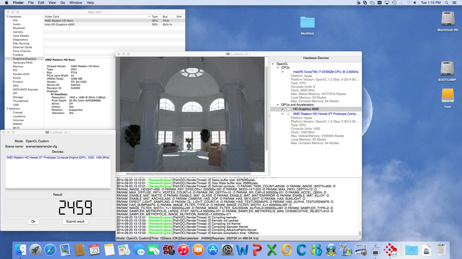

JimJ740 replied to Tech Inferno Fan's topic in Enclosures and Adapters
