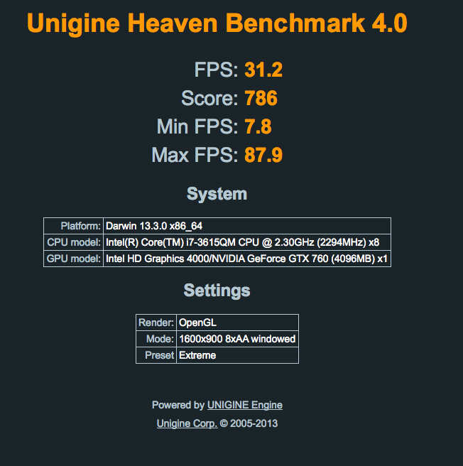

Here's my Ultra/Extreme Benchmark. So it's really on the GPU right?
Looks so. I have a GTX 780 with 6GB, and that VRAM probably gives some extra boost. Not much behind the Heaven benchmark result of MacBook Pro 15". I cannot say anything yet about stability but so far looks good. This will go under my TV, making it a perfect gaming machine and HTPC. I am close to have Win8.1 on it, but when starting to install Boot Camp drivers the screen went black and goes now black every time I reboot to Windows. I have a self modified version (64GB SSD + the original 500GB inside connected with a Mac mini server cable).

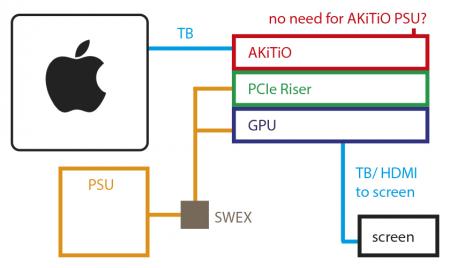

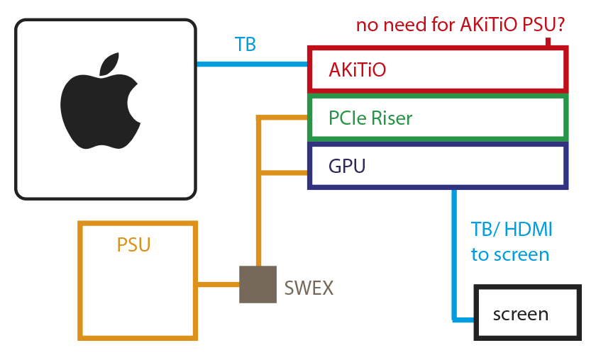

did i understand this correct? you don´t need the akitio-psu?
[ATTACH=CONFIG]12370[/ATTACH]
That is correct. If you choose AkiTio's adapter, then you will need to remove the riser.

but isn´t it an advantage to run the eGpu by a riser, since you only need to power-on one power-supply, instead of two with the akitio-psu?
Using a PCI-e RISER with Molex
  • PSU power off, Mac Mini off.
  • My SWEX is always turned-on
  • Attach the Molex riser to Akitio then Attach your GPU to riser. Connect a cable from your PSU to the molex adapter
    • WARNING do not connect the AkiTio's power adapter.
    [*]Connect the Thunderbolt Cable from AkiTio to your Mac Mini
    [*]Connect your HDMI or DVI from GPU to your Monitor
    [*]Power on PSU
    [*]Power on Mac Mini
    [*]You should be able to see your GPU Mac Mini's System Information
