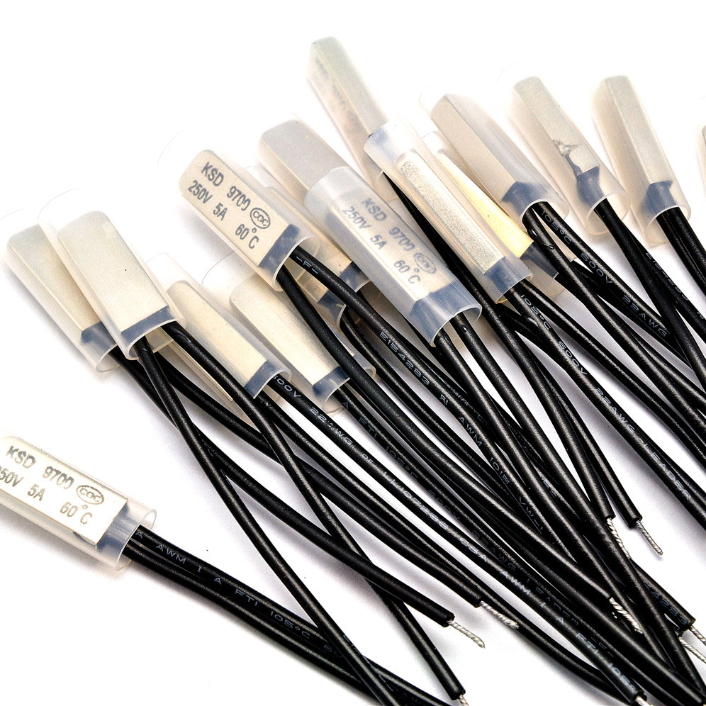

but im looking for something like this
so it will be automated but for that i need to know the temps of the heatsink so i could chose the right one
if u see my orginal post and answer that that would be great and why the temp of the speedfan program and realtemp program is soo difrent for cpu ? speedfan gives me around 65 while realtemp gives me +95
this switch when it gets to a specific temp will discunect so it will be all automated :Banane35:

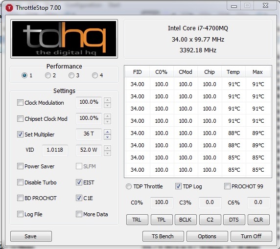

and would you please take a look at these pics and tell me why im geting 2 diffrent readings ? and why the ThrottleStop stop dosent keep the clock at 3.4 or so ...
when it does nothing
by the way cutout doesnt realy works here since its one time use u dont wanna change it everytime :D
when under load
notice the 2.4
when running the throtellstop
notice the increas by 2 ? 2.6 insted of 3.4 i mean it goes up a bit then drop to the 2.6 and stay there so i will never be able to get the max temp...

shows that your CPU is at 47.1 Watts. The multiplier has been automatically reduced to 27 to keep the CPU right at the power limit. You can not use ThrottleStop or any software that I know of to overcome this limit. With a modified bios, you might be able to run this CPU long term at over 47 Watts but then it is likely that your CPU temperature is quickly going to become the limiting factor.
Edit - ThrottleStop also shows TDP Throttle. That means your CPU is throttling because it has reached the TDP power limit, 47 Watts.

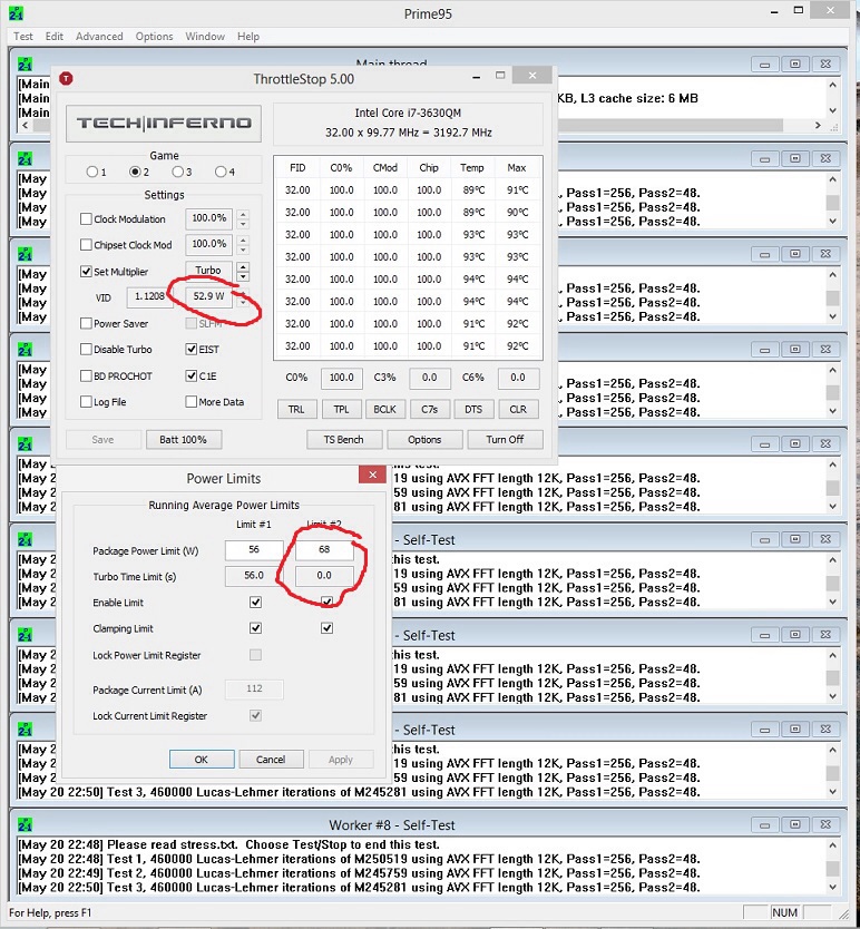

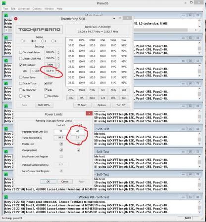

Yeah you can increase the power limit by about 10 W in the unlocked BIOS, which will let the CPU run at a higher multiplier in synthetics and burn tests. But not really useful in the real world as nothing makes it draw that much power.
With unlocked bios you can raise TDP limit, and time window more than that, but even with that, you are not able to modify current limit. Unlocked TDP allows to run [email protected], limiting it by current, but this is with modified cooling, with stock, it will probably fail. Anything else, not linx of course :), doesn't push cpu that far, so default TDP in real world situation is enough.

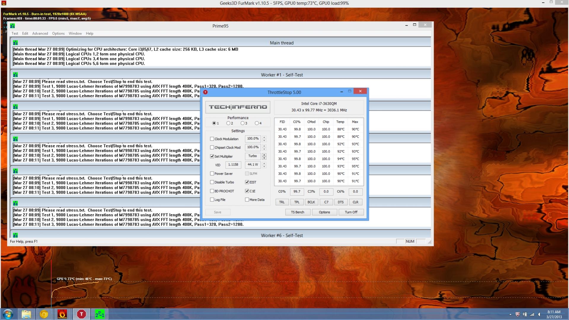

I guess the 4700MQ is a more power-hungry than the 3630QM then, because I run Prime95 @ ~3 GHz without unlocked TDP:
With the power limit increased, Prime95 runs with full Turbo Boost:
Yes, Haswell is more power hungry than Ivy Bridge. Outrageously so in default voltage form. Closer to 32nm Sandy Bridge in power consumption.

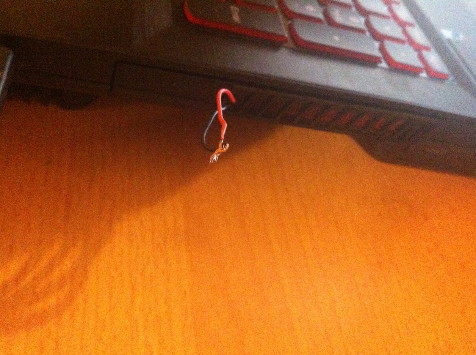

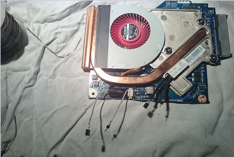

i did the mood with the termal switch if anyone insterested to see how it looks like i can post a pic here but it works gud
Please do post the picture. Could you also provide a link to the thermal swtich on ebay or whatever you bought it ?
  • 4 weeks later...
i bought it in person but you can serch for such thing thermal switch normal closed and the temp that u want it to start i chosed 80 C so at 80 it disconect the yellow wier casuing the fan to run at full speed when the temp get back to under 80 it conect it again and the fan goes silent under the bios setings
the switch has all shapes and colors doesnt matter mine is the white one on heatsink
