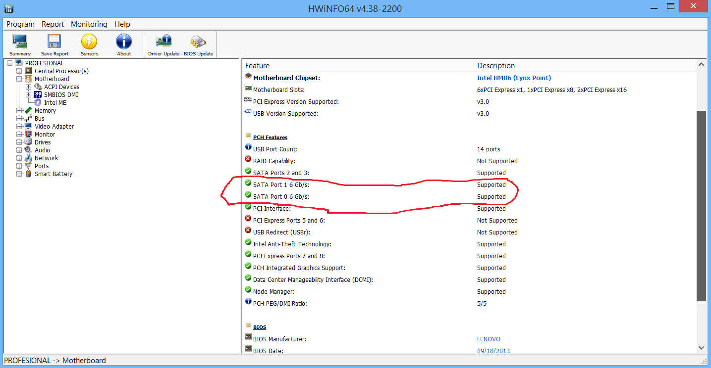

rambomhtri Posted June 5, 2014 Share Posted June 5, 2014 Hi, I have the Y510P, with the MoBo Intel HM86 and it has:Port 1 sATA III (6Gb/s), with the DVD reader/writerPort 2 sATA III (6Gb/s), with a sATA II (3Gb/s) HDD 1TBM.2 NGFF (sATA III too?), with a sATA III (6Gb/s) SSD 24GB for cacheSo it's more than probably that your Y410P has also 2 sATA III ports. I'd install the SSD in the main bay, and put in the DVD bay (HDD caddy) the HDD.You can download HWiNFO64, install it, and click in "motherboard" to see what interface your ports have. Also you can check the storage devices's interface. 1 Quote Link to comment Share on other sites More sharing options...

rambomhtri Posted June 5, 2014 Share Posted June 5, 2014 There you go: HWiNFO, HWiNFO32/64 - Download I have the x64 version, and I uncheck the "update to BETA versions". Then you must go to Motherboard: I don't know, I've read a lot of different opinions about that. Some say that if you didn't buy a SSD model, then you don't have the interface M.2 welded to the Motherboard. And that's true. But I've seen a lot of users having that M.2 interface welded, with no SSD, cause they didn't buy a SSD version. So I think it's kind of random. All you have to do is take out the back cover and see it. Or you can use X-Rays, xD. 1 Quote Link to comment Share on other sites More sharing options...

rambomhtri Posted June 20, 2014 Share Posted June 20, 2014 Why don't you guys just download HWiNFO x64 and see it yourself? Easy as pie. 1 Quote Link to comment Share on other sites More sharing options...

Excision Posted June 27, 2014 Share Posted June 27, 2014 I'm using Y510p with Samsung 840 Pro inside the laptop, and WD Blue in the ultrabay. I tried switching them and it seems like it is SATA III, as the SSD had the same speed. Quote Link to comment Share on other sites More sharing options...
rambomhtri Posted June 28, 2014 Share Posted June 28, 2014 I'm using Y510p with Samsung 840 Pro inside the laptop, and WD Blue in the ultrabay. I tried switching them and it seems like it is SATA III, as the SSD had the same speed.Yeah both main bay and DVD bay are sATA III, I've seen that using HWiNFO x64. For those that are using SSD's:Is it any situation where you have to wait to your computer to load or something? (I mean, where even SSD's speed is not fast enough)Do you notice the difference between HDD and SSD when opening folders with many photos or thumbnails?Thanks! Quote Link to comment Share on other sites More sharing options...
