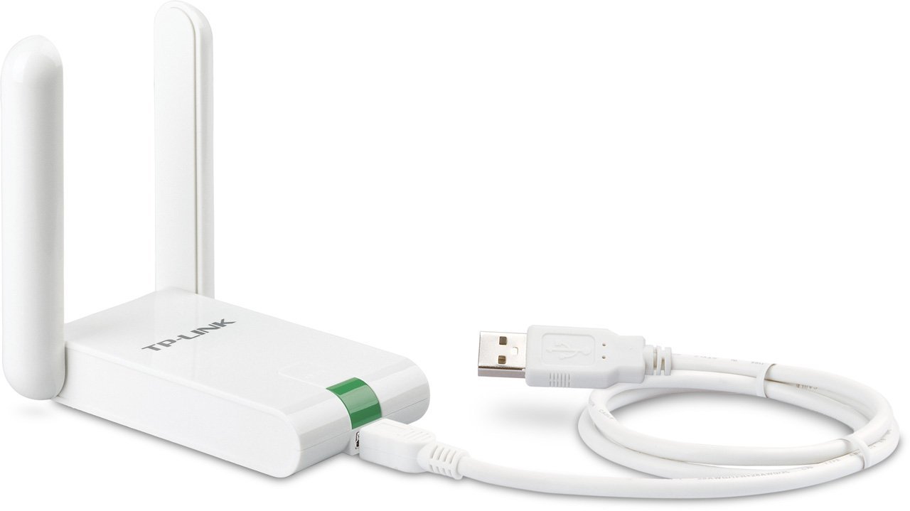

  7. Hi, I use my laptop in a room that is "far" away from the modem. It's like 20-25 meters, and there are walls between the laptop and the modem. The ONLY solution is buy a better WiFi card that has an amazing range and can reach nice speeds (2 MB/s or faster). So please, don't offer me any other product, I'm looking just for WiFi USB adapters. With my laptop's internal WiFi card, an Intel-N 7260, I can just sometimes connect to my modem, and speed is ridiculously slow, like 20KB/s, and the signal is very poor all the time. Months ago I bought a high-gain TP-Link 822 USB adapter: Using that adapter, I can connect to my modem 80% of the time, and I reach usually 200-300KB/s, that is not bad, but still not enough, mainly because sometimes the signal is so poor that it disconnects from the modem. 300Mbps High Gain Wireless USB Adapter TL-WN822N - Welcome to TP-LINK This adapter has dual 3dBi omni directional antennas, it's N, Transmit power <20dBm(EIRP), and these numbers: 270M: -68dBm@10% PER 130M: -68dBm@10% PER 108M: -68dBm@10% PER 54M: -68dBm@10% PER 11M: -85dBm@8% PER 6M: -88dBm@10% PER 1M: -90dBm@8% PER I'm looking for a considerably better adapter, with better specs so I can connect to my modem and navigate without problems most of the time. The problem is that I don't know much about all these WiFi specs, I don't know when they "lie", or what they mean. Do you guys know a better WiFi card under $40? Thanks!!!

  10. I don't know why you say that the Intel 7260 is good. I've bought a TP-Link external WiFi adapter USB, it's 300Mbps and high gain. Well, it costs just 14$ and it is WAY, I mean it, WAY better than my 7260. I have the Y510P with that card, and the range sucks SO hard. Or this card is really bad, or something's wrong with my laptop. The TP-Link range is so good, and it is super fast, so if a cheap card can kick this one's butt, I don't know why would you ever buy it. I've tried every single driver right out there, and the range is just not good. May be it's my laptop's antenna, but I think everything is OK.
