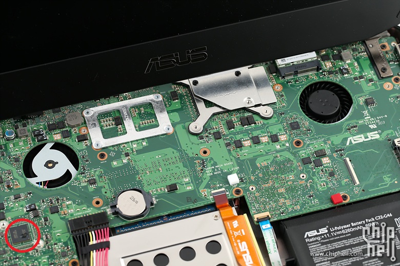

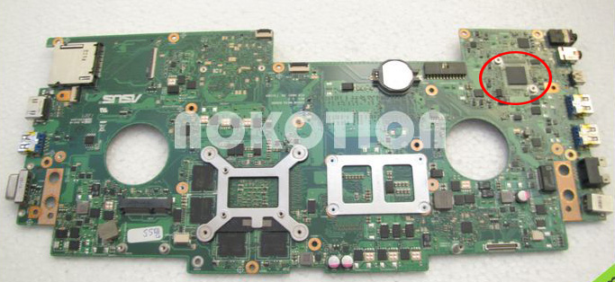

I Found A ASUS G46vw 1.2 and 2.2
this is the pic
and her is WHAT I think is a thunderbolt controller (red circled), and in the 2.0 it not present.
but win I receive today the 2.2 pics
I didn't found the controller
can you please conform that this is the controller or is it present in your motherboard?
sorry for that:sad:
@hamaki55
To be honest I really never understood how localize the TB controller on the mobo.
Mine has a blank spot where I first thought the TB-controller should have been located.
@ha1o2surfer Did you find how to recognize the TB-controller?
All I know for sure is that REV 2.2 boards has it.

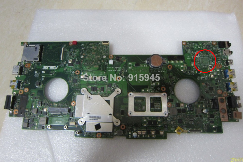

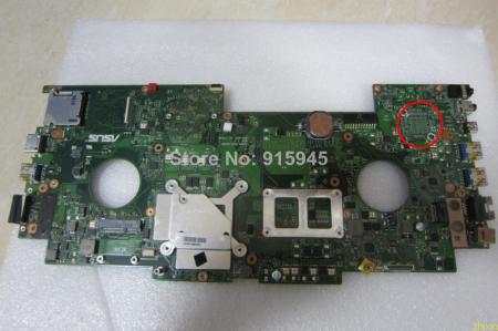

This seller shows a picture of a REV2.2, he also says it's REV2.2, see third picture in link:
Original Laptop mainboard / motherboard G46VW for ASUS, 100% Tested, warranty 30 days-in Motherboards from Electronics on Aliexpress.com

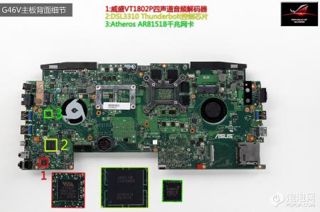

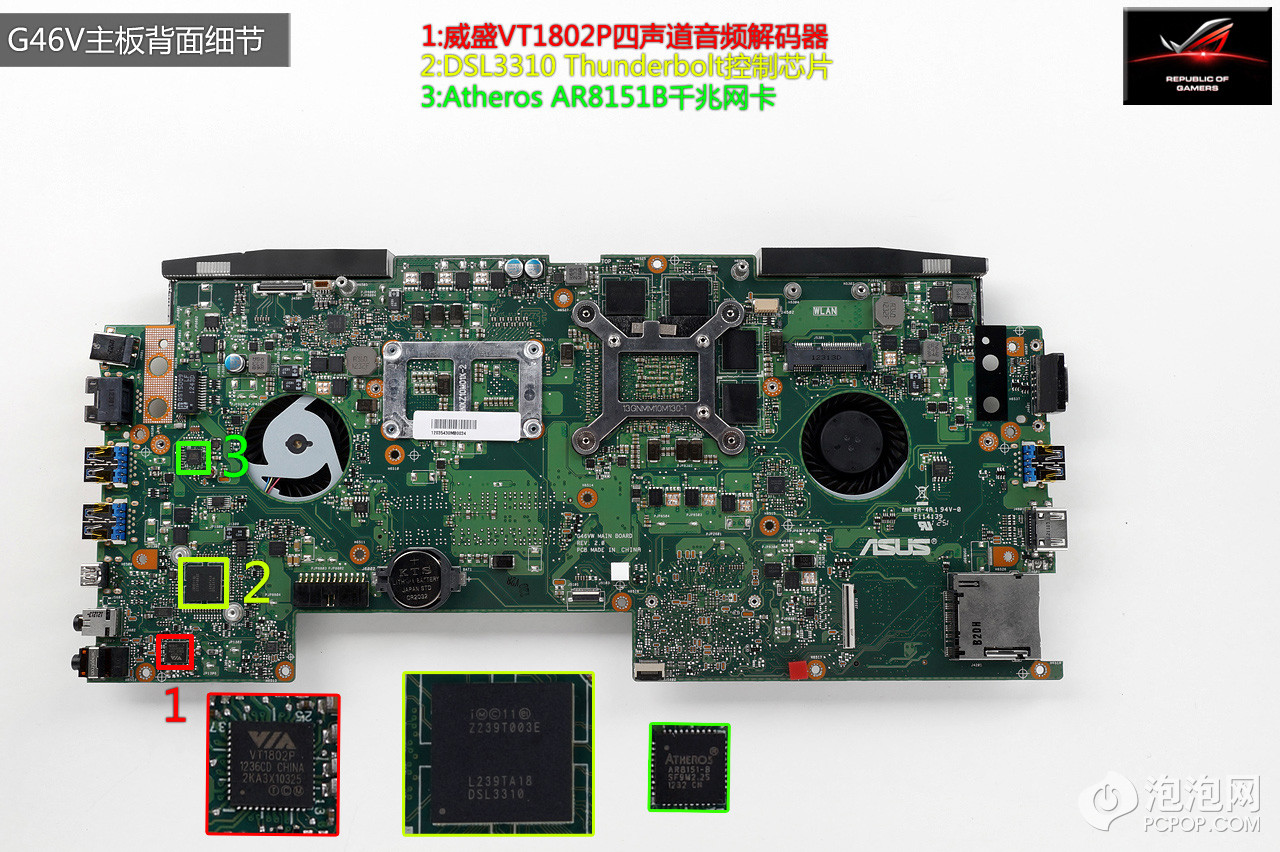

I think rev2.0 and 2.2 not judging conditions, you can see on the picture, both 2.2 rev2.0 motherboard have thunderbolt chip。post-28507-14494998407836_thumb.jpg
Judging from the information on the box,Hope that these pictues can help youpost-28507-14494998408544_thumb.jpg
DSL3310 is thunderbolt chip.
