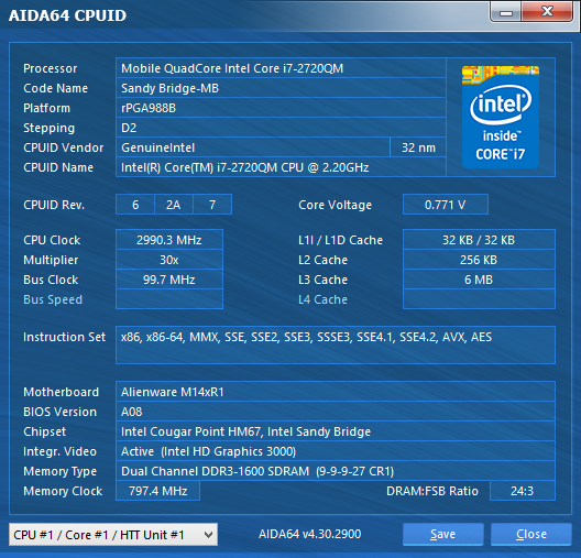

The post I read was that it supports single channel 16 gb 1333 mhz and dual channel 16 gb 1600 mhz. Now thanks to NforceRaid I'm sure it works. Makes sense though, the processor is only 2 gen old, so it should have the support to it. I always wondered though, does it make a big difference NforceRaid (not the capacity, mhz rate) ? Theoretically higher frequency should mean that is works faster but can you see any differences?
16gb of ram 4gb I have used for the ramdisk (Dataram), and believe me the difference is apparent. 1333 to 1600 there is not much difference, but if the 1600 has a good price, why not?
