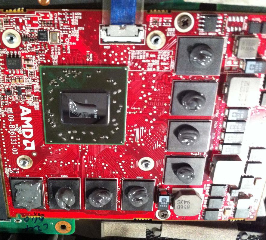

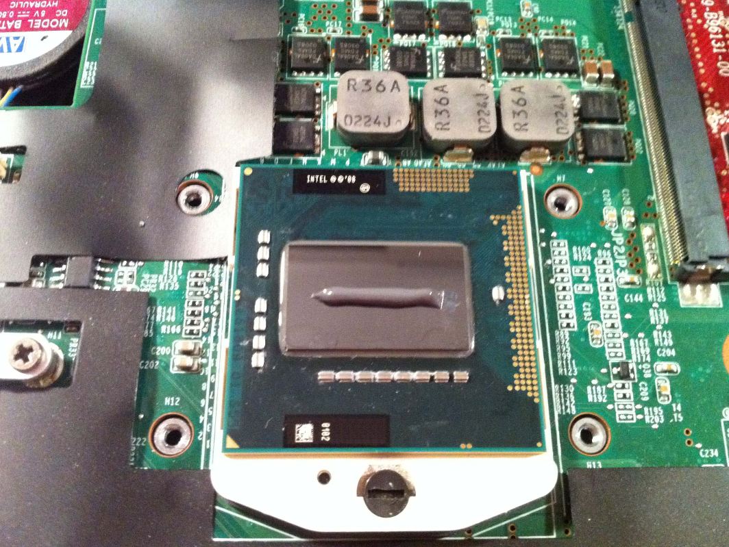

mark foster Posted September 27, 2011 Share Posted September 27, 2011 also do any you guys use laptop cooling pad or have changed thermal paste? Quote Link to comment Share on other sites More sharing options...
Founder StamatisX Posted September 27, 2011 Founder Share Posted September 27, 2011 I always replace the pads with thermal paste, I use ICD24 which is quite thick and can fill the gap. Quote Link to comment Share on other sites More sharing options...
mark foster Posted September 27, 2011 Share Posted September 27, 2011 ok tried with evga precision and it seems more reliable at 840 and 1020 but i will need further testing.to change the thermal paste is it just as simple as take the bottom panel off and the heatsink? Quote Link to comment Share on other sites More sharing options...
n3ocort3x Posted September 27, 2011 Author Share Posted September 27, 2011 You have to disassemble the whole notebook... I have done it a month ago... no problem. (But i haven´t done this the first time). Search for disasemble videos on the internet or wait for me (Will make one, next time I disassemble ... maybe this weekend).I use a Zalman notebook cooler. On weekends when i´m not at home i use none and its also ok. No crashes, with or without notebook cooler. Also i want to say that changing the thermal paste give me proper temperatures. But if you not change the thermal paste it´s also ok. I´m talking about 3 - 5 Degrees in unloaded state. It hasn´t crashed before I changed the paste. So its not necessary if you afraid of disassembling... Quote Link to comment Share on other sites More sharing options...

Nekojin Posted September 27, 2011 Share Posted September 27, 2011 At the moment I am using the A05 vmod and unlocked. I ordered a Belkin Cooler, but until now I did not use one. A Video of how to disamble it would be very great. I fear a bit to take it apart^^ Is there a big difference in temperatures from 2630 to 28xx? Maybe I will change the CPU at that moment too If you do a video, can you show how to replace the thermal paste? I am not sure on how much I should put on, or how. (normally I press some thermal paste in the middle and then install the CPU cooler Desktop...) A yes, I have a Noctua cooler with their thermal paste. Can I use that one too? Quote Link to comment Share on other sites More sharing options...

iloveb00bs Posted September 27, 2011 Share Posted September 27, 2011 At the moment I am using the A05 vmod and unlocked. I ordered a Belkin Cooler, but until now I did not use one.A Video of how to disamble it would be very great. I fear a bit to take it apart^^ Is there a big difference in temperatures from 2630 to 28xx? Maybe I will change the CPU at that moment too If you do a video, can you show how to replace the thermal paste? I am not sure on how much I should put on, or how. (normally I press some thermal paste in the middle and then install the CPU cooler Desktop...) A yes, I have a Noctua cooler with their thermal paste. Can I use that one too? courtesy of stam: pretty much a small line of paste down the middle. i recommend using the top brands like mx-4, ocz freeze,icd etc. since the M14x is a pain to open up, spending more money on paste is worth it. maybe pads too. 1 Quote Link to comment Share on other sites More sharing options...

robby_hd Posted September 28, 2011 Share Posted September 28, 2011 Yeah sure, but 830MHz is much more than 750 MHz and I'm already using a cooling pad.I wanted to attach thermal compound to CPU, GPU and GMemory, but I have no idea how to get to the CPU !When I open my M14x I can change the RAM, the HDD, the battery and the optical drive but which screws do I have to remove to get to the mainboard ???I already removed all screws of that big grey plastic skid, but it didn't move a bit ?! Quote Link to comment Share on other sites More sharing options...

robby_hd Posted September 28, 2011 Share Posted September 28, 2011 I will keep the clocks at that level And finally after 90 minutes of hard work, I attached thermal compound to CPU, GPU and GMemory. Now I have to test my temperatures. Soon I will change the RAM and add a SSD and then I think my M14x will be fine Greetz, you guys rock ! Quote Link to comment Share on other sites More sharing options...
