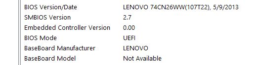

So i assume this is some pos weird version of the 107 bios? anyone know if this one can be modded I have the intel ac 7260 i would love to installpost-26411-14494997685853_thumb.jpg
I should add that i tried the unlocker from the first page for the 1.07 and 2.x versions and i get the error that this is a correct dump version etc.
