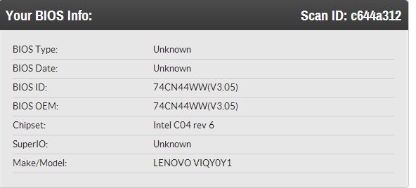

Gotten back my Y510p from the service center and i gotten this info that i captured on biosagentplus.com.. apparently when i try to boot into BIOS util or using the Thinkvantage Button (the one next to power plug port) the screen will freeze after 5-7 secs when it goes into the Lenovo utils mode.. Any idea on how i can repair the bios or the util before i can actually mod this beast ?
