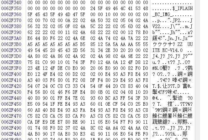

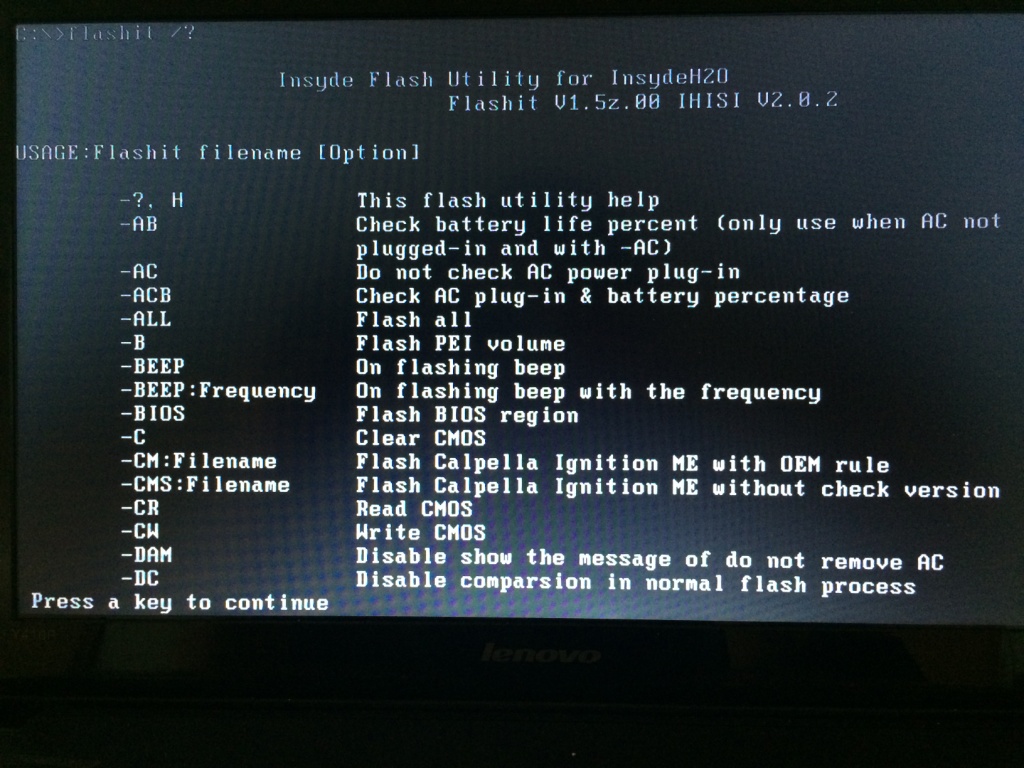

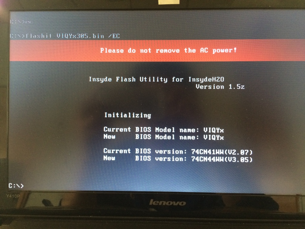

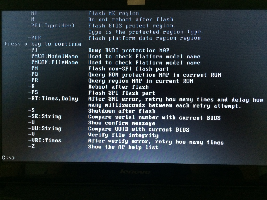

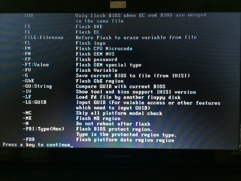

  3. Late,i do not download the test file. But now i understand,in the Official BIOS,search "iflash_ec_img" ,from 02 00 70 02 ...cut 131072 bytes. It's EC file. Use flashit xxx.bin /EC. Now my EC version is 3.05.

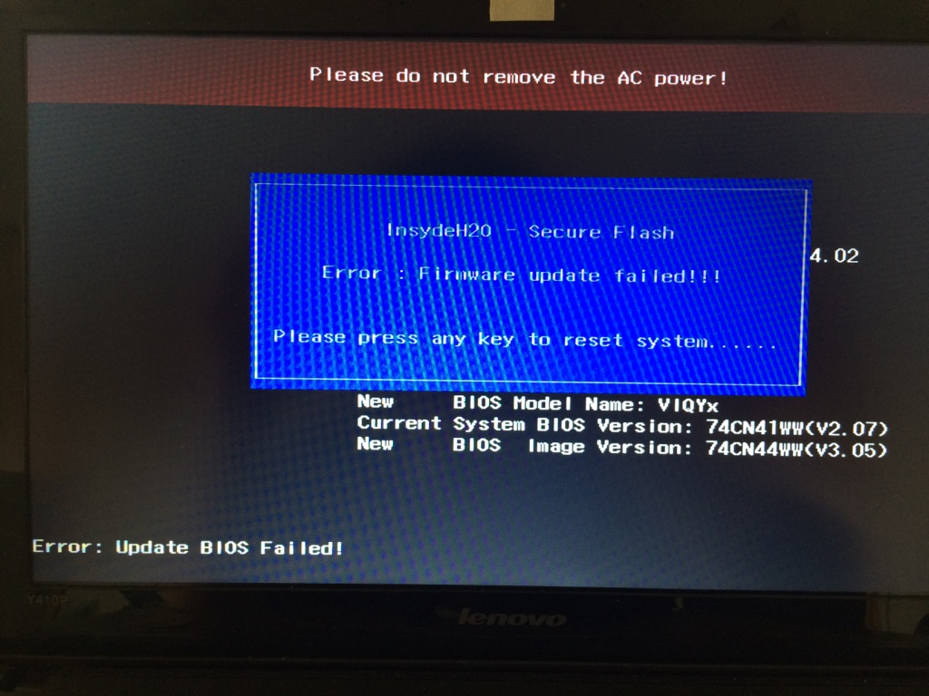

  4. flash failure 1.boot in dos run EC.bat waiting for a second, Ctrl+Alt+Del restart 2.restart 3.restart again,in the bios setup EC version not change.
  5. Yes,EC became V2.07 ,when i flash your Y510p-Y410p_v207_[stock].
  6. EC can not flash by oneself.It do not store in the SPI IC(2M 4M). I used the spi programmer,EC can not change. The EC program must store in the IC(IT8586E).
