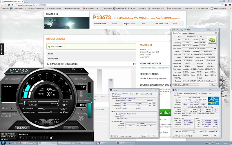

I have the answer to that question. My card will do 1019 MHz with 2d content but as soon as I fire up a game or a 3d render test it goes to where I set it to be clocked at in Precision X.
Thanks again for all your hard work on these BIOS's. You have really saved the FPS day!
