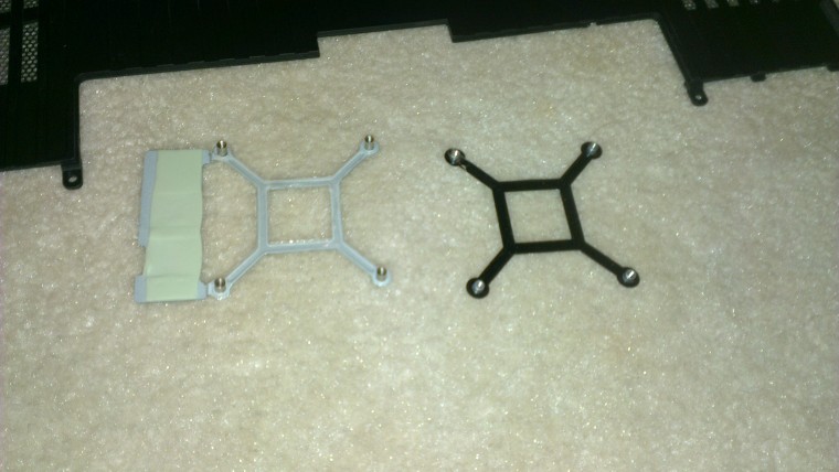

Demolisher Posted July 29, 2013 Share Posted July 29, 2013 Hello everyone, I'm wondering, is it better to use the back X plate that was originally in the M15x (the one on the right in the picture) or the one that came with my 770m (on the left) Both of them fit in the computer. Thanks! Quote Link to comment Share on other sites More sharing options...
fatboyslimerr Posted July 29, 2013 Share Posted July 29, 2013 The one on the left has a cover for the VRAM on the bottom of the card, if your card has VRAM (black chips) on the bottom which it looks like it does from the compression of the thermal pads then I'd use the one that came with it for slightly better cooling. 1 Quote Link to comment Share on other sites More sharing options...
svl7 Posted July 29, 2013 Share Posted July 29, 2013 Hello everyone, I'm wondering, is it better to use the back X plate that was originally in the M15x (the one on the right in the picture) or the one that came with my 770m (on the left) Both of them fit in the computer. Thanks![ATTACH=CONFIG]8547[/ATTACH]Use the original one (the right one in the picture), the other one has a higher mounting threads and would need modification for good temperatures. 1 Quote Link to comment Share on other sites More sharing options...
Demolisher Posted July 29, 2013 Share Posted July 29, 2013 Thanks for the responses! What modifications would need to be made for good temperatures? Quote Link to comment Share on other sites More sharing options...
svl7 Posted July 29, 2013 Share Posted July 29, 2013 With the M15x backplate no modification should be necessary. Quote Link to comment Share on other sites More sharing options...
Demolisher Posted July 29, 2013 Share Posted July 29, 2013 Thanks! And would the vram chips on the bottom of the card be fine? Quote Link to comment Share on other sites More sharing options...
svl7 Posted July 29, 2013 Share Posted July 29, 2013 Yes. 10char Quote Link to comment Share on other sites More sharing options...
