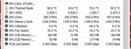

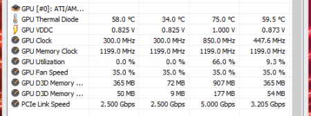

  5. guys, i did a repaste yesterday, since i had high temps when playing games (once 88°C). got better now but still have kinda high idle temps on my gpu. (like around 58°C). and i'm pretty sure repasting was done good, since i never had problem with that. it seem like this high temps came when i peplaced my vbios chip. could this have to do with being on 1.000v not undervolted? (have been on 0.975v before, because of throttling, but with this vbios 1.000v works fine) when checking sensors with hwinfo i saw mem clock being at 1199mhz when idling.. i think i remember it clocking down when not in 3D state etc.. isn't it like that? i have a 015.019 clevo vbios. no issue when playing etc except temps. here is a screen of the gpu part in hwinfo: ================================================================================ EDIT: i did some tests. i now saw, that when using a monitor with my display port, mem clock stays high at 1199mhz. when i disconnect the monitor, it goes back to 149mhz. is this normal? this is the reason for my idle temp to go up. without connected monitor thru DP, my idel temps are around 39°C.. ================================================================================
