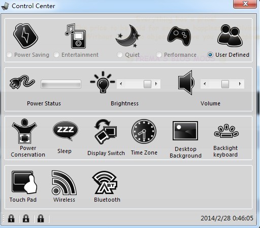

Hello Prema, thanks for your excellent work!
My p157sm(tf x611) was updated to your "P15xSM_33_31_PM1.1" version last Saturday, it has been working perfectly until yesterday I found the webcam has gone.
I've tried to reinstall my OS from Win8 to Win8.1, and restore the bios to default settings but it didn't work.
The camera has been used several times after updated the bios, but it has been gone suddenly, I can't figure it out.
Could you please help me if with your pleasure.
Thanks again.
My p157sm(tf x611) was updated to your "P15xSM_33_31_PM1.1" version last Saturday, it has been working good until yesterday I found it has gone.
The camera has been used good after updated the bios, but it has been gone suddenly, I can't figure it out.
Thanks again.
Propably not BIOS related, but you could update to the latest version.
Make sure cam is enabled in latest Clevo Hotkey App.
HotKey App: ftp://ftp.clevo.com.tw/P1xxSM/OTHERS/Hotkey_W81.zip
I've tried to reinstall my OS to Win7, can't find the camera from the Device Manager.
If fn+F10 is pressed, the camera will be disabled but it still is shown in the Device Manager, but not disapeared.
I've the battery removed and tried, problem still exists.
The TF dosen't offer any BIOS and BIOS update tool, but I've backuped before, the backup is only a 4MB big file.
If I could restore the BIOS by a toolkit called "T_AMI_EFI_BIOS" or not? Is it safe to do so?
I've checked everything even the keyboard, and found no problems.
I am afraid it might be the only way to get the camera back now...
Sorry for my bad English, I just can't find my Webcam, it was disapeared from my computer now.

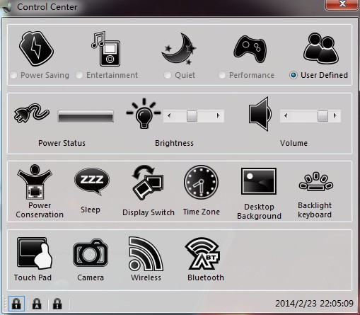

Here is the Screenshot which I've took earlier before...
Now it has no Camera option anymore.
Never flash any old backups! The risk of bricking is very high.
As you said, your webcam worked long after you flashed the BIOS, so it is probably a broken cable or cam.
As I said try to flash the v2 of the Mod if you want to iron out any NVRAM related issues.
