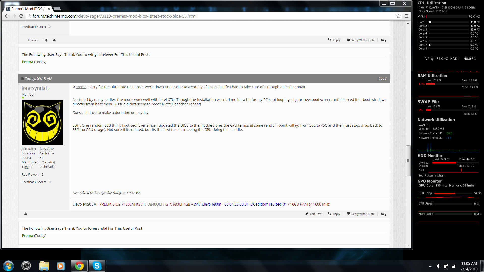

lonesyndal Posted July 14, 2013 Share Posted July 14, 2013 @Prema: Sorry for the ultra late response. Went down under due to a variety of issues in life I had to take care of. (Though all is fine now) As stated by many earlier, the mods work well with Intel XTU. Though the installation worried me for a bit for my PC kept looping at your new boot screen until I forced it to boot windows directly from boot menu. (Issue didn't seem to reoccur after another reboot) Guess I'll have to make a donation on payday. EDIT: One random odd thing I noticed. Ever since I updated the BIOS to the modded one, the GPU temps at some random point will go from 36C to 45C and then just stop, drop back to 36C (no GPU usage). Not sure if its related, but its the first time I'm seeing the GPU doing this on idle. (You'll see the monitor on the lower right) EDIT2: Chrome and Skype are my two most used items when idling. This was not an issue prior to the flash. Link to comment Share on other sites More sharing options...

Guest Posted July 14, 2013 Share Posted July 14, 2013 ...EDIT: One random odd thing I noticed. Ever since I updated the BIOS to the modded one, the GPU temps at some random point will go from 36C to 45C and then just stop, drop back to 36C (no GPU usage). Not sure if its related, but its the first time I'm seeing the GPU doing this on idle. (You'll see the monitor on the lower right) EDIT2: Chrome and Skype are my two most used items when idling. This was not an issue prior to the flash. People report a lot of stuff that appears to have changed after the update, while none of those things where actually changed by the Mod...guess it's just part of paying more attention than before... That rox prema !!! i used the regular version, and it works fine Another question : All fan of my p150em reach 100% use when i start a game (about 2 second after), how do i fix that ? i prefer toi get a "progressive" speed ? is that possible ? this comp rox but fans are really noisy If your fan kicks in 100% when just launching a game then you should re-paste the GPU, because it wouldn't do that before reaching almost 90c... Link to comment Share on other sites More sharing options...
Khenglish Posted July 14, 2013 Share Posted July 14, 2013 @Prema: Sorry for the ultra late response. Went down under due to a variety of issues in life I had to take care of. (Though all is fine now)As stated by many earlier, the mods work well with Intel XTU. Though the installation worried me for a bit for my PC kept looping at your new boot screen until I forced it to boot windows directly from boot menu. (Issue didn't seem to reoccur after another reboot)Guess I'll have to make a donation on payday.EDIT: One random odd thing I noticed. Ever since I updated the BIOS to the modded one, the GPU temps at some random point will go from 36C to 45C and then just stop, drop back to 36C (no GPU usage). Not sure if its related, but its the first time I'm seeing the GPU doing this on idle. (You'll see the monitor on the lower right)[ATTACH=CONFIG]8380[/ATTACH]EDIT2: Chrome and Skype are my two most used items when idling. This was not an issue prior to the flash.Merely monitoring GPU temps keeps the GPU on and using power, and thus generating heat. This causes it to slowly heat up and the fan to turn on. If you're not monitoring the gpu temps or doing anything with it, the fan will never turn on since the gpu is off and never heats up. Link to comment Share on other sites More sharing options...
lonesyndal Posted July 14, 2013 Share Posted July 14, 2013 I always check my temps and settings whenever I turn on the PC. The monitor is just right there for me to view at all times. I used to have an issue where the clock speeds would remain in 3D mode for no reason, and was fixed after some thorough testing with Afterburner and Origin/Steam. The monitor itself never really added much to temperatures (35C being lowest for 15 minutes when on). I had the machine since last year with little to no changes, the monitor and the usual files I have shown were present as well.EDIT: The problem does not occur when going mobile... (2 hours since I unplugged AC power). Maybe a power options issue, though that's odd when on balanced settings. Link to comment Share on other sites More sharing options...
Khenglish Posted July 14, 2013 Share Posted July 14, 2013 I always check my temps and settings whenever I turn on the PC. The monitor is just right there for me to view at all times. I used to have an issue where the clock speeds would remain in 3D mode for no reason, and was fixed after some thorough testing with Afterburner and Origin/Steam. The monitor itself never really added much to temperatures (35C being lowest for 15 minutes when on). I had the machine since last year with little to no changes, the monitor and the usual files I have shown were present as well.If you never ran the temp monitor, then turned it on after letting your laptop sit idle for a long time, you will find the GPU to be at room temp, which I assume is well below 35C. Running a GPU temp monitor will cut over an hour off of your battery life. Link to comment Share on other sites More sharing options...
