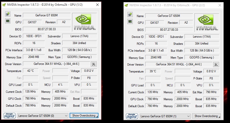

I'm using BIOS v2.04. I have SLI confugration. I'm going to be able to update my first GPU.. (After i paid 6 bucks to save time)
But how will i do for ultrabay GPU?
Because -svl7- says that " Flashing the ultra bay 650m - only for SLI users with BIOS v2.02: "
So what can i do?  Thanks for answers.
Don't worry, Ultrabay vBIOS is separate from primary GPU and will flash fine on v2.04.

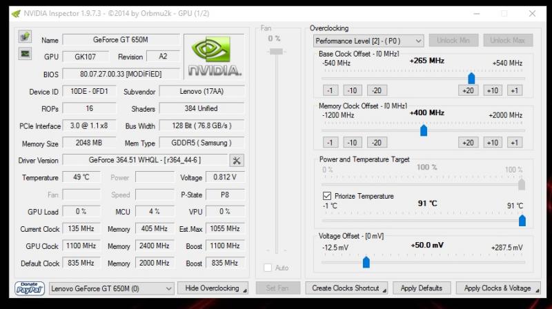

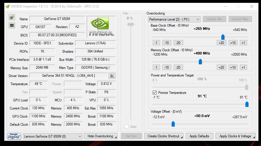

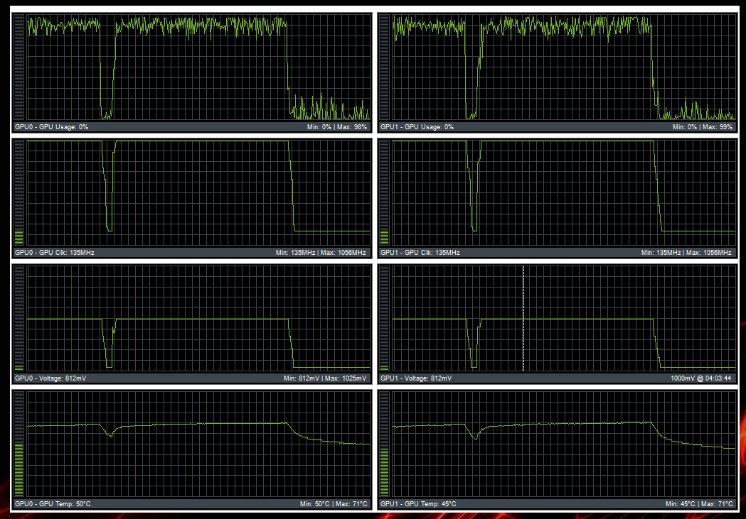

Hi again guys, i did it :rofl:
But now i have some problems with voltage control, before when i had stock bios, my GPU's voltage was 0.812 V and when i was playing games it was going to 1000-1025 mV.
Now i changed the voltage but it didnt effect, it seems like stock. Still going on games 1000-1025 mV, and my game (Need For Speed 2016) crashes after 5-6 minutes.
So what can i do? Thanks for replies.

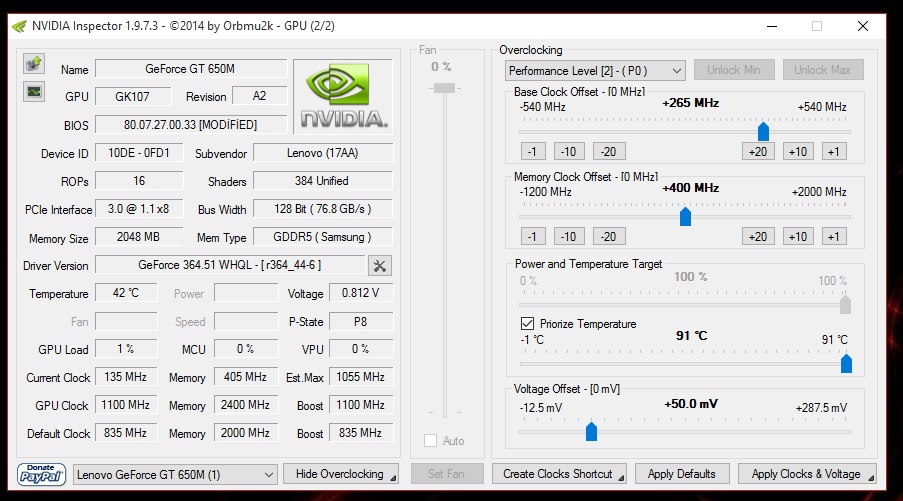

The actual 'zero' for voltage offset is at +112.5 mV. So +125 mV adds 12.5 mV to stock, +137.5 mV adds 25 mV, etc.
Oh thanks for reply -octiceps- :sorcerer:
I will try that, and let you know how it was going :frantics:

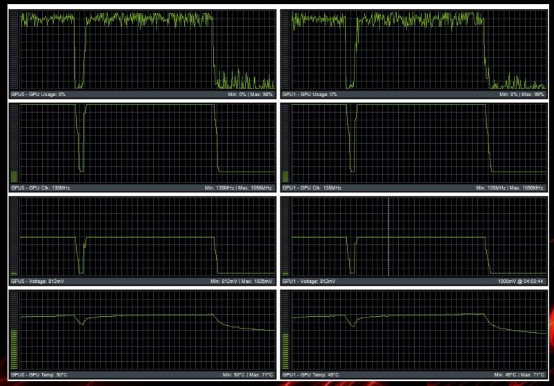

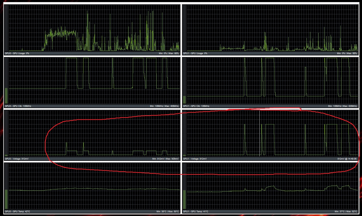

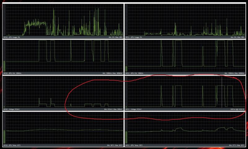

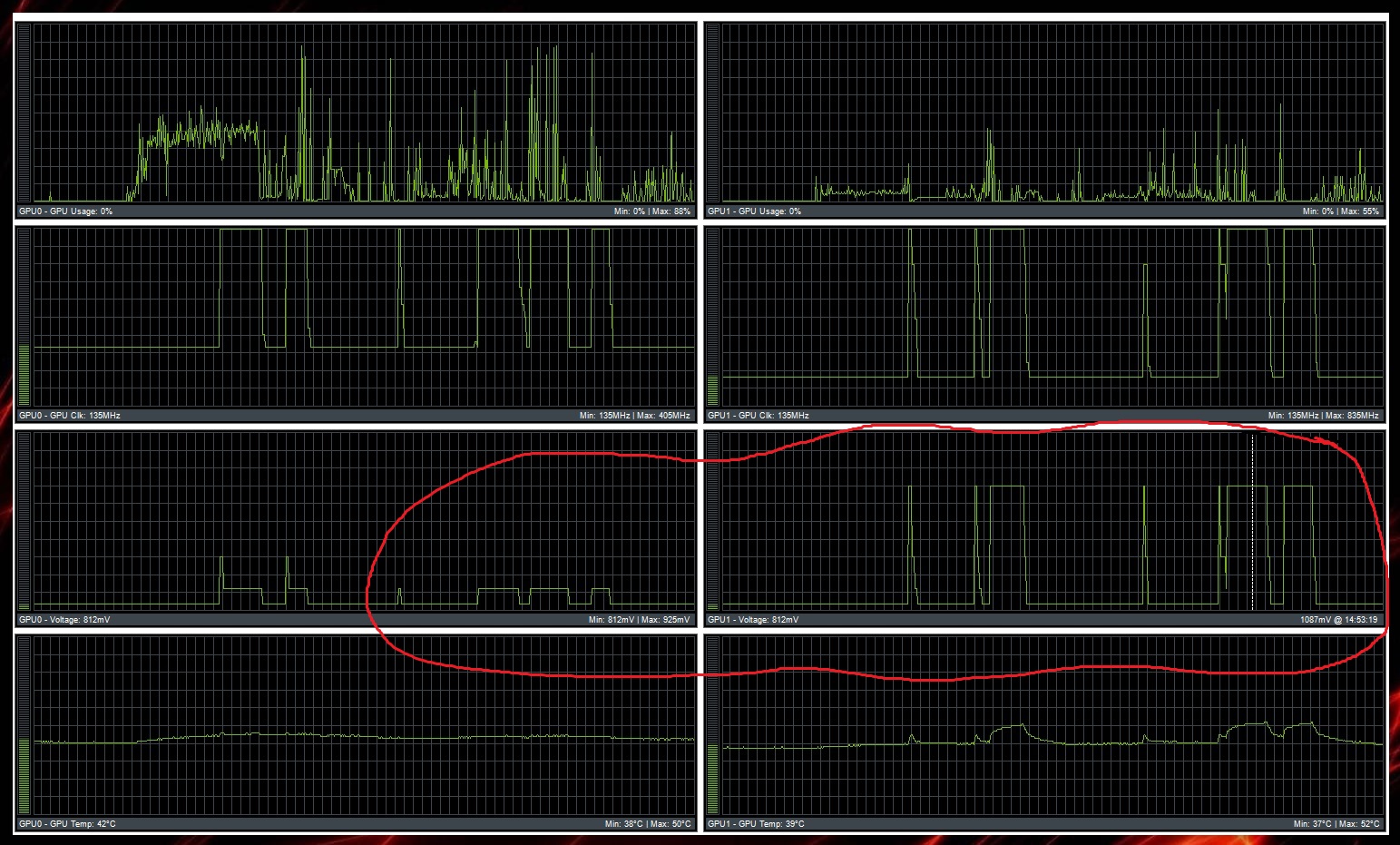

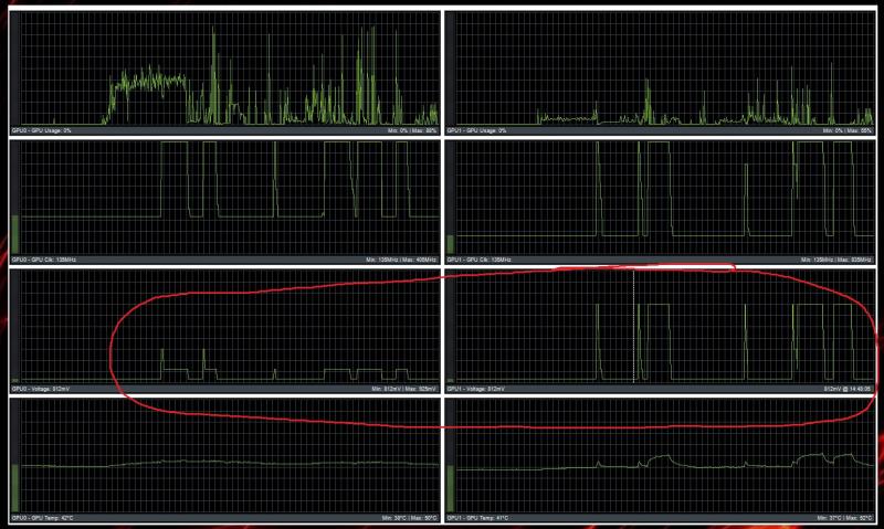

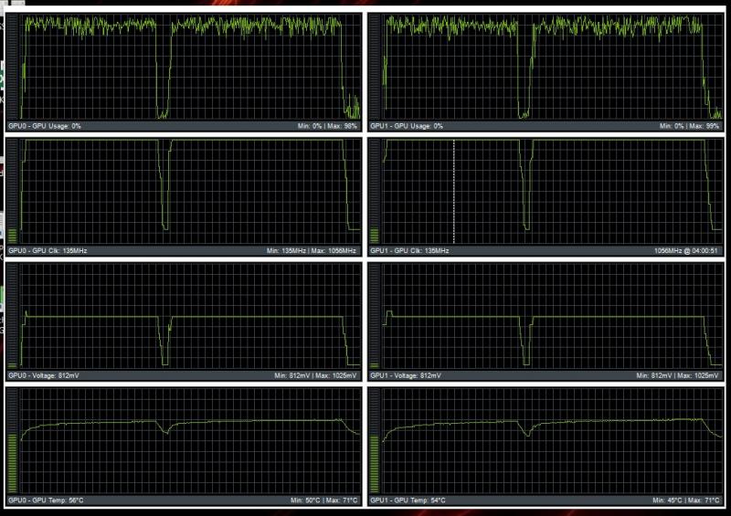

Edit : Game still crashing after 5-6 minutes. Dxdiag error says that graphic card removed or undetected.. :too_sad2:
And also check the picture, there are some drops after i open the game ; voltage drops from 1050 mV to 0.812 mV than its going again to 1000 mV than 1050 mV..

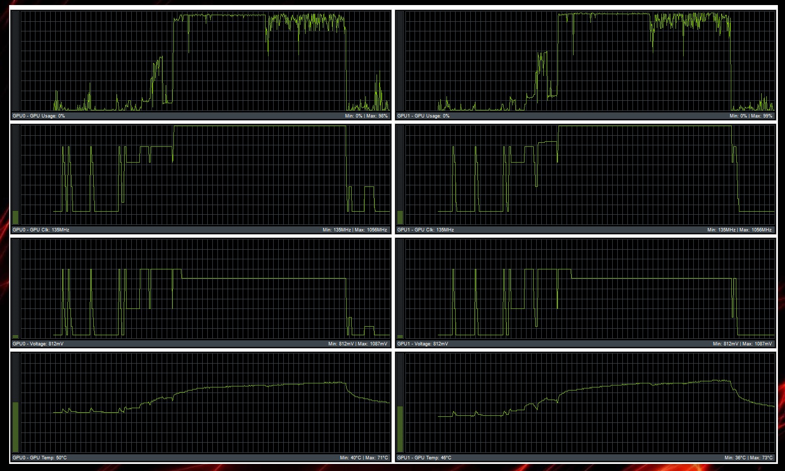

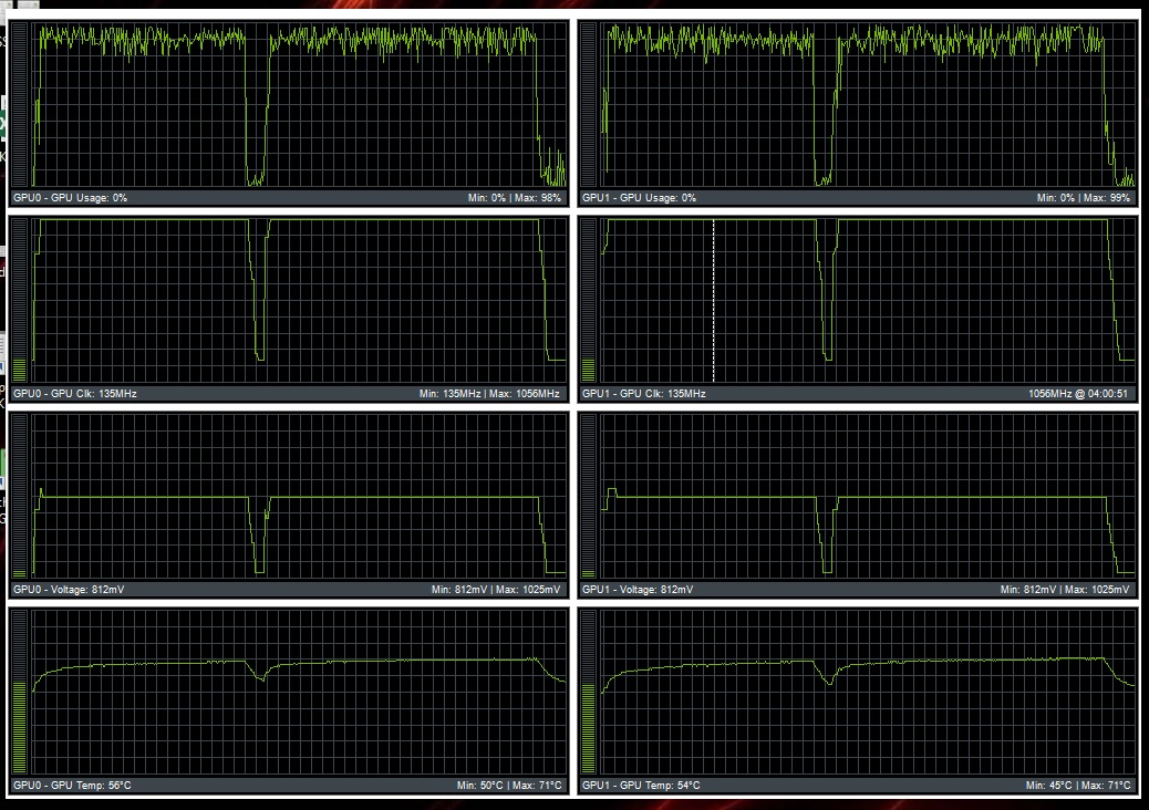

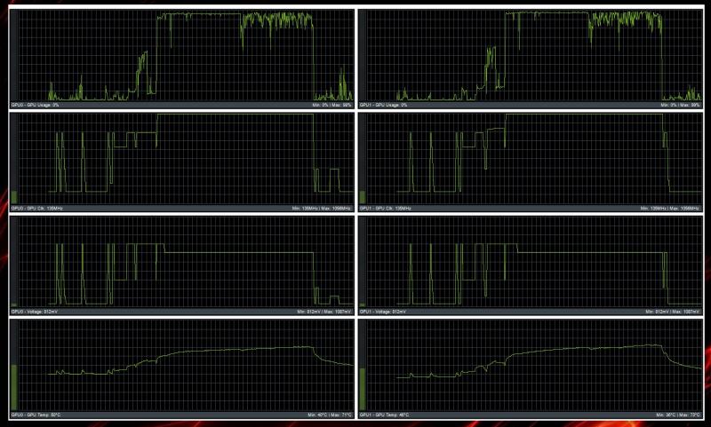

If it doesn't happen at stock, then the OC is unstable.
7 hours ago, CanTOKER said:
For now, at desktop i just saw that kind of drops at Ultrabay GPU. Everything was OK, but my voltage's are not stable..
Check this out ;imageproxy.php?img=&key=2ac7e5ac02b90b29
Looks OK to me. If adaptive power mode is selected in Nvidia driver, it will dynamically switch P states (hence frequency and voltage) depending on load. You can change it to prefer max perf if desired to prevent this.
You're using a voltage offset of +162.5 mV in Inspector, which is effectively a +50 mV overvolt, or 1.05 V. The reason max voltage is reported as 1.087 V is that the normal vBIOS behavior will drop it down to 1.05 V after GPU reaches ~60C. Same behavior is observed on stock voltage but it drops from 1.025 V to 1 V.

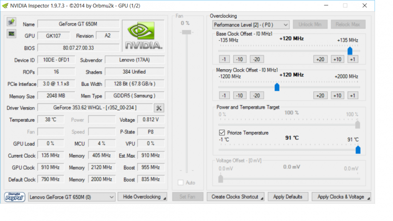

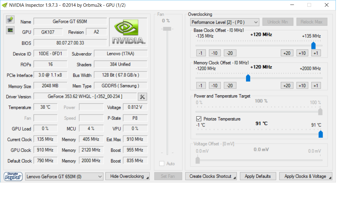

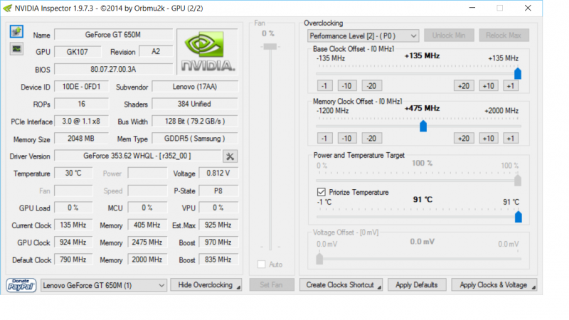

Okay I submitted the screenshots of Nvidia inspector for both of my cards. My setup is a Lenovo y500 with windows 10 64 bit. My bios is on version 2.04. I have an i7-3630QM, 8 gigs of DDR3.
I assumed the flashdrive didn't load the correct files because there were no files on it, unless when you create a boot drive the files are invisible.

Really thank you, i did it and it is working well for last 48 hours.
I'm running my gpu's with 1150/2400 with 1.075 V. Also the temperatures were not so high ( after 2-3 hours play GPU's 81-82 C max. ; processors 83 C max.)
Ok. Cool. See in the NvidiaInspector pic, for GPU 1, you should see the Bios ends in 33, you know that it's still un-modded.
