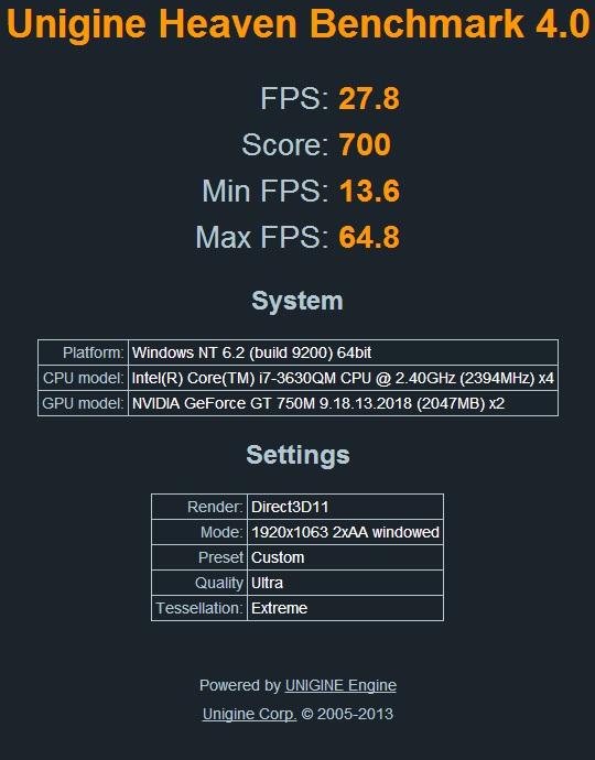

I have finally managed to break the 700 points record in Uningine Heaven 4.0 Benchmark.
701 points @ 1257 (+199MHz from 1058MHz) MHz core clock; 2795MHz (+295MHz from 2500MHz) VRAM clock. Max temp reached 88C on both GPU. Average about 82C.
Settings are maxed out except AA. 1920 x 1063 2x AA windowed mode. For some reason the latest Nvid driver screws up exclusive fullscreen. I am running 320.18, and I also have a 240W ac adapter.
This is 1256MHz core, 2780MHz VRAM. 700 points.

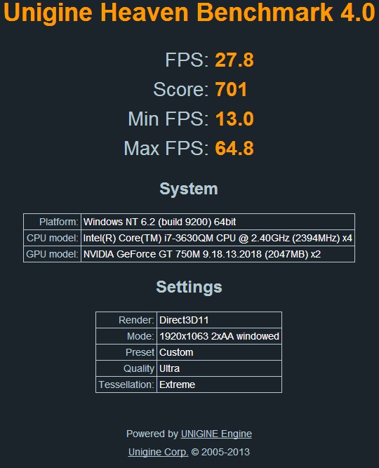

1257MHz core, 2795MHz VRAM. 701 points.
[ATTACH=CONFIG]7617[/ATTACH]
[ATTACH=CONFIG]7618[/ATTACH]
