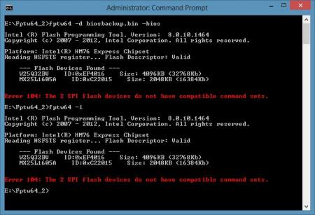

svl7 Posted February 24, 2013 Author Share Posted February 24, 2013 Run the fpt tool with -i as parameter and let me know what it says. Quote Link to comment Share on other sites More sharing options...
startear Posted February 24, 2013 Share Posted February 24, 2013 Appreciate your prompt reply, svl7 . The followings are the command response as well as screen shot: E:\Fptw64_2>fptw64 -d biosbackup.bin -biosIntel (R) Flash Programming Tool. Version: 8.0.10.1464Copyright (c) 2007 - 2012, Intel Corporation. All rights reserved.Platform: Intel(R) HM76 Express ChipsetReading HSFSTS register... Flash Descriptor: Valid --- Flash Devices Found --- W25Q32BV ID:0xEF4016 Size: 4096KB (32768Kb) MX25L1605A ID:0xC22015 Size: 2048KB (16384Kb)Error 104: The 2 SPI flash devices do not have compatible command sets.E:\Fptw64_2>fptw64 -iIntel (R) Flash Programming Tool. Version: 8.0.10.1464Copyright (c) 2007 - 2012, Intel Corporation. All rights reserved.Platform: Intel(R) HM76 Express ChipsetReading HSFSTS register... Flash Descriptor: Valid --- Flash Devices Found --- W25Q32BV ID:0xEF4016 Size: 4096KB (32768Kb) MX25L1605A ID:0xC22015 Size: 2048KB (16384Kb)Error 104: The 2 SPI flash devices do not have compatible command sets. Looking forward to your reply, thanks again! Quote Link to comment Share on other sites More sharing options...
svl7 Posted February 24, 2013 Author Share Posted February 24, 2013 Fix added to the first post. Replace the fparts file with the one provided in the fix archive. 1 Quote Link to comment Share on other sites More sharing options...
