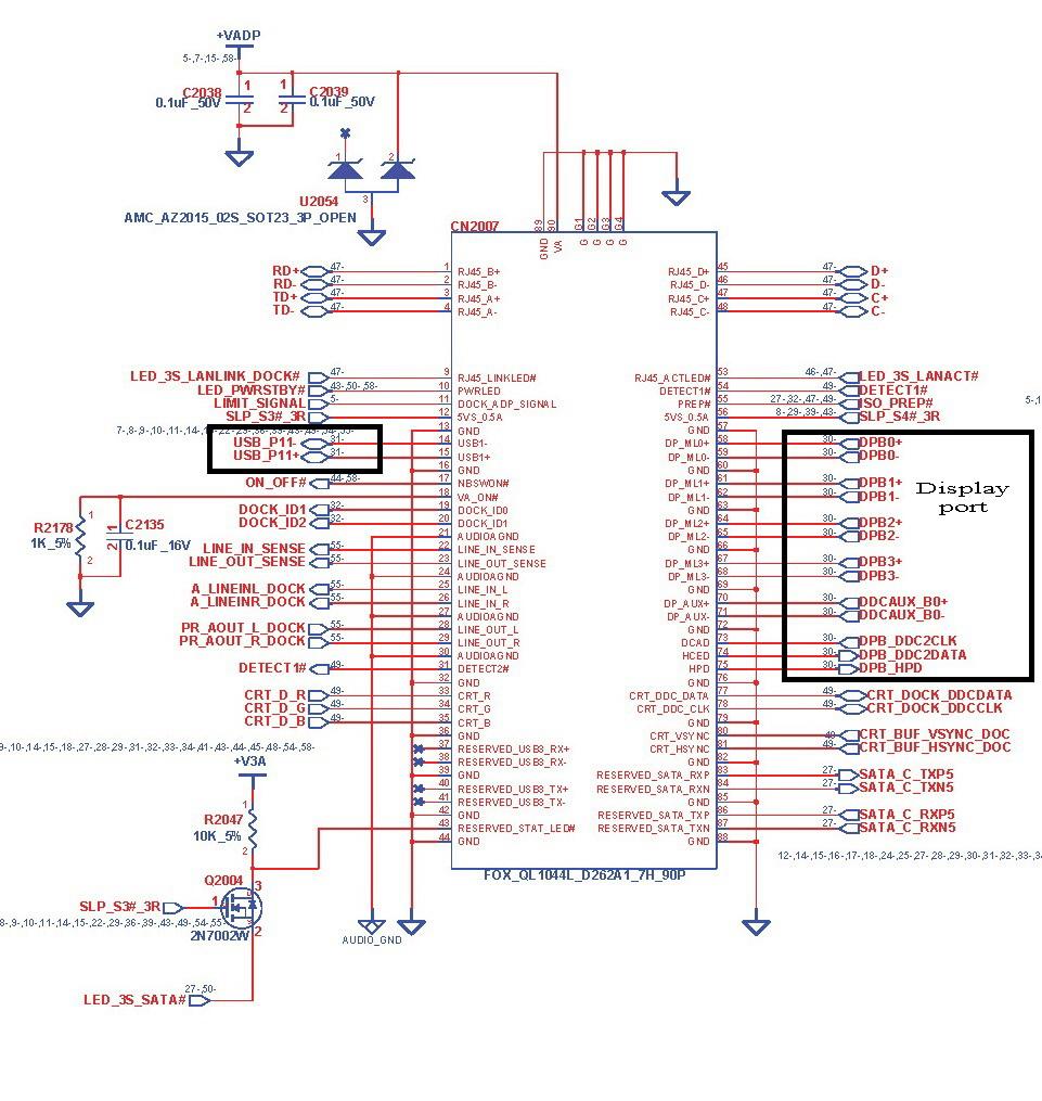

Hello everybody. Our friend @adrian_sa still keeps his secret as a partisan. I know how he changed the screen. Right now I'm on the Philippines and don't have tools to upgrade the screen. In one month I will go back to Russia and change the screen. An additional Display Port is in the Docking Station connector. I already used that connector for USB line for BlueTooth in Wi-Fi card.
Spoiler
