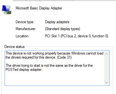

I would do - if I could get the damn thing to actually work. I keep getting Error 12, do I need to use the DIY setup 1.x? I have the GDC EXP and find that the computer will only boot with the switch to the left - the eGPU+adapter is working fine on the X220 though.
650Ti does just the same thing, and I tested both cards in my X220 and that works fine.
Ok so the EXP GDC works for the x220, so no problem there. Have you tested uninstalling the adapter in device manager, also uninstall (and delete) the expresscard port drivers for port2? This will give you a fresh install. Before doing all this, test to give the EC a light press and hold it to see that it's inserted all the way.
Tried that to no avail. I noticed when GPU was uninstalled, this was what was shown in device manager:
Seems to imply the eGPU isn't getting detected until after POST or something.
