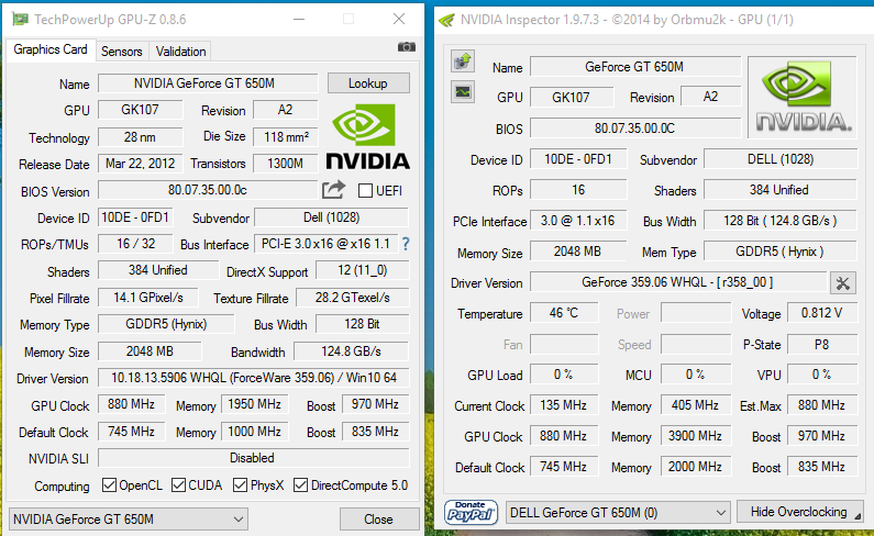

but there is a way , like take out battery use nvidia inspector, pstate o5 , it works fine at 1020 , 2600.... 1.012v , works with every game , but i want it unlock and work with battery .... :) thanks for reply .
You have make it work without battery ??? At the notes the 1st thing you have to do is put buttery how you tried it without battery and it work ?
it works , now i m at 1020 , 2780 :) jus when you oc dont turn off laptop ... or it will reset back to 745

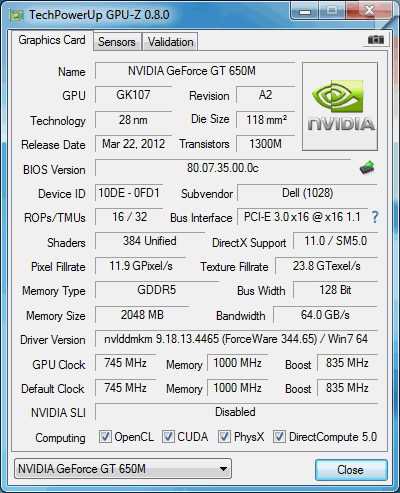

Hi guys. Have problem with boosting my gt 650m on my dell 7720. GPU clock stucked on 745 MHz and its impossible to increase it by nvidia inspector or msi afterburner. BIOS a16. Tell me is it possible to solve this problem and boost to 880 MHz? Thanks in advance
[ATTACH=CONFIG]13138[/ATTACH]
if the vbios allows for changing power and temp limit I would use EVGA Precision X app to set your gpu. I know Afterburner hasnt worked for volt control and such for my 880m's

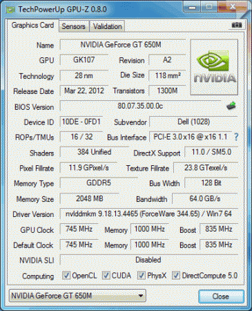

Hi. I know it's been a while since the laptop premiere, but I still own a Dell 7720 with 3610QM and GT 650M. Ever since I bought this laptop, I've struggled with gpu throttling but the A17 bios seems to have fixed it. However, my problem is that my GPU won't go past 745Mhz. Even when I overclock it to say 850Mhz, it still stays at 745Mhz no matter what. I've tried changing performance settings in power management as well as Nvidia control panel. Immediately after upgrading bios to A17 it worked for some time, but now the problem returned. I've tried looking for a solution in this topic, but reading through 15 pages of quite lenghty posts is kinda hard. Do you have any solution to get my gpu go past 745Mhz clock? Best regards.
