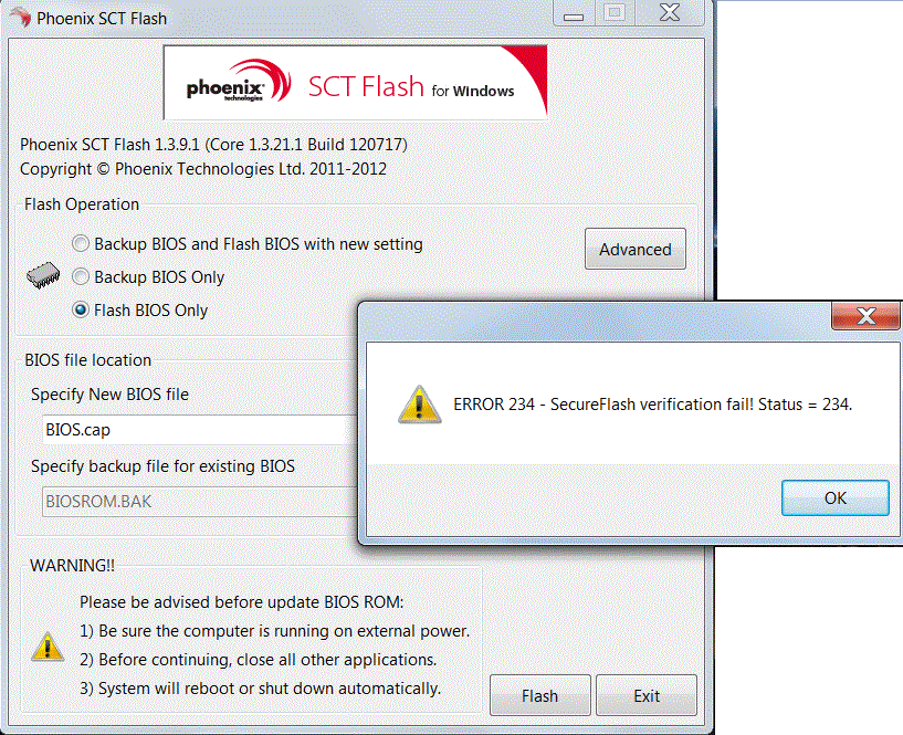

  14. Yes, and got the same error. Please refer to attached image.
  15. Seems that Dell signs it's bios with some signature. svl7 do you know how to come over this (if I'm right)?)
