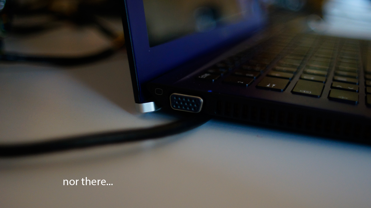

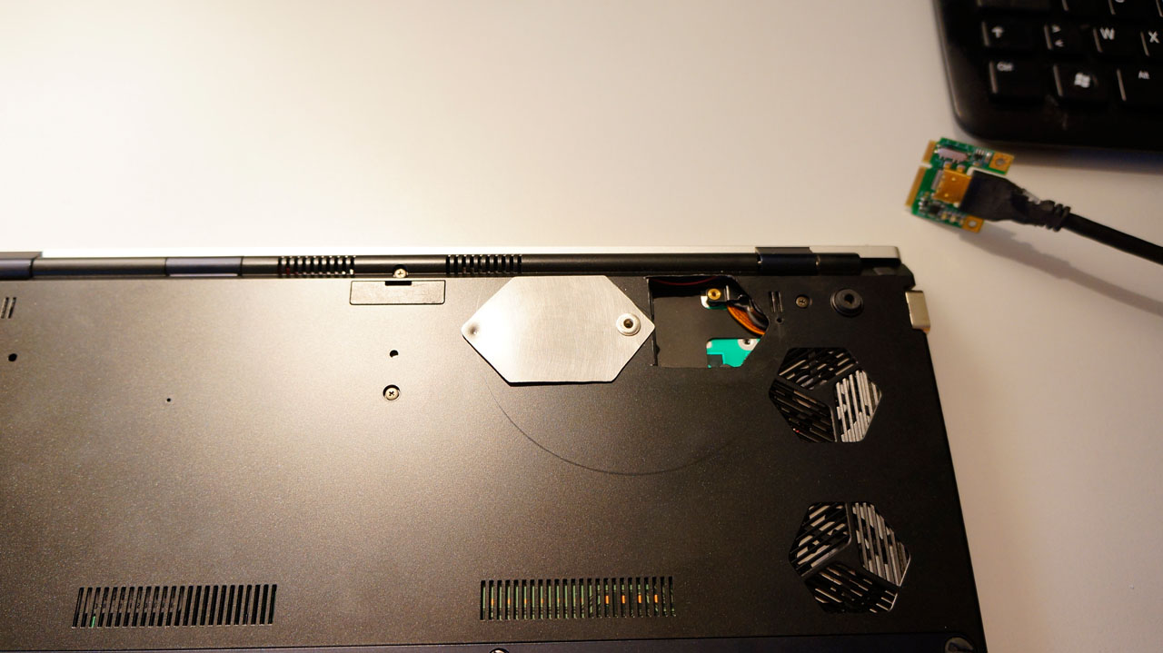

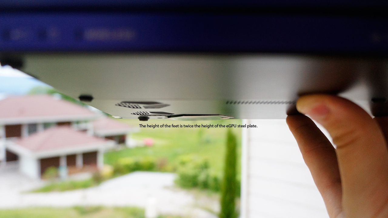

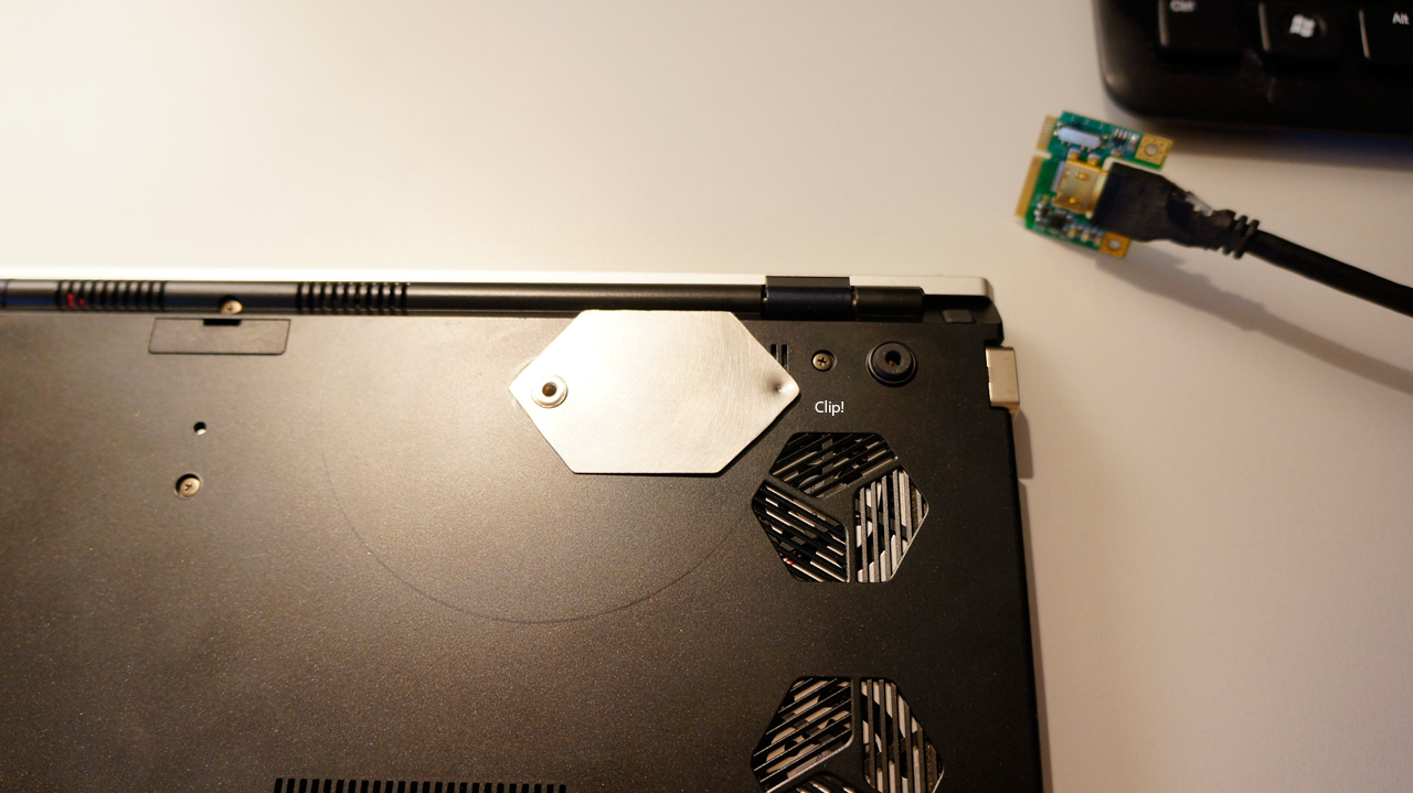

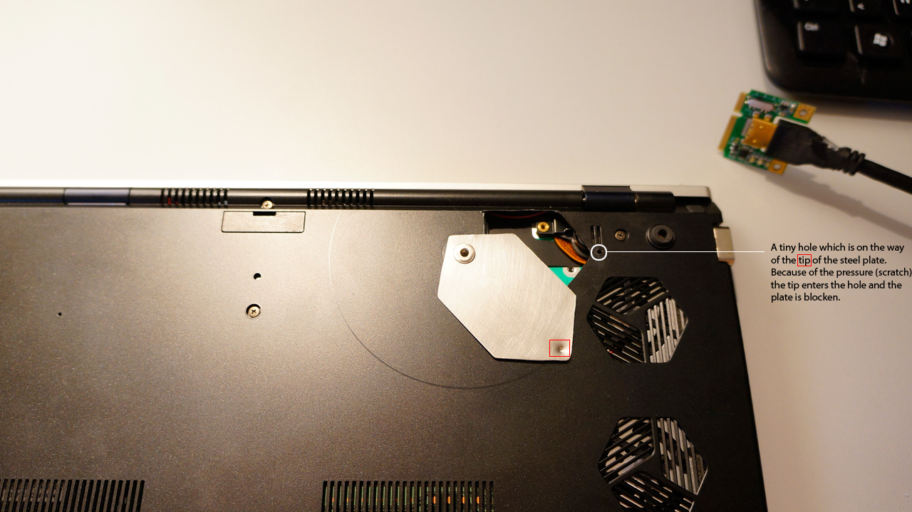

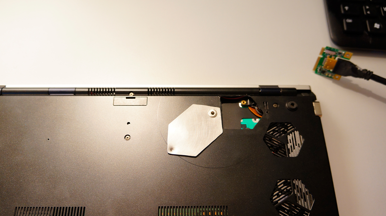

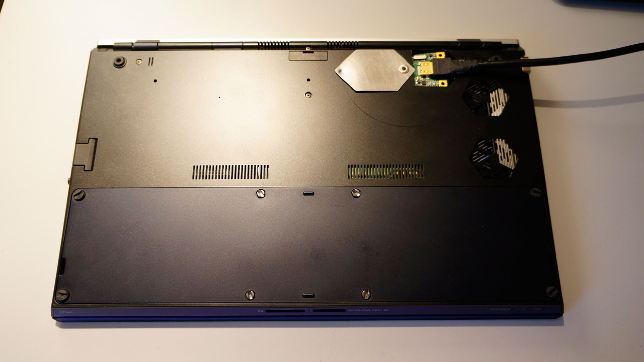

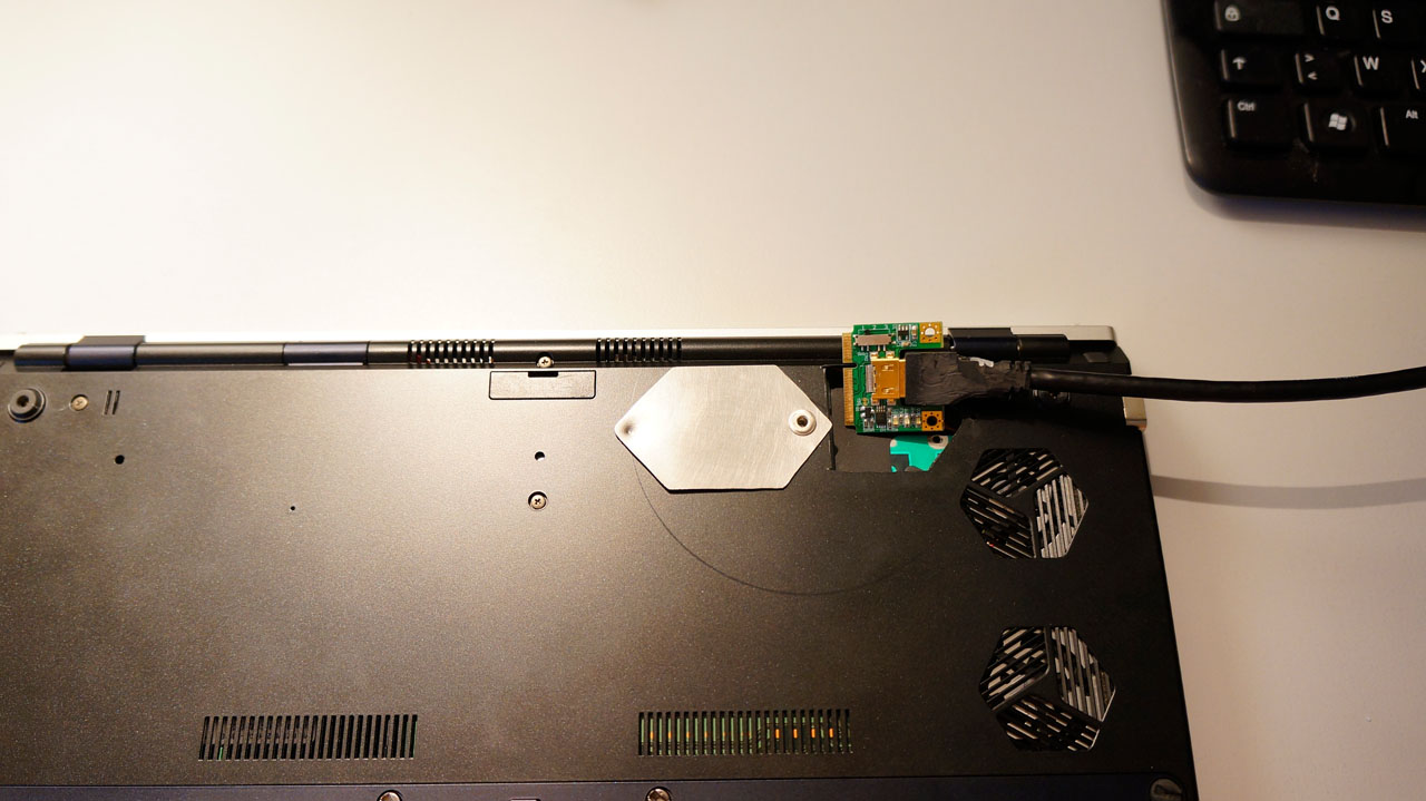

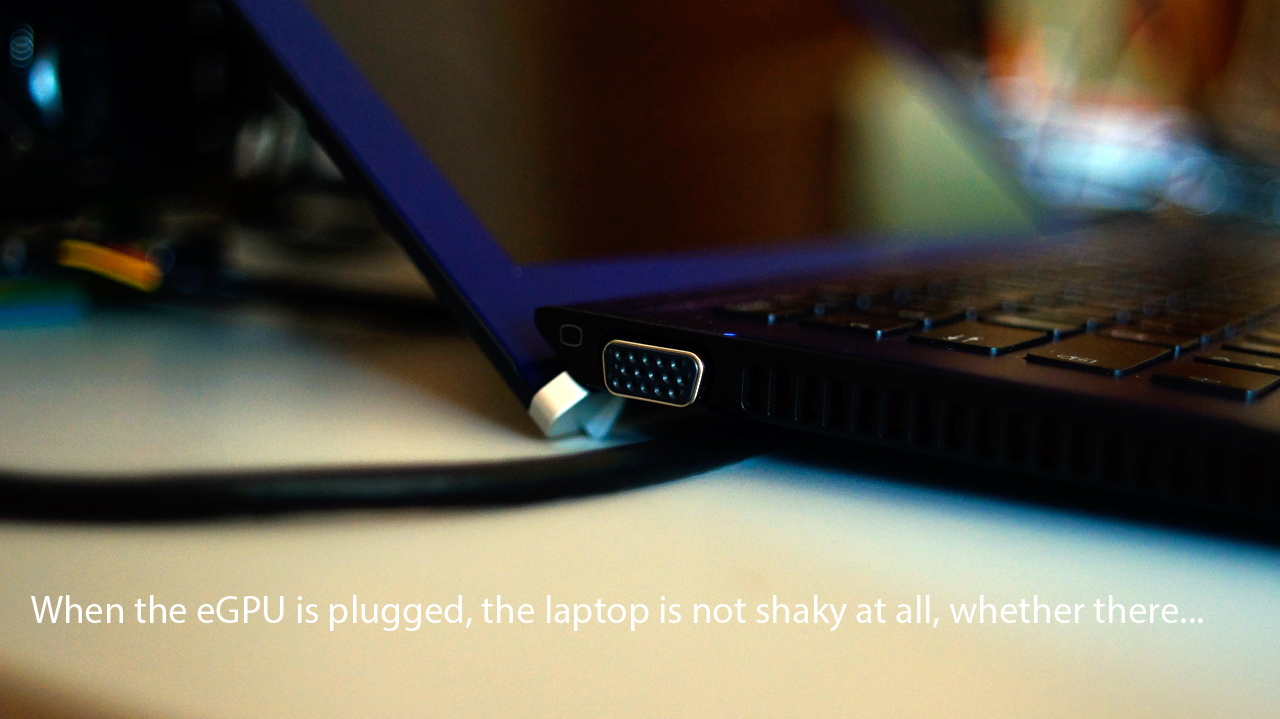

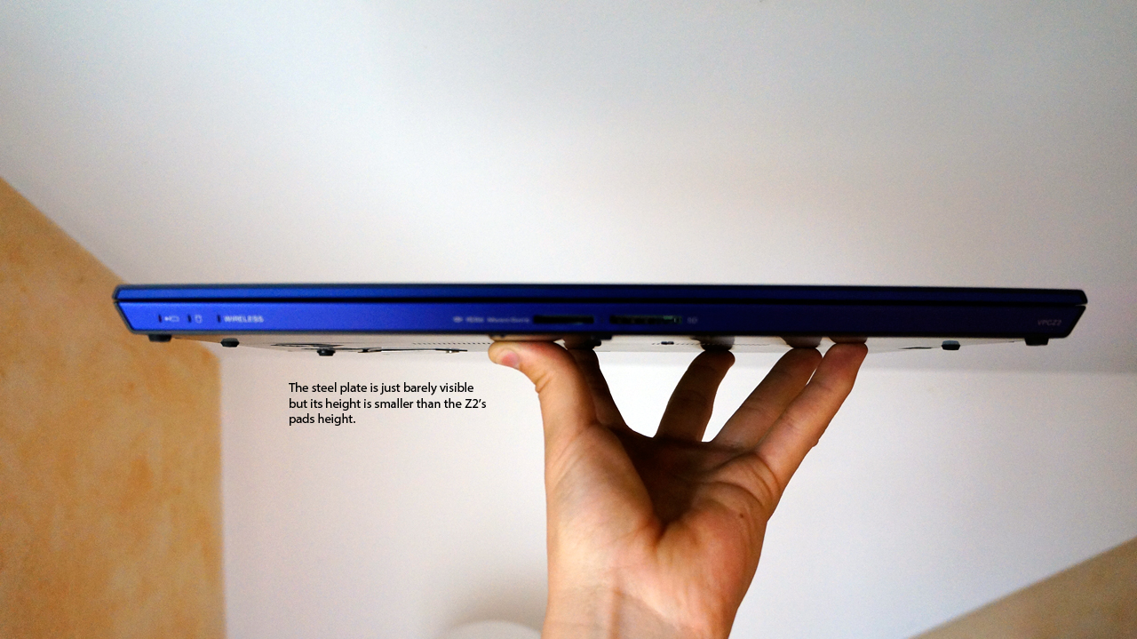

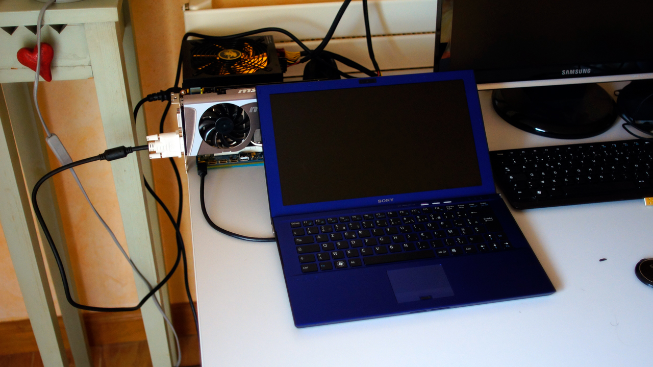

Pictures of my Z21 eGPU setup (Click the images for larger view)
Prepare your Z for an eGPU :
STEP 1 : Get the necessary tools
- Spudgers
- WLAN
- A new bottom plate (optional but highly recommended) blue/black : N/A, carbon : N/A, carbon glossy : N/A, gold : Link
- HWtools's PE4L-PM060A
- Soldering iron
- Cutter
- Drill
- Steel/aluminium 0.5mm thin sheet
  • Thumbs Up 8

Have you tested Battlefield 4 yet? I still have my SVZ, and have been tempted to get off my ass and finally do this.
I know he tried the beta, and it seems to run really well, like 60 fps most of the time (vsync on) in 1680x1050 with ultra settings.
I'll add a picture for you to see exactly where to cut the backplate
(this is really the only way... don't try to do it without backplate for instance you'd break the Z if you open it without backplate.)

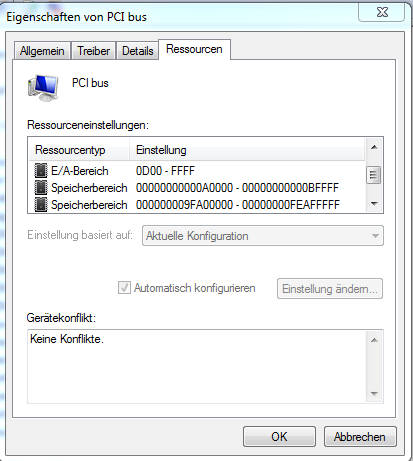

By the way Tech Inferno Fan, can you confirm that my tolud is lower than 3,5GB..?
Thanks
[ATTACH=CONFIG]12623[/ATTACH]
Thanks
Your TOLUD is 2.75GB. Plenty of room for an eGPU there.
