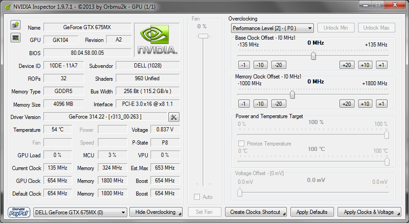

Hello fellow m18x r2 owners,
I just upgraded the laptop to a 675mx and seemingly it isn't fully recognized by the bios, which just sees it as "Nvidia GTX".
The P0 state isn't recognized by Nvidia Inspector either:
The card can go into P0 with AC power but stays at P5 when on battery power.
Also I can't switch to integrated graphics.
Will a modded bios solve any of this? Thanks
