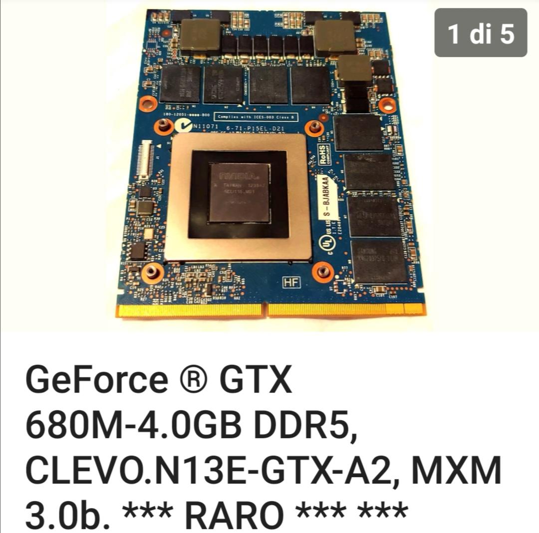

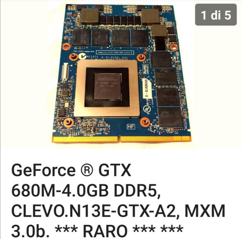

Hi Klem, I wanted to ask you if the clevo gtx 680m 4gb card is compatible with m17x r4 3d display, i need unlocked bios (i have unlocked a15 but not yet installed) or modified video drivers? Or will be recognized quietly s once placed in her quarters. Will win 10 also have its drivers? Thank you all
Edited by astrolopiteco
  • Bios Modder
Hi!
Unfortunately I don't know.
