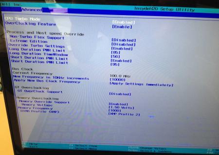

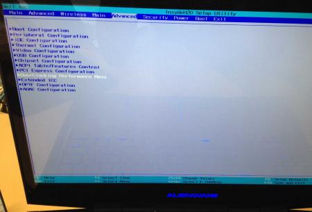

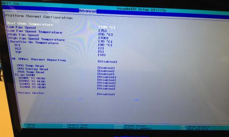

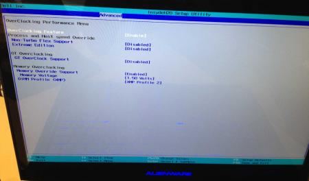

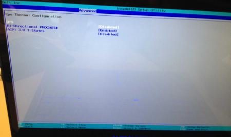

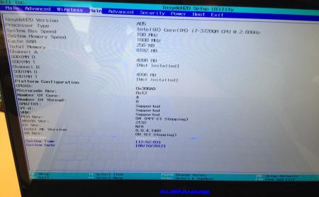

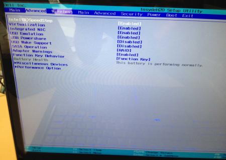

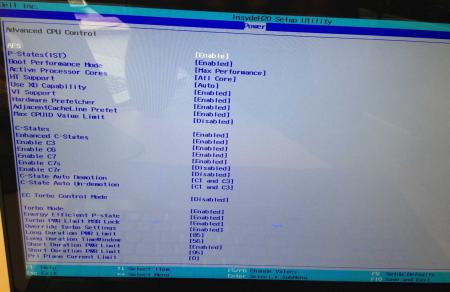

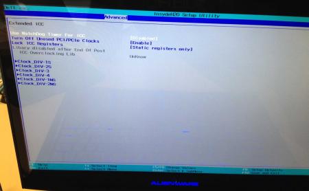

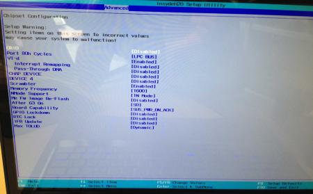

no worries @svl7! thanks for the awesome work dude! btw, sorry for the crappy pics, but i was fighting with either bad ass reflections of the window or a reflection of me in the screen...that's why the display in all the pictures of tilted... :D
  • Thumbs Up 4
Hahaha, don't worry man!! :D It's all readable, that's more than enough, cheers!!
Works like a charm, I would definitely not try and screw around at random with the options :)
