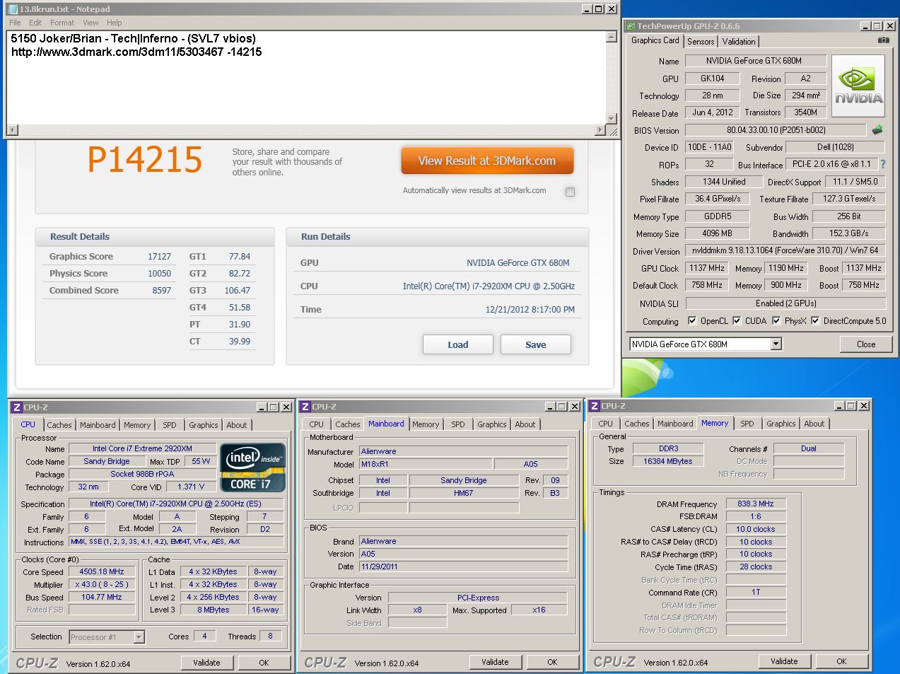

After much fiddling with my system and these Clevo cards + some great tips from my buddy @Mr. Fox I finally joined the 17k gpu and 14k overall club. Guess these crappy Clevo's were able to put on the big boy pants and join Dell: NVIDIA GeForce GTX 680M video card benchmark result - Intel Core i7-2920XM Processor,Alienware M18xR1 score: P14215 3DMarks Of course thanks goes to @svl7 since all of us would be pissed about NVIDIA gimping these cards had our resident vbios genius not gotten passed their bullshit. Also props to @johnksss for keeping us excited enough to continue the chase.

Wouldn't matter too much since Clevio BIOS is severely limited and doesn't let you edit any features that are needed for overclocking. P150EM also lacks the ability to use Intel XTU.
