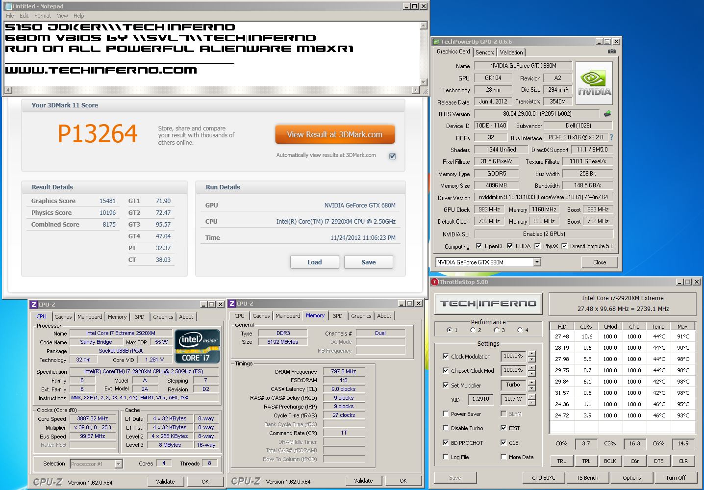

I'd stick with Afterburner, all these programs are made by unwinder but Afterburner is the most popular one. Yeah I can hit 1 ghz on stock voltage with my cards and so far I have the highest GPU score of any notebook (and I did it using stock cooling). The P370em may not be able to fare as well with overclocking, it doesn't have as robust cooling as the M18x but you should be able to get some nice clocks. Just keep an eye on your temps.
